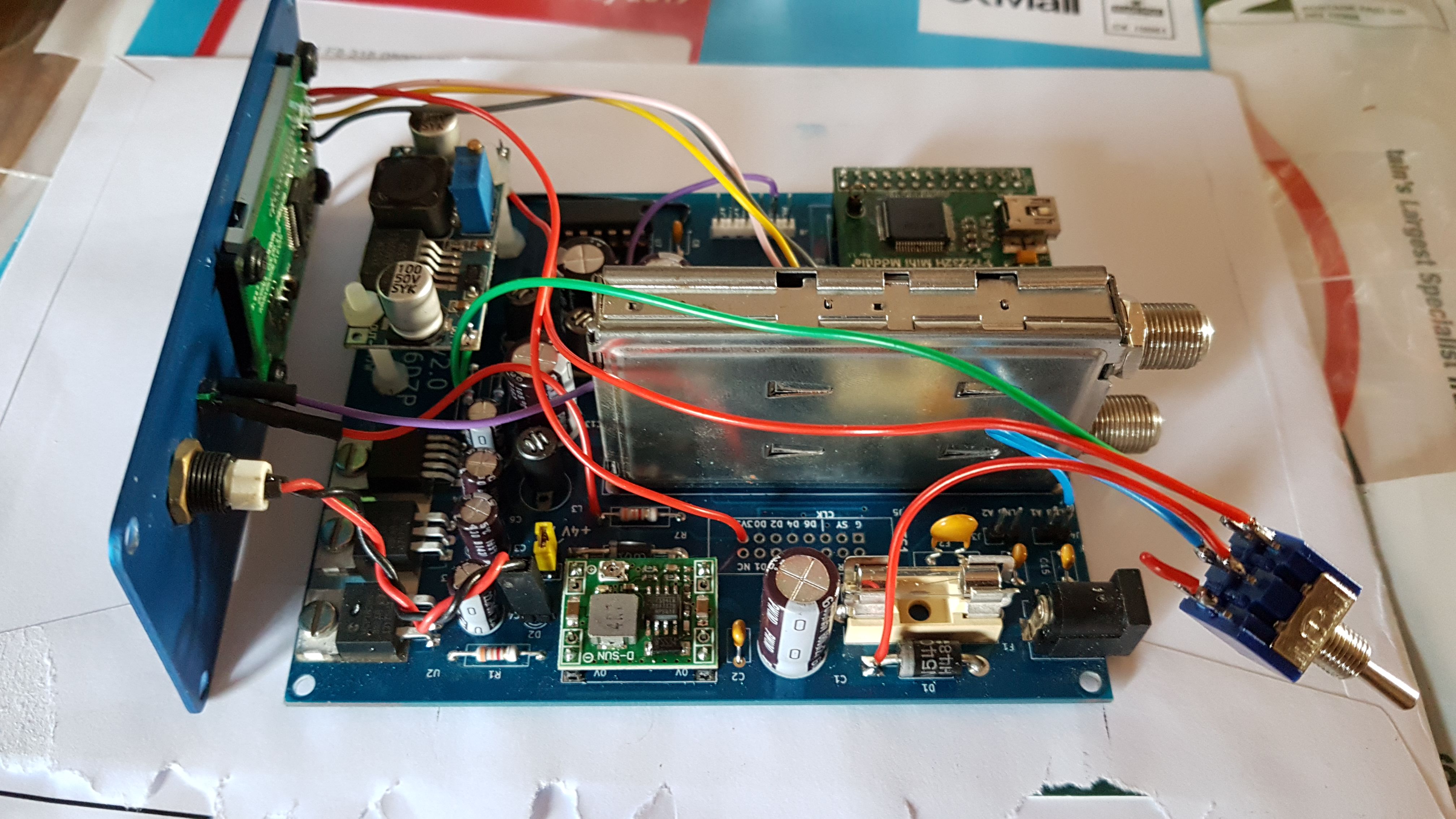

Hi all,
I just added an EBay buck converter and a centre off dpdt switch into my Minitiouner, the switch simply puts 12v or 18v to the pcb pin that feeds lnb power to the NIM.
73 Dave.

M5TXJ wrote:
Sun Apr 28, 2019 5:50 pm
Hi all,
73 Dave.
I've never had any luck with those Buck converters, they seem to cause a lot of QRM, especially on the 2m band.
M5TXJ
Posts: 347
Re: 18v h power
Post by M5TXJ » Sun Apr 28, 2019 7:17 pm
Don't need the buck converter on 2m, only for 18v, that's why it's on a centre off switch. Because the 12v feed is direct from the incoming supply it can also feed a preamp on 2m and 70cm, win win. I always add extra filtering to the converter too.

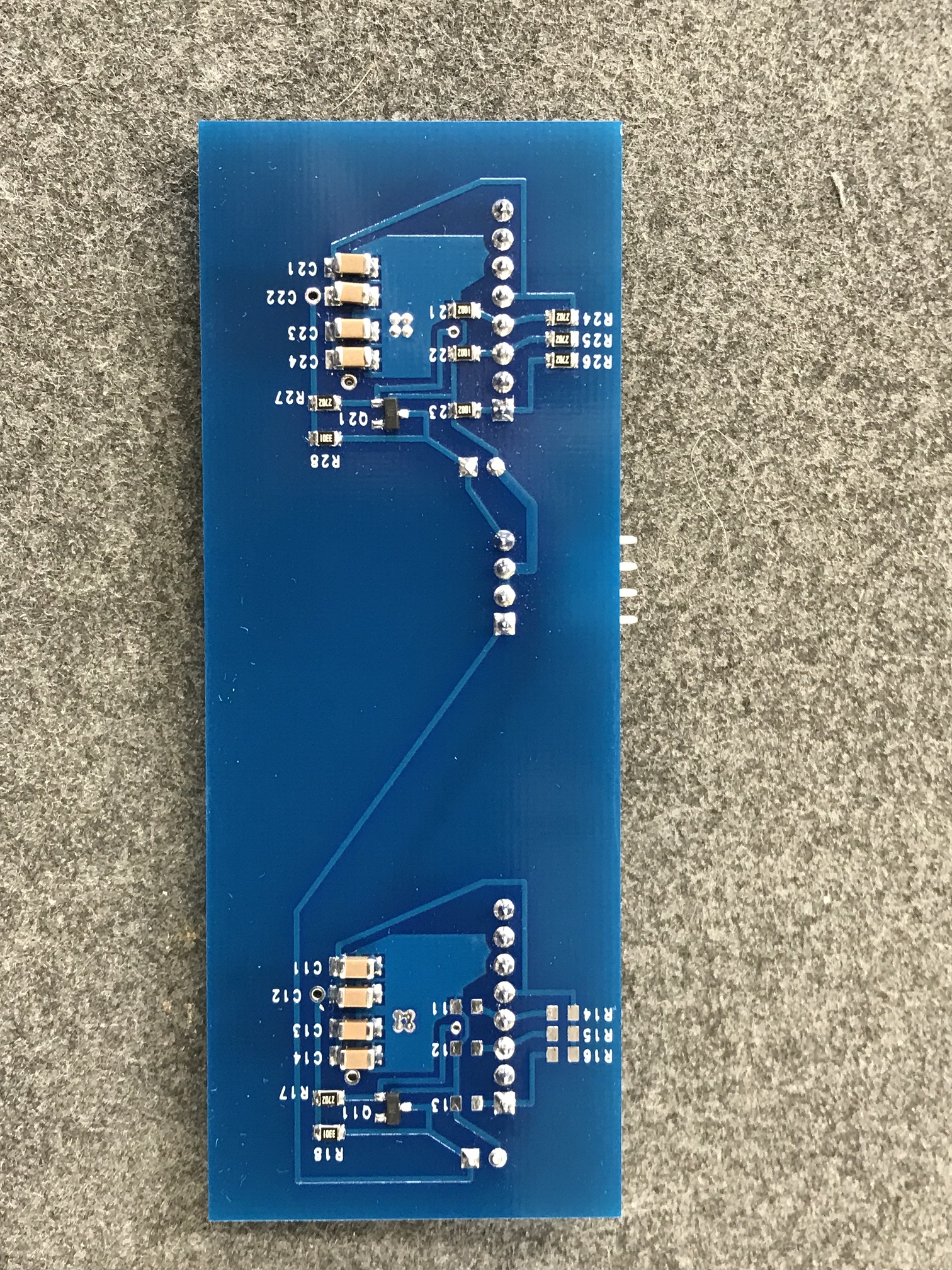

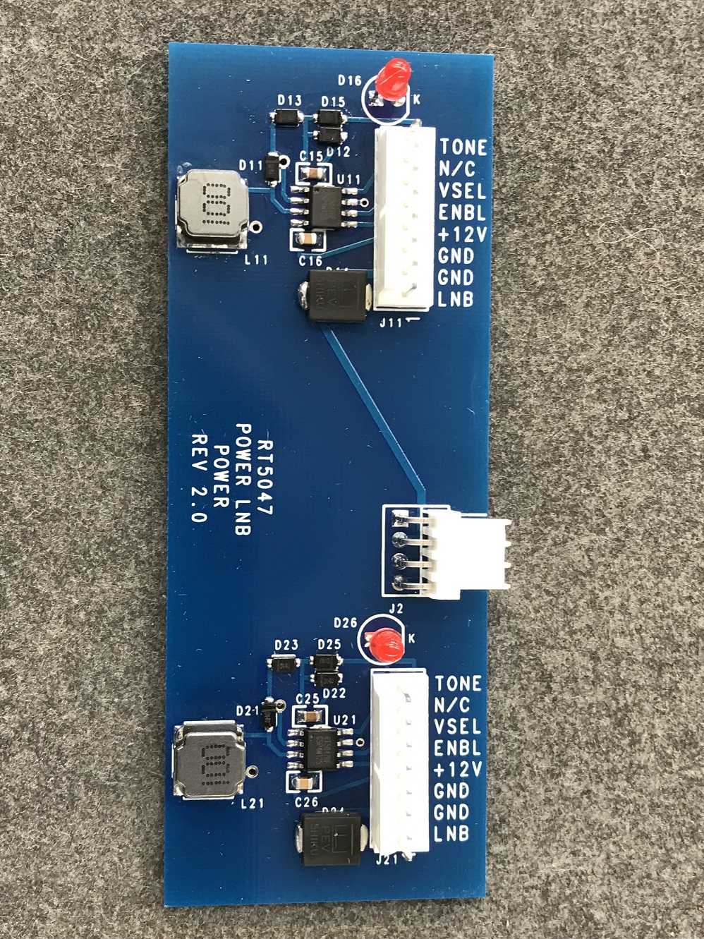

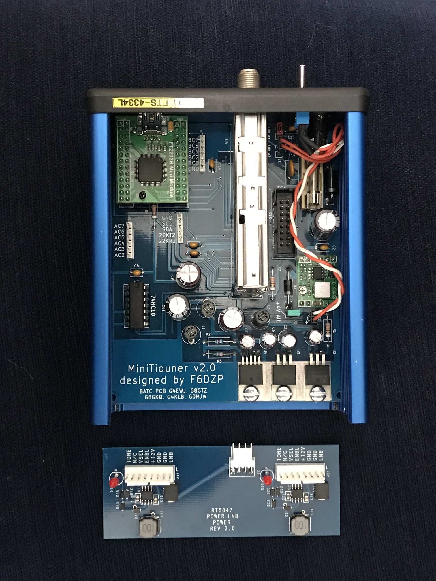

G4KLB
Posts: 252
Re: 18v h power
Post by G4KLB » Sat Jul 06, 2019 11:02 am
Working on a version that fits the standard V2 box ........ watch this space.
RT5047 T.jpg (911.61 KiB) Viewed 9890 times
RT5047 top.jpg (697.2 KiB) Viewed 9890 times
RT5047 btm.jpg (1.39 MiB) Viewed 9890 times
RT5047 i.jpg (845.72 KiB) Viewed 9890 times
This one is configured for testing the various options, more info to follow.
If all goes well should find the PCB in the BATC shop, some minor rework to make construction easier after testing is complete.

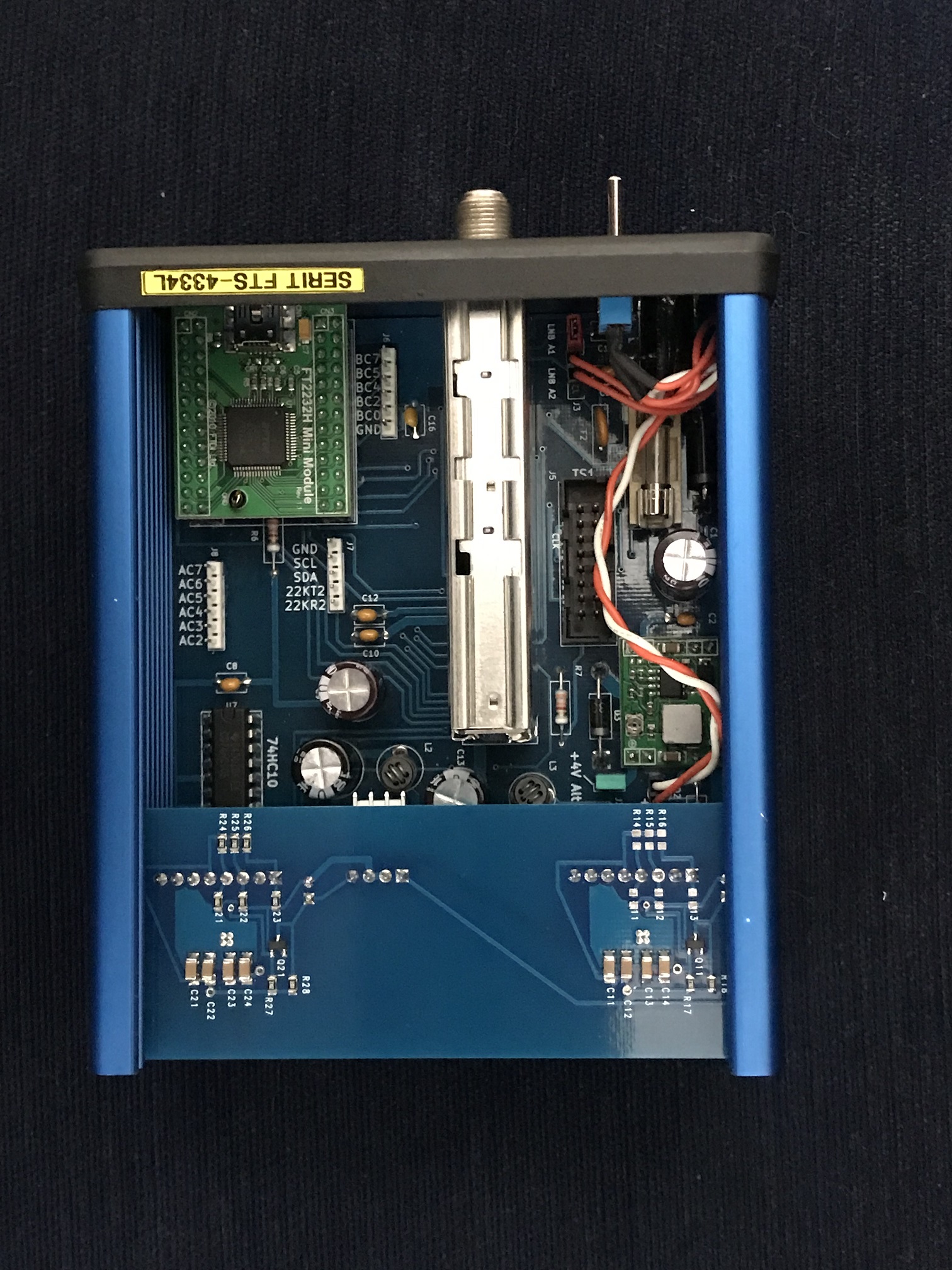

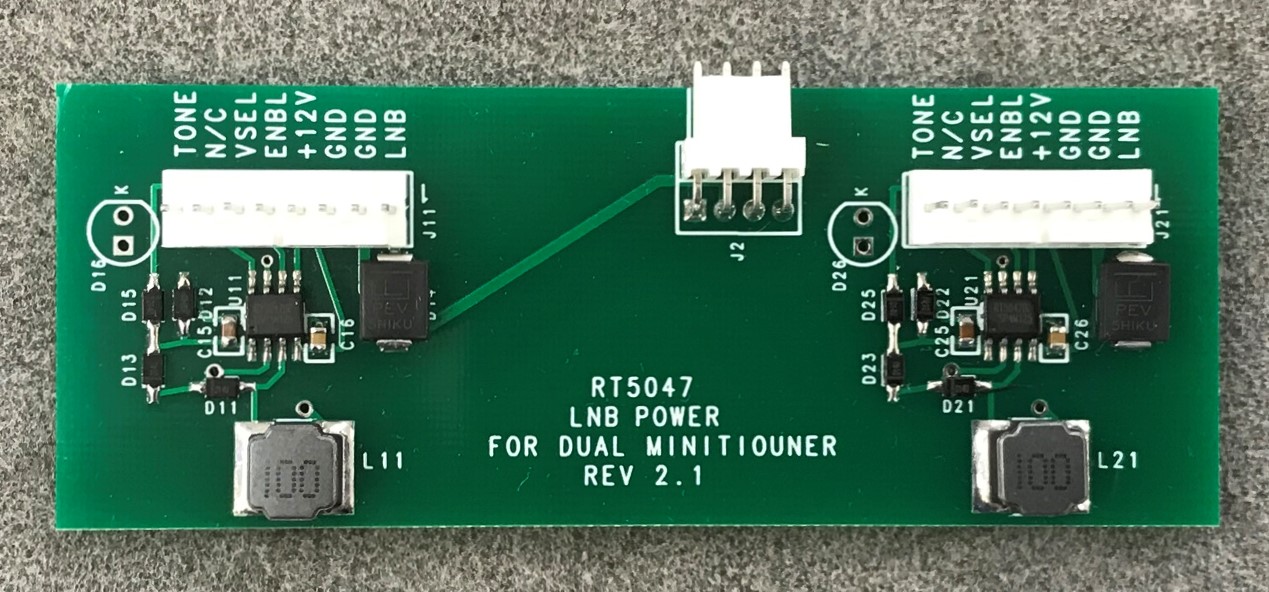

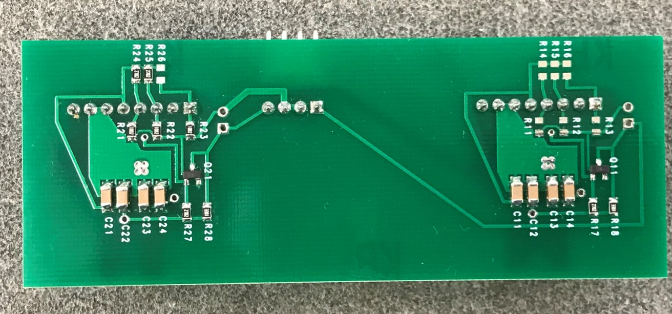

Posts: 252
Re: 18v h power
Post by G4KLB » Mon Jul 29, 2019 2:43 pm
Almost ready with our version to fit the standard V2.0 case
(Someone forgot to specify blue boards on this prototype) :oops:
