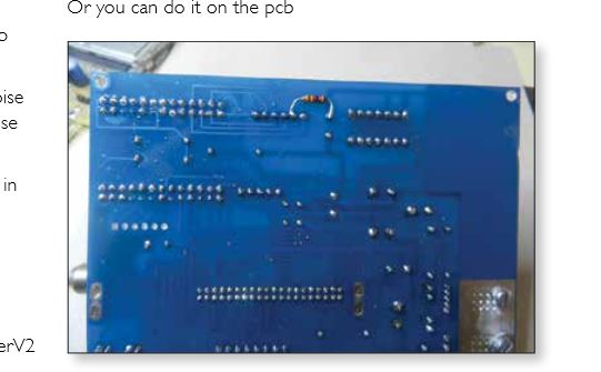

Can anyone help with the value of this resistor for the MiniTiouner V2 ?
- If you are using a MiniTiouner V1+extension or V2 ( BATC kit) with a NIM FTS4335 or FTS4334, you must add a resistor between the Ground and pin CN2-19.
Just dont want to put the wrong one on and blow it.
Steve G8XPZ

Post by g8vpg » Thu Jul 05, 2018 9:44 am
Steve,
I don't thinks its too critical, but I used 10k, as shown in the photograph.
73 Shaun.

Post by G8GKQ » Thu Jul 05, 2018 9:49 am
Anything between 4K7 and 10K should work.

Post by G8XPZ » Thu Jul 05, 2018 10:33 am
Thanks for the quick replies - 10K it is as have one in my component store.
Thanks Steve G8XPZ

Post by g4bao » Thu Jul 05, 2018 2:40 pm
Anyone tell me how I identify pin 19 now I've (finally) located CN2? Only 26 to choose from!

Post by G1BVI » Thu Jul 05, 2018 2:54 pm
It was all detailed in CQTV-259
see attachment showing location
