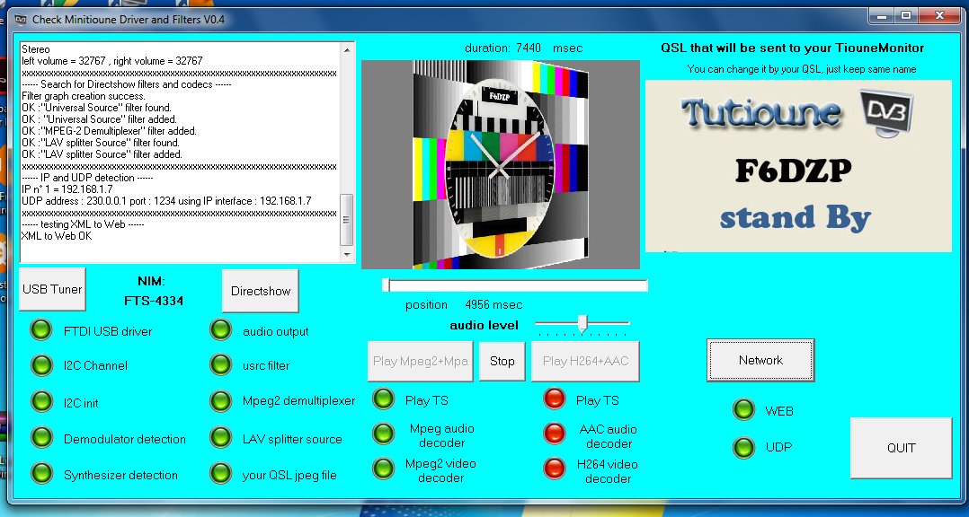

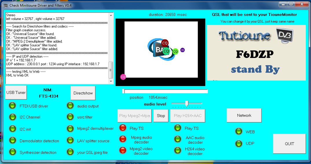

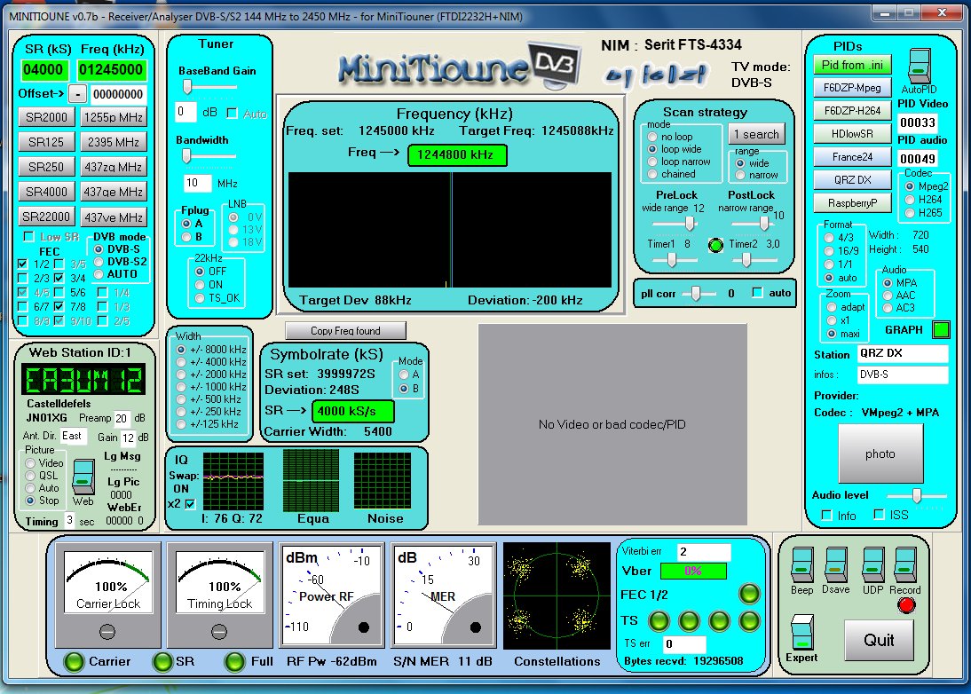

Apart from that in the VLC does not appear any image, I have also checked the web monitor and the transmission does not appear either.
I attach several screen shots in case you can deduce what happens.
I have 4 or 5 USB cables, I have tried them all, and always with the same result.
I have another computer with the Toutioune S2 3200 with the Tecnoctrend card and it gives me a perfect image, so I guess the TX works correctly ..
The truth, I do not know what else to do.
Just wish you could think of something to get out of the problem.

A fact that I forgot
If I connect the "AutoPid", after a few seconds it automatically disconnects and goes to "PID from INI",

You are clearly receiving a transport stream - it might be corrupted but I can see some data is arriving.Is that the saved TS file? Does it not play in VLC? Can you look at it with Notepad+ and see real data or just all zeros. My data doesn't look anything like that, its binary data. What is confusing me is there seems to be a valid PID received.

I am puzzled you are getting PID data but no image data. My TS file is binary, not ASCII like you have posted, which is also unexpected.
