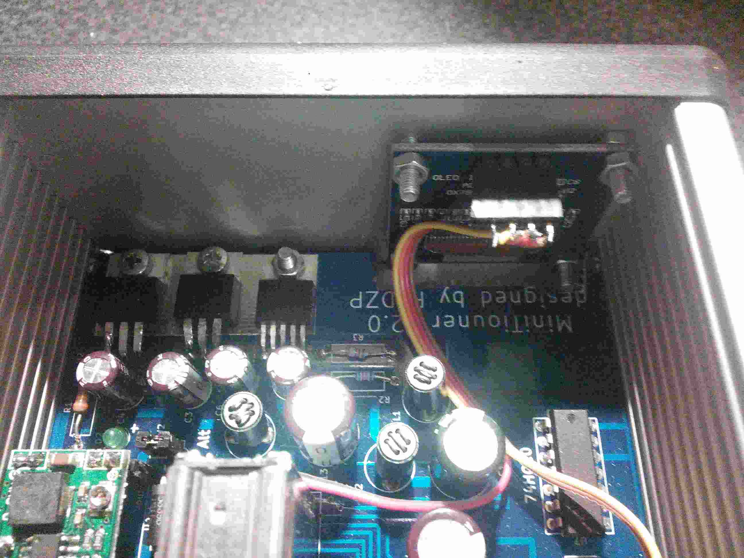

Think carefully when mounting OLED Display for Minitiouner V2 with FTS4334L
Think very carefully when mounting the OLED display on the front panel of the recommended box. The module needs to be mounted as high as possible on the front panel distancing it from the PCB. I put mine centralish, because it looked prettier. It would not mount on the RHS as the regulators got in the way. So i flipped over the front panel and tried to mount it on the LHS, but the PCB got in the way. In the end i nibbled the pcb (the bit with the acknowledgements) to clear the module as shown below
The other thing I learnt, when reprogramming the usb module was , when you think you have reprogrammed the module in FT-PROG, exit the software, restart FT_PROG and reread the module to ensure it now identifies as a minitioune pro module. On my first attempt It did not change due to misinterpreting how FT_PROG worked

I should have mentioned this, I have also done the same. You need to put it as high as possible as Dave noted and avoid the regulators. This was never part of the design, but an alternative is to use the longer version of the same case design. Then there is plenty of room. There is a photo of mine earlier in the OLED thread, it could have done with being a little higher.
PS - it looks to me that if you were to rotate your panel 180 degrees and turn around the OLED to its not upside down, it would fit. Finally, be very careful with the mounting to not press on the glass, it will shatter very easily.

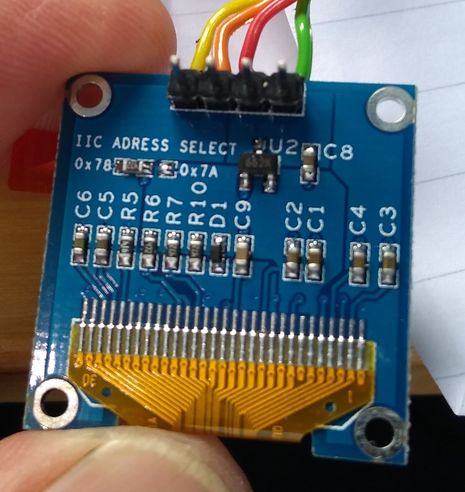

So I've got round to fitting one of these display modules now that MT v0.8 is installed and running. I've altered the config file as per the info in the PDF and saved it. (OLED=yes and digole=14 as its the small unit). As it picks up my callsign I assume that I've managed to correctly save the file
Nothing on the display, doesn't even light up. Tried a second unit (also new) same thing. I have Gnd, V+ (from J2) and SCL and SDA correctly connected. Do I need to change the address on the oled module or something? Its currently on the left hand bridge 0X78, the empty RHS address being 0X7A?
Don't believe two new modules, even from China, are duff. What am I missing?

Possible options - you need to change that address or perhaps you bought something different. What shape are the mounting holes?

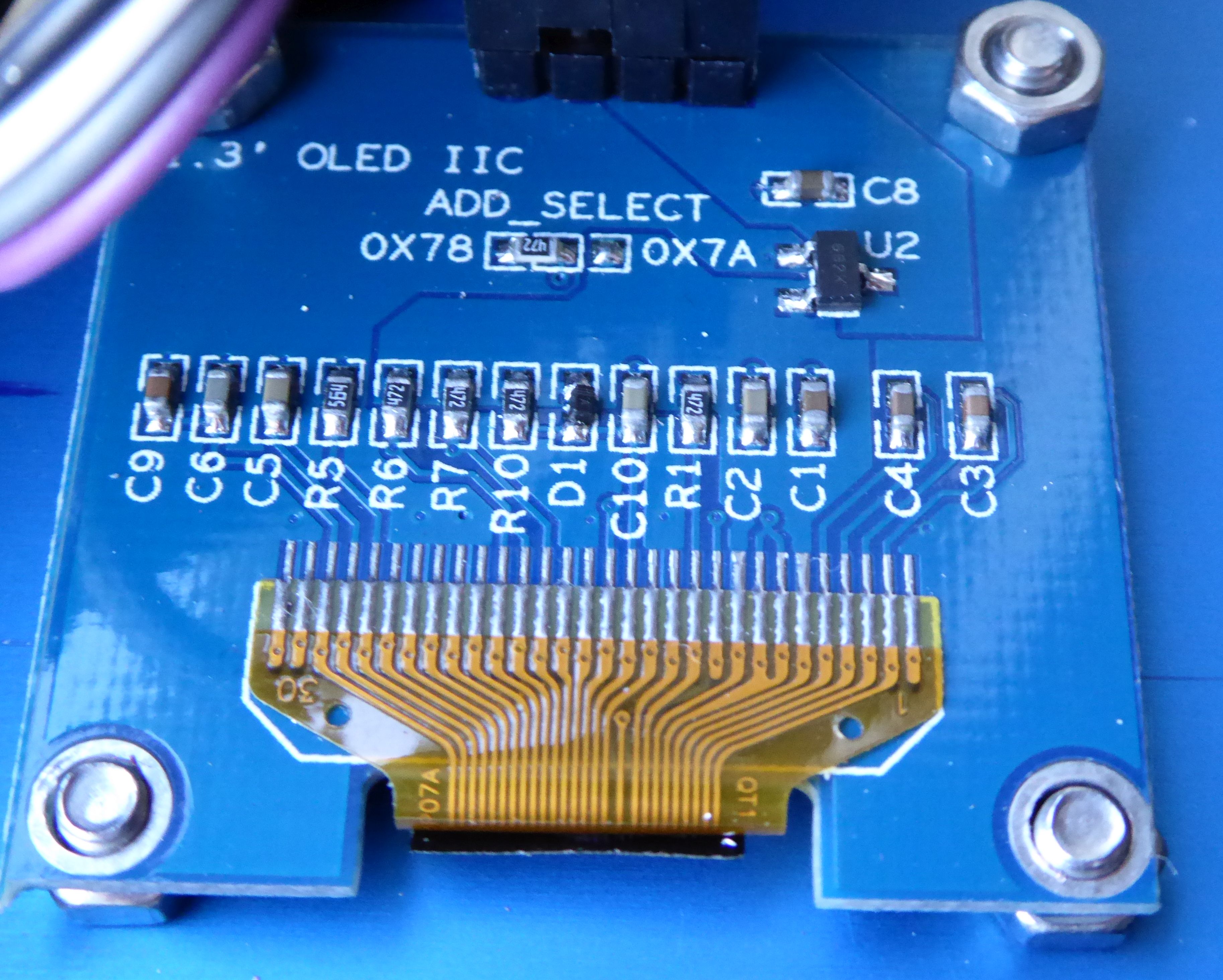

Hmm, well its identical to the unit shown in the second picture page 1 of this thread, blue pcb. All the units I have (4) have the same address set by a 4K7 sm resistor across the LHS address select terminals. I'd guess that the I2C address is buried in the main MT software.
Mystified....
Did a bit of web digging, suggest that 10K pull-ups should be used on one of the devices. Tried that (they may well already exist on the board thinking about it, for the other I2C devices) no change. Yet ALL the displays work on a 'stock' arduino display routine for this display.

*Update*, yes it is, both data lines alive and well as seen on my scope, but still no-show. shows the address resistor in the LHS top corner. Maybe that's it?

All seems OK. Suggest you try the other address. You must have checked the supply though you didn't say.radiogareth wrote: ↑Thu Aug 16, 2018 2:18 pm
*Update*, yes it is, both data lines alive and well as seen on my scope, but still no-show. 2018-08-16 15.59.41.jpg shows the address resistor in the LHS top corner. Maybe that's it?
