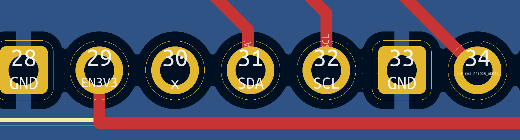

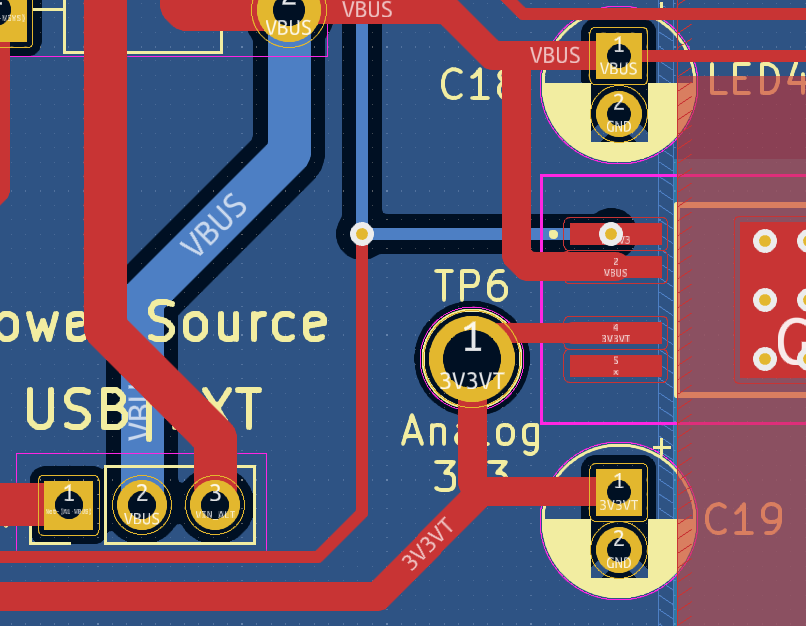

GPIO28 is available on the header, but I doubt it is as simple as bridging it to the GPIO22 pin if that is used in the W55RP20-EVB. The regulator enable signal is on pico pin 29. It meanders around the top side of the board and then goes through a via near TP6. Cutting the track that goes from pico pin 29 to that via may be the simplest way of modifying the board, then a jumper wire from pico pin 34 or GPIO header pin 8 to the enable line, which is available on regulator U4 or U6 pin 1. If you don't care about regulator control, you can simply bridge pins 1&2 on U6 or U4 after cutting the track.
Screenshot 2024-09-27 083841.png (99.7 KiB) Viewed 10401 times
However, it might be better to do this by modifying the pico. All that is required it to cut off the pin on pin 29 (or never fit it if you are soldering on the header yourself) and bridge from pin 29 to pin 34 on the back of the picotuner PCB.

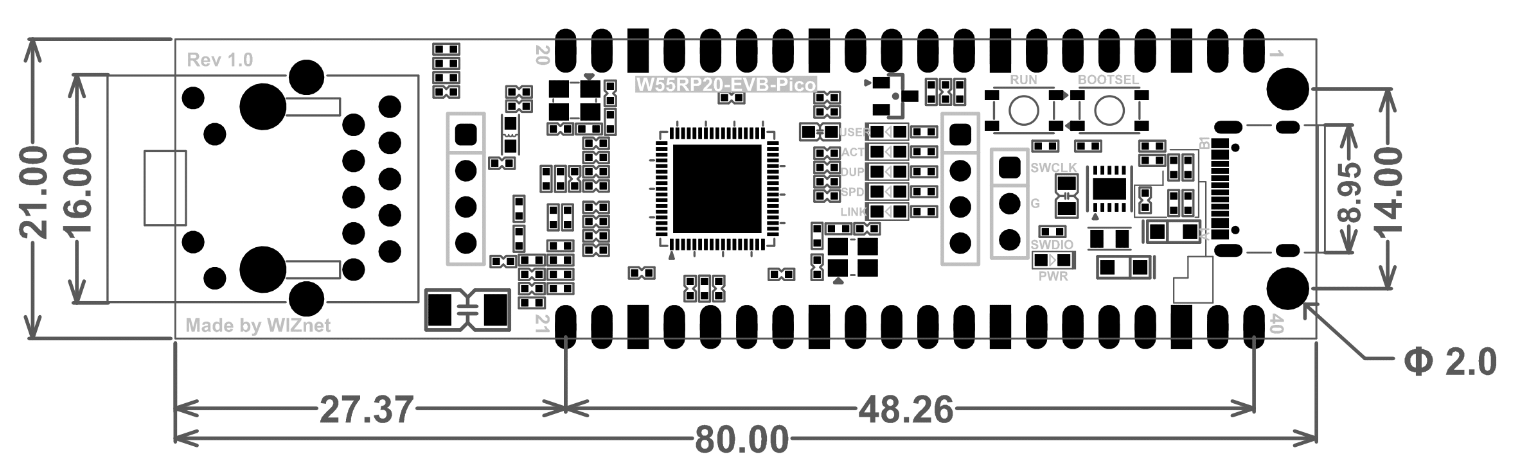

I have no idea if it mechanically fits or not.The distance from pin 21 to the edge of the PCB is 28mm. Looking at the mechanical drawing, it might just fit.

The module pcb extends 2mm further underneath the RJ45 socket than on the other modules, relative to the 40 pin module header. I don't have a PicoTuner to see if the module pcb is going to hit the end panel. If it does, the RJ45 cutout will need to be extended downwards by 2mm to make room for the pcb.

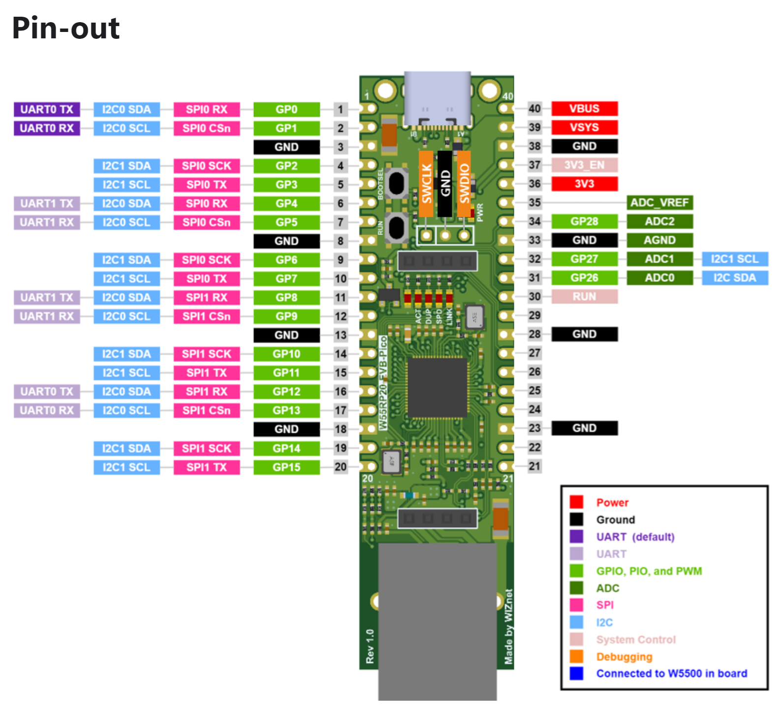

Are you saying GP22 (pin 29) is not connected at all? I think you might be right from this. Perhaps you could verify with a meter? If so then yes, simply connecting one to the other would be the simple solution.

Edit - the reason I ask is it looks like there is a wire going to it.

I thought the same, but that picture seems to be an early "artist's impression" for the the pinout diagram. The photo here is the real thing and there's nothing connected to pin 29, nor to pins 21, 22, 24, 25, 26, 27 where the HAT used to connect.
