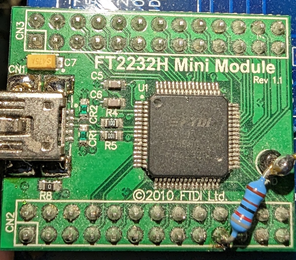

Just be aware that although the USB module is ready programmed, you do need to add a 10k resistor if you are going to use the later versions of the Minitioune software. Pin 10 of CN2 to ground as below.

Thanks Clive . . . I did that this morning. Funny, I used a 10k (says 5.6k to 12k).
