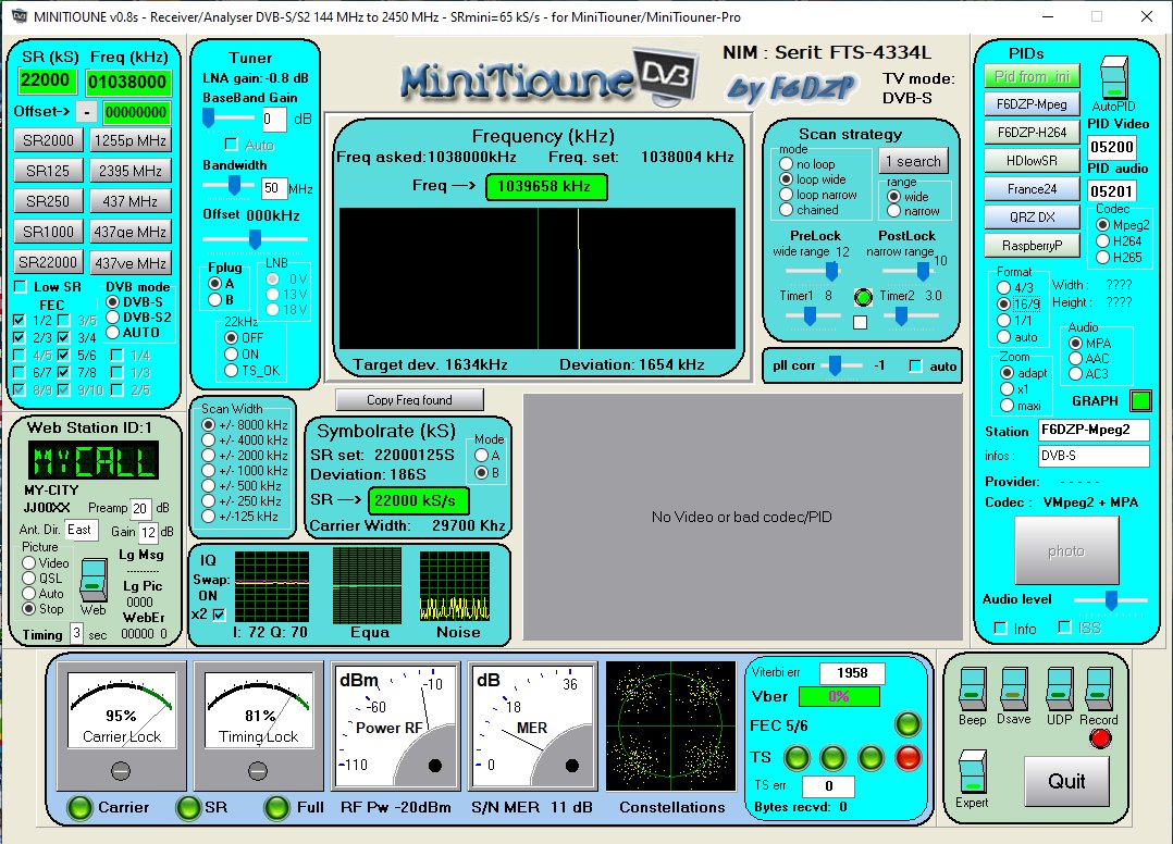

I have spent many hours trying to resolve this issue, I trust somebody can suggest some further investigations:
1) I am using v0.8s software.
2) I have tested on two desktop PCs and a laptop, all behave in the same manner.
3) USB Master I2C performance is 83%
3) The unit displays all green LEDs when tested with CheckMinitiouneDriverandFilters_V0.5a.exe
5)As per posting on the vivadatv.org site the 74HC10 has been changed three time but has made no difference to the problem.
6) Integrity of PCB tracks and solder connections have been tested.
6) Logic signals on the 74HC10 (TS2CLK, TS2VALID, TS"ERR) appear to be in order.
7) The LAV filters have been re-installed
8) Screen image when receiving Freesat channel on following URL Image
73s
Peter
G8RW

What are you trying to receive Peter? The minitiouner is not designed for high bandwidth commercial transponders. It seems like the TS data is not making it to the PC, could be several reasons but the QO100 beacon would be a good place to start and look at the data lines on a scope to see if they are all working.

I suggest that you try to test your MiniTiouner in someone else's working system, with a known good input signal of less than 8MS symbol rate. as Mike says, the tuner was not designed to pass the test that you are setting it.
We have seen one or 2 tuners (out of over a thousand) that have exhibited a hardware fault that might show the same symptoms as yours, but there could be many other causes; these need to be eliminated first.
