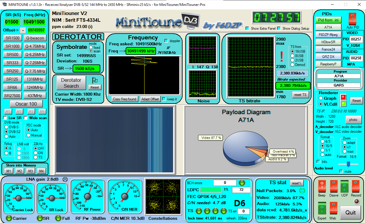

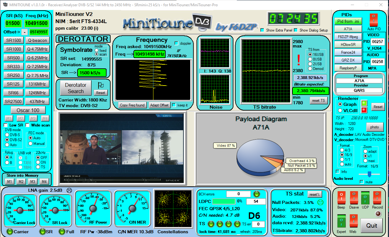

My main computer has a MiniTiouner PRO2 connected and working.
Feed from dish goes through a line amp then to a 4 way splitter.
The LNB voltage is supplied from my MiniTiouner PRO2.
The BATC MiniTione is connected to my Laptop.
I can receive the Beacon in Graph mode but not VLC.
Unable to decode amateur signals on BATC MiniTioune all OK on my MiniTiouner PRO2
I have included pictures of my tests.
Need Help Please !

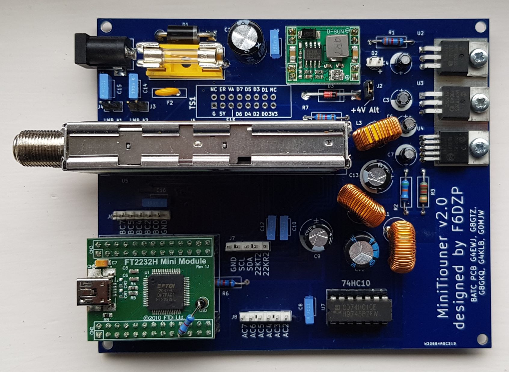

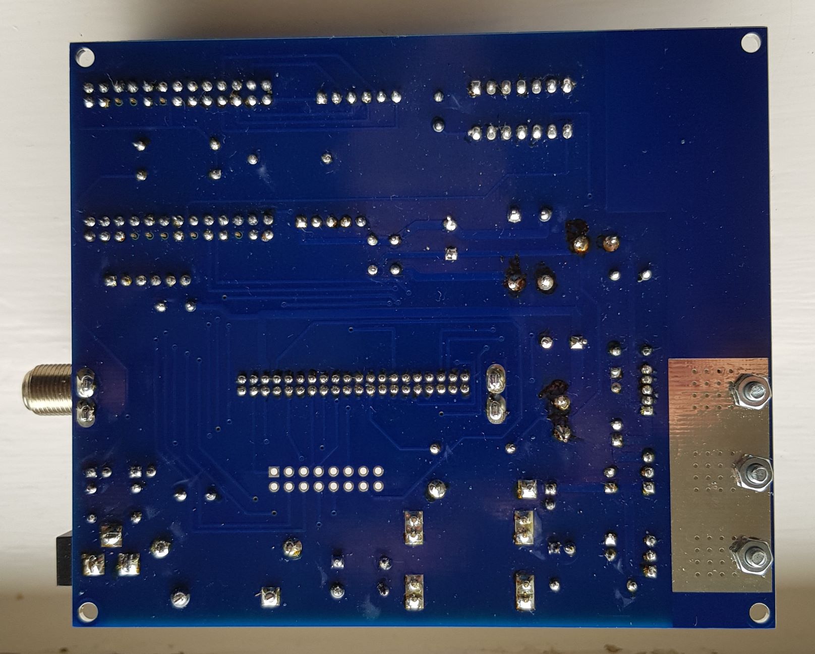

- My BATC MiniTioune Solder Side S.jpg (242.71 KiB) Viewed 7667 times
- My BATC MiniTioune Component Side S.jpg (301.72 KiB) Viewed 7667 times
- BATC MiniTioune VLC Mode.png (305.14 KiB) Viewed 7667 times
- BATC MiniTioune Graph Mode.png (437.51 KiB) Viewed 7667 times
- BATC MiniTioune.png (122.92 KiB) Viewed 7667 times

Hi Martin,
Not sure from your question but are you saying the BATC minitiouner does not work at all or only in graph mode? If the latter make sure you have 32bit VLC installed. The beacon has a fault, you might be better off trying to receive your own transmissions. Oh, and turn off hardware decoding in VLC.

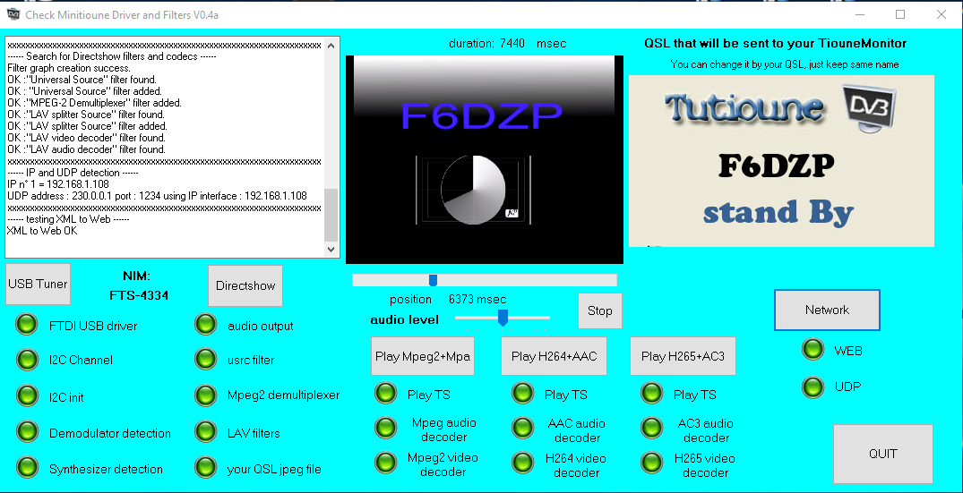

All the picture are of my laptop with BATC MiniTioune connected.
The beacon will display using my Minitiouneer Pro2 in Graph or VLC mode at the same time on my main computer.
On my Laptop the BATC MiniTioune will only Decode the Beacon in Graph mode.
I have reinstalled VLC 32bit on my laptop.
As you can see F6DZP test all green OK on my laptop.
The BATC Minitioune will not decode other amateur transmissions at 333 etc.
My Minitiouneer Pro2 decodes all.
Hope that makes things clearer.

I have just connected the BATC MiniTioune to my main PC with (H)18v supplied so it can feed the LNB.
All is working now on all modes.

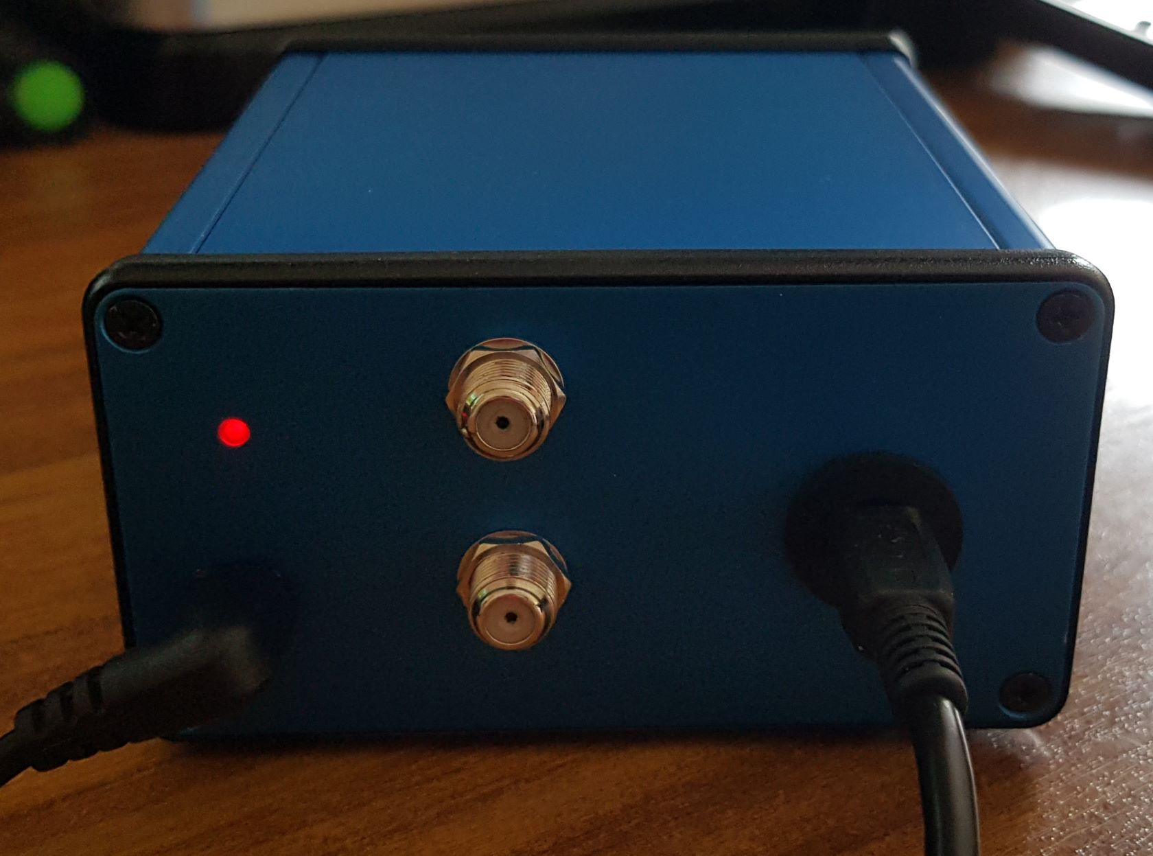

Now boxed and working.
An intermittent plug on PSU didn't help diagnosing problems.
With LED now fitted could see the fault.
Should have fitted LED when testing.
Thanks Mike for your help so easy to miss basic things like PSU leads etc.

Just to add PCB was excellent!

- 20220605_102847s.jpg (171.04 KiB) Viewed 7409 times
