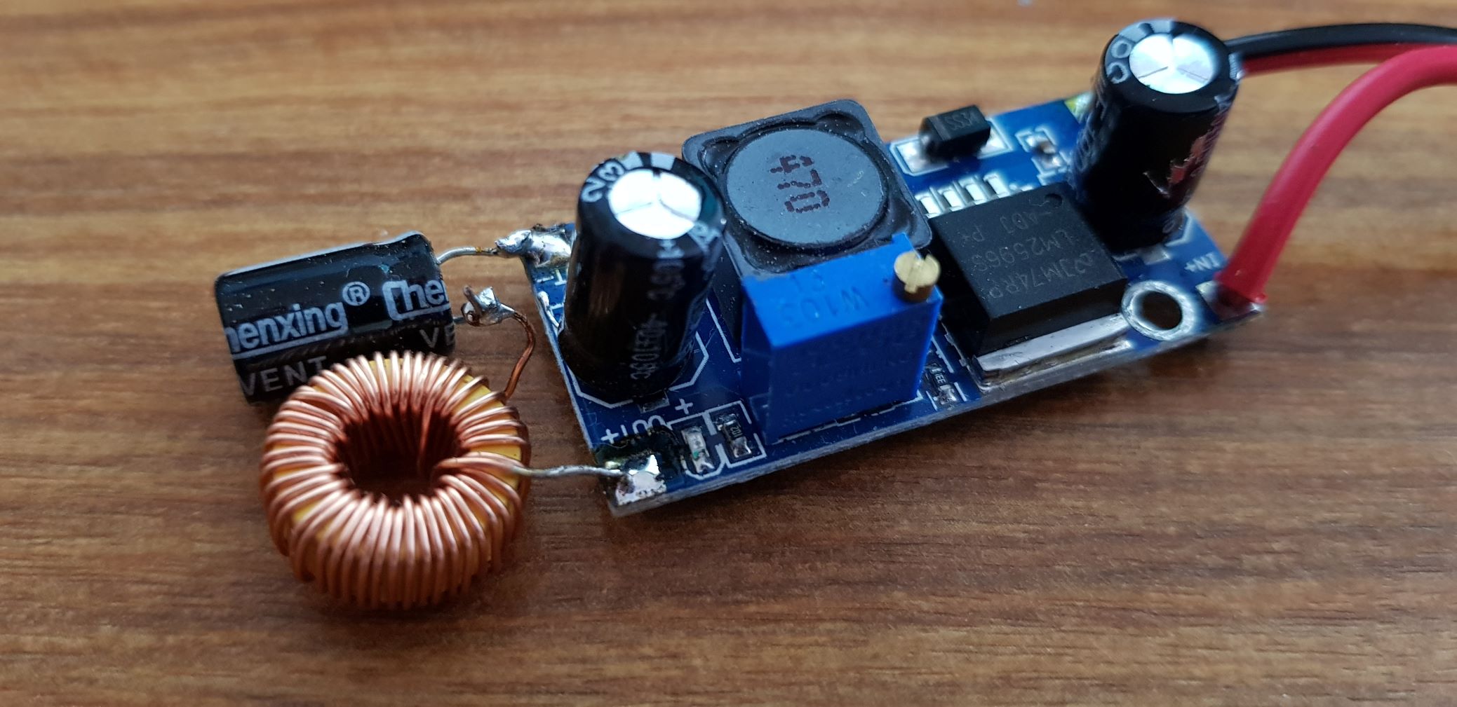

Post by G8KOE » Fri Oct 15, 2021 8:22 am
I always fit a DC filter after a buck converter.
A choke followed by a 100uF.
Choke not critical I used common ones found on eBay
Put a scope on DC O/P from buck converter and see the difference.
73's
Martin
G8KOE
Choke Filter.jpg (239.63 KiB) Viewed 5891 times

Post by radiogareth » Sat Oct 30, 2021 3:13 pm
Please correct me if I am wrong, but as per the picture isn't the solution....
+ve should pass through the inductor to a capacitor across 0 and +ve???
