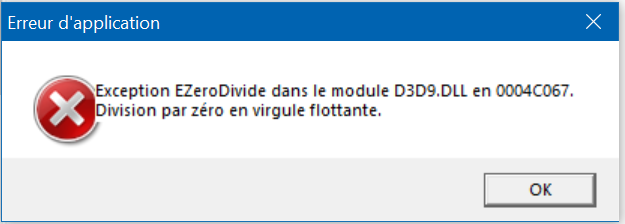

However, when I run the CheckMiniTiouneDriverAndFilters_V0_5a.exe I get the following error
The attachment d3d9 error.png is no longer available
Clicking OK just terminates the program.
If I try and run MiniTioune_V0_8s.exe, I get the following message box
d3d9 error.png (30.78 KiB) Viewed 9644 times
This time, clicking OK brings up the main MiniTioune screen and if I set the parameters to match the signal I'm tx'ing everything appears to work except the video decoding as shown here

If you look at the message the divide by zero error comes from the Direct3D and Directshow 9 DLL that is used.
"In theory you should always test the divisor is not zero before attempting a divide" but I cannot control this kind of error that occurs in a DLL external of my programming.
If you use a bad Directshow filter or one Directshow filter asked is missing, you get this kind of message when you ask this filter.
You don't have exactly programmed somewhere a divide by zero but, somewhere in the DLL, this kind of issue gives this message.
Today we discover another situation where we can discover this message and a way (I hope) to fix it, but I can't imagine what has exactly happened deep inside Windows "black hole?"

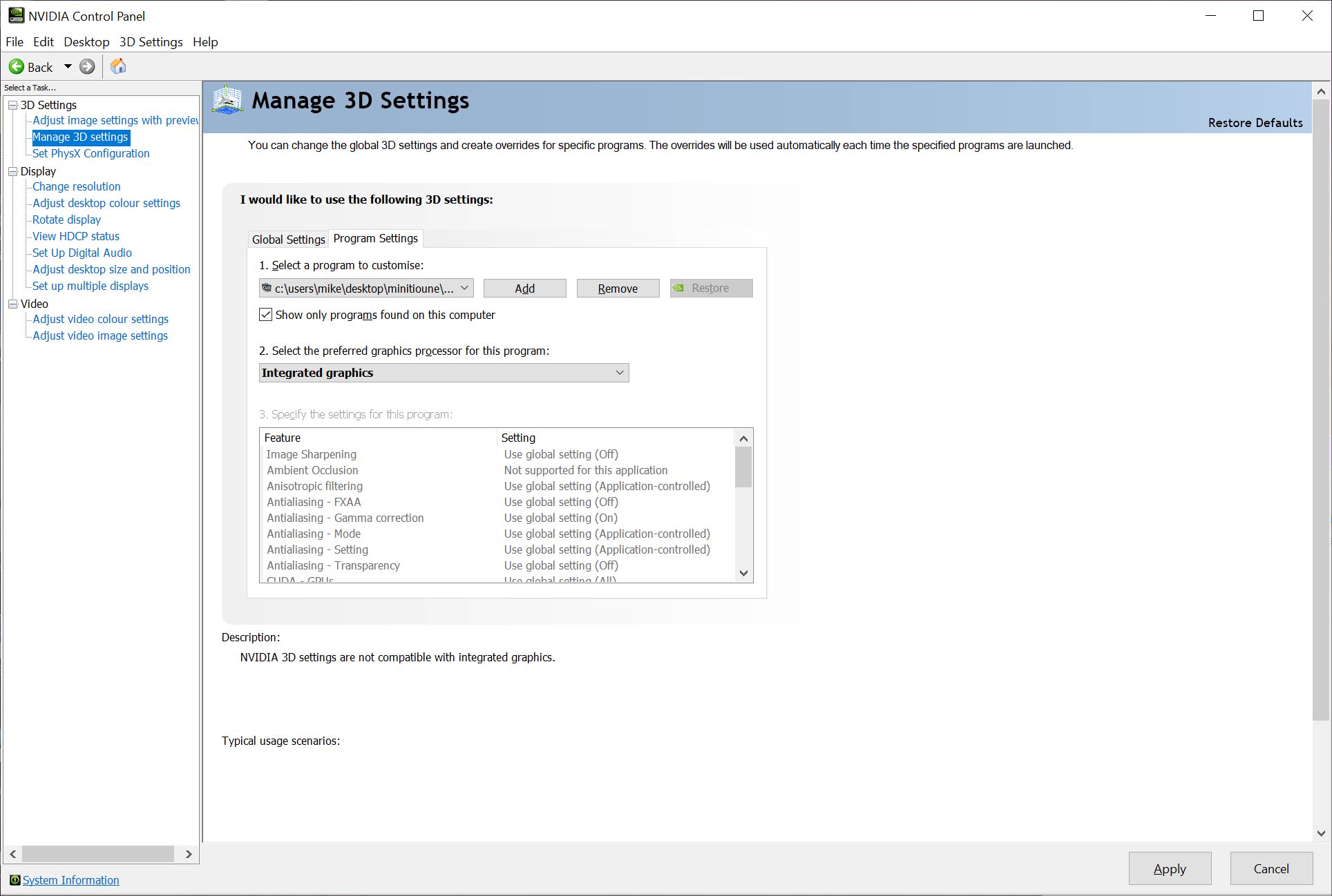

Came across it again. Here is the fix.

Thank you for posting that fix. Been fighting the same issue all day and ran across you post. Had a hard time making it out but finally got the changes made and now it works.
