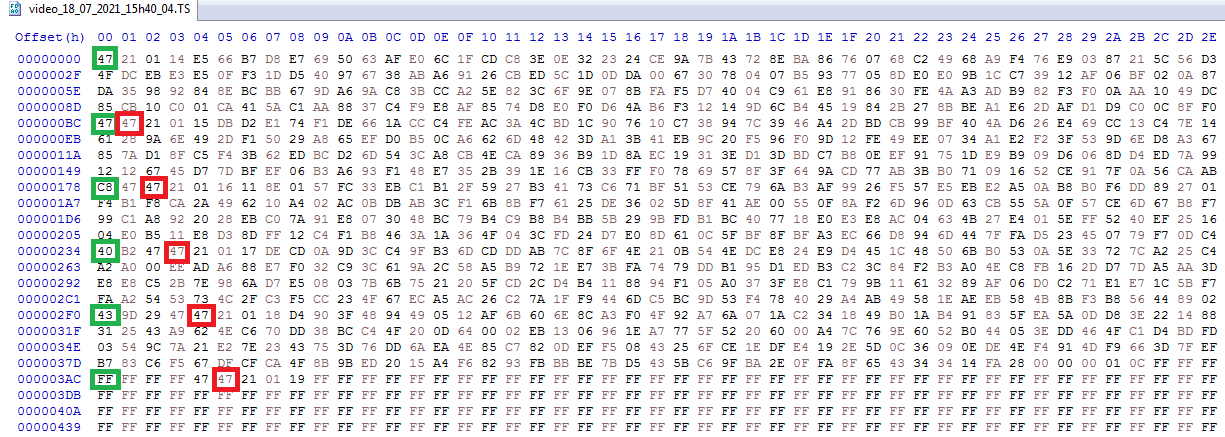

It seems to be picking up a duplicate packet start byte (0x47), so definitely check the signals on the 74HC10 and see that the output gets to the FT2232H.
A 188 byte packet should start every 4 lines (green squares) but actually starts every 189 bytes (red squares) due to the extra 0x47.

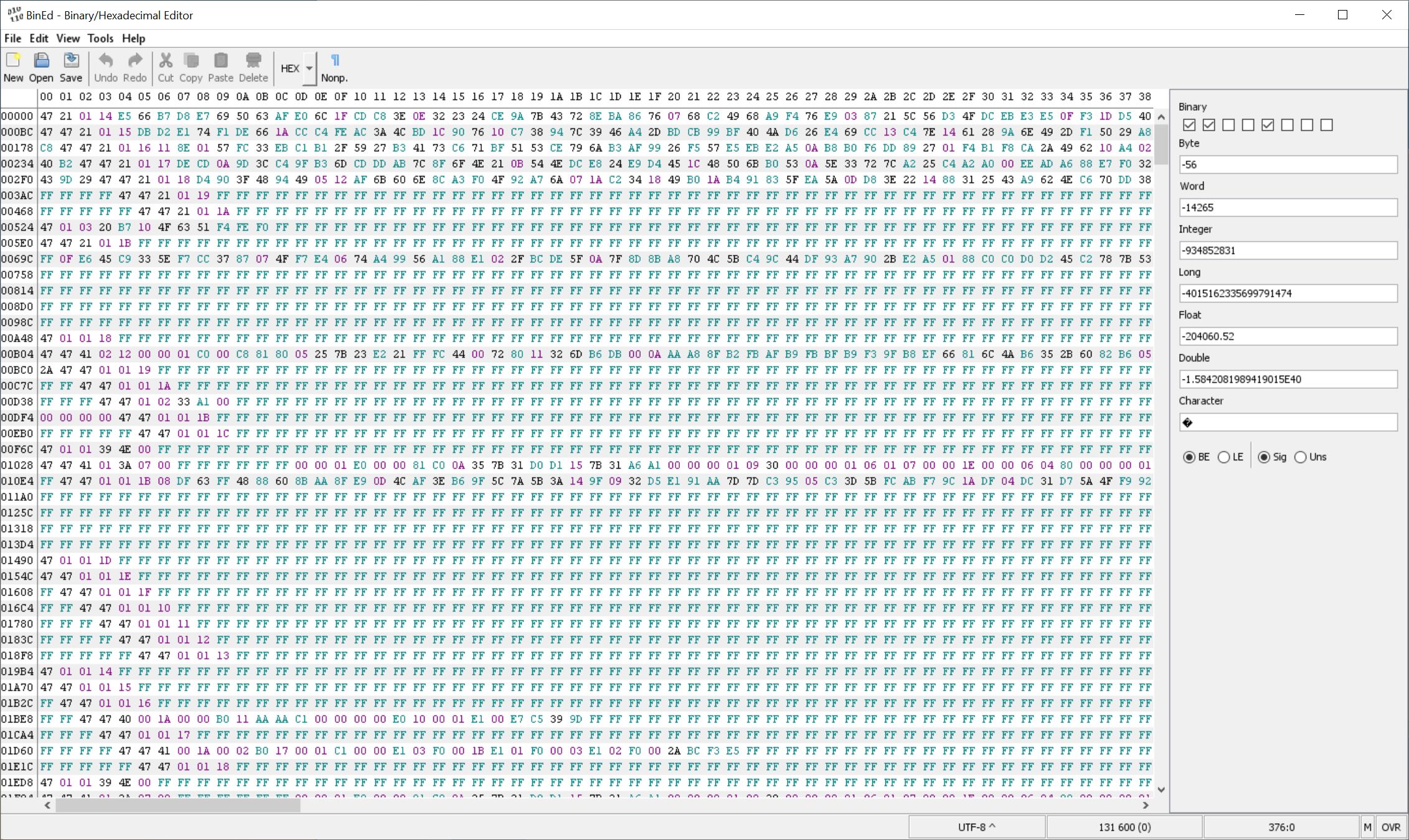

Thanks Brian - I was just trying to look up the packet structure to understand it.
Comparing with what I hope is a valid TS extract:
So why ? I think perhaps the device is glitching - this could be the NIM or perhaps the 74HC10. A photo of it might help.
Looking at the file it's not just that one byte being duplicated, it's other bytes duplicated or perhaps missing as well. Noise on the byte clock signal? Faulty FTDI module? Glitchy TSSync?

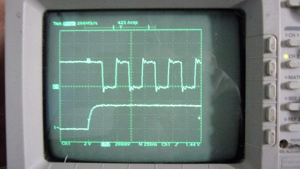

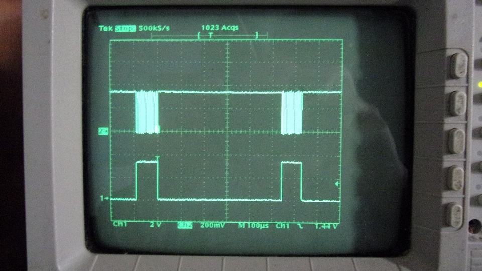

Here are some scope traces:
The photo below has the lower trace on 74HC10-10, which is the VALID signal from the NIM, which goes high when a packet is being output. The upper trace is on 74HC10-8, which is the strobe output to the FT2232H, which clocks in each byte.
The photo below is an expanded version, showing the phase of the strobe signal relative to the VALID signal.
Also check pin2-17 on the FT2232H, which is the SYNC signal from the NIM. It should be a pulse one clock wide, going high in phase with the VALID signal going high.

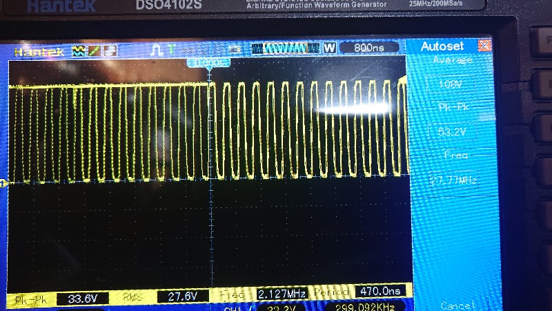

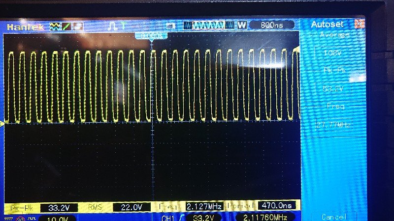

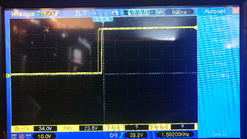

Ok not sure if this is the problem i have used a 74HCT10 Its a std 5v ic but working on 3.3v so i set the scope up and this is what i got.
Pins 1'2'13 TSerr. 0v ( no picture)
This is pin 8 the output
This is pin 9
This is pin 10
Posts: 2740
Re: External LNB power with the MiniTiouner question please?
Post by g0mjw » Sun Jul 18, 2021 6:26 pm
That's the problem. The specification is 74HC10. The HCT has a minimum voltage of 4.5V and expects TTL level inputs. It might appear to work but might well give unpredictable results. You are seeing exactly that.
