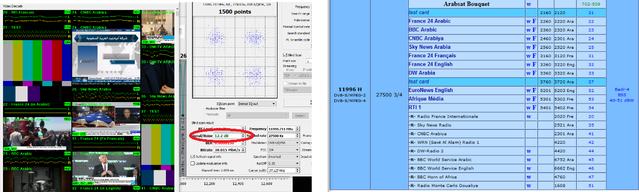

Hi maybe not but if you have a minitoune its not worth looking in to, unsure what your doing wrong with crazyscan it works great if your dish and skew is out it will give errors, 1,2 dish should be fine most of the time good luck with the alignment here is a frequency with my DB from 26E from my 1,2 dish give you something to aim for when aligning.
