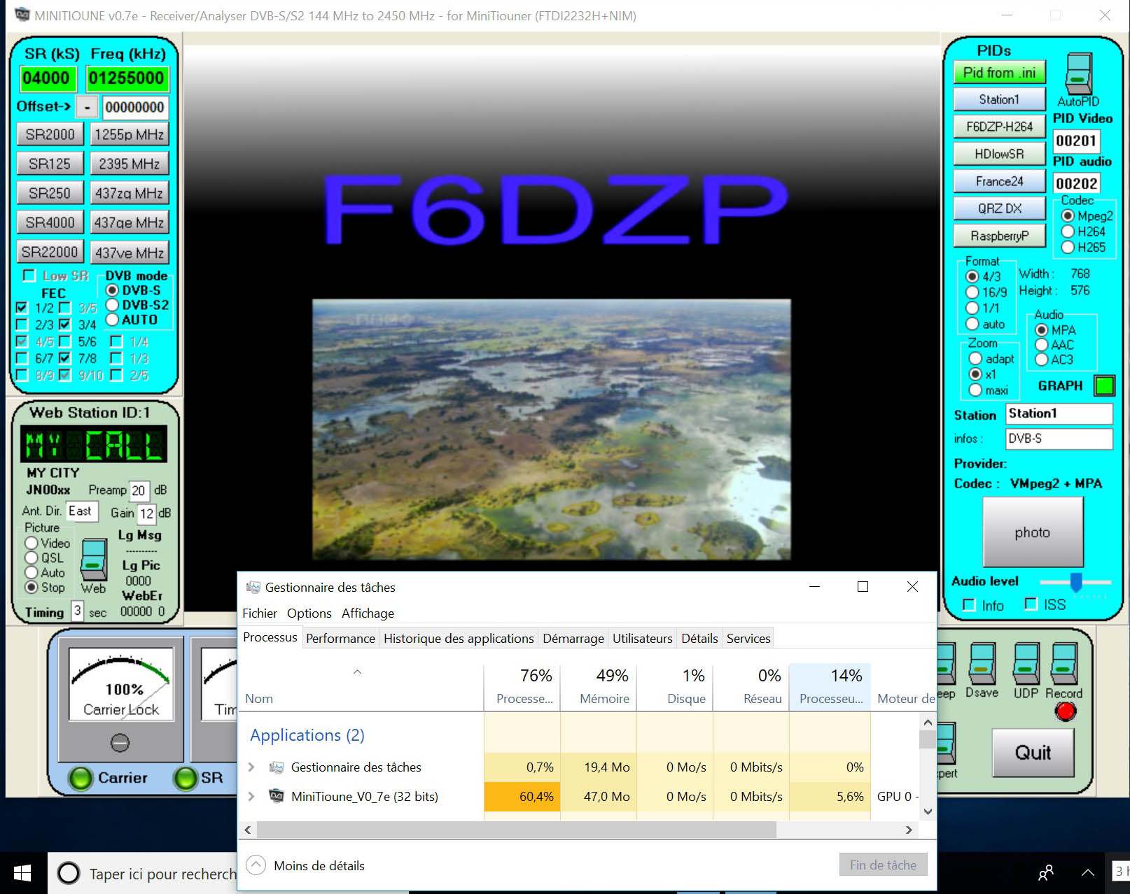

I have just bought a CHEWI Hi10 Plus (145 euro new - from France) and I have tested it using Minitiounev0.7
All tests have been a success and Minitioune runs well on it.
CPU power needed:
- about 75% receiving MPEG2_SR4000 or SR333_H264
- about 84% receiving a Broadcast station SR22000_Mpeg2
- 100% receiving a broadcast station with H264 HD but seems always fluid 73

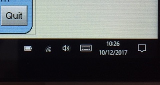

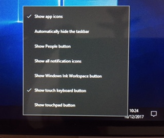

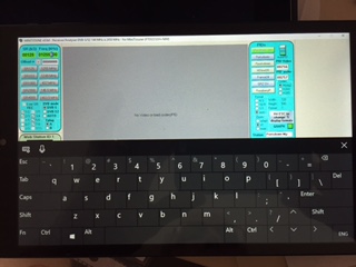

You can get a keyboard up on the touchscreen by doing a long touch (=right-click) on the taskbar, and then ticking "Show touch keyboard button".
This will put a button in your taskbar and when clicking it you will get a keyboard as shown below. To get the full keyboard with numbers easily available that I use, for some reason you need to select English(US), not English(British) as the keyboard language. This was a bug introduced by the latest Windows 10 update.
So, you can then adjust the MiniTioune settings.
