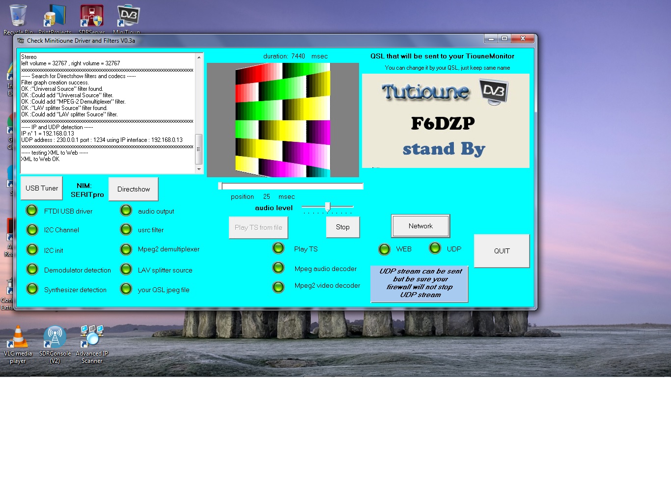

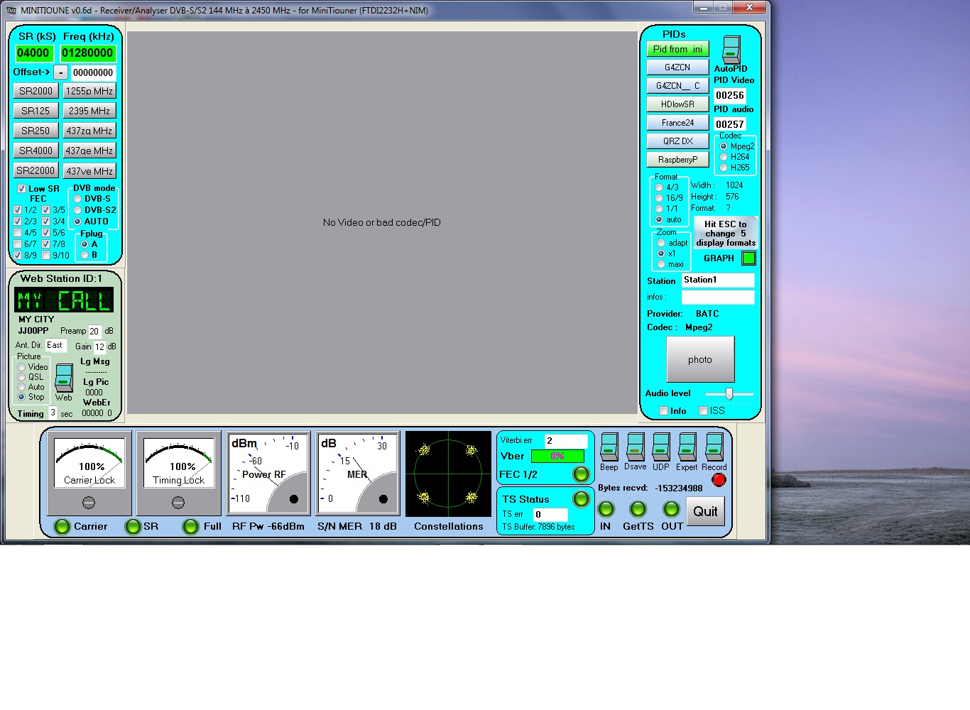

I recently added the extension pcb and Serit NIM to my minitiouner, unfortunately it now won't display received video. The Tiouner test programme works perfectly displaying all green leds and the standard rx screen locks to the signal giving good constellations, MER etc etc.
Has anyone else had this problem when adding the new NIM + extender pcb?

Pics now attached see below.
Video from the DTX-1 is being received as normal on a FTA satellite rx without any issues

Looks to me like you are receiving the TS but not displaying the video. That's more likely to be a problem with codecs and graphs or even the PID not being set. If you record the TS, can you play it back in VLC?

If you record the TS file, you can try to see the video using VLC,( but it doesn't work) or analyze it with TSreader_lite (free) or OpenEye dvbanalyzer or Cypheros TSPacketViewer or MPEG-2 TS packet analyser ... to be sure that you get TS packets : with "MPEG-2 TS packet analyser" do you see the first byte = 47 at the beginning of packets?
Looking at your screenshots, I can say that your NIM is well locked and receive the TS, but the TS is badly sent to the PC and the packets received by the PC are bad.( the PC reads the bytes but I think that one (more) bit is fixed, due to a bad solder/contact or has a bad value due to a short with another data line.
So, yes, there is a bad contact on one(or more?) TS data line between the NIM and the Minimodule. check TS2- D0 to D7 between the NIM pins and the minimodule pins.
