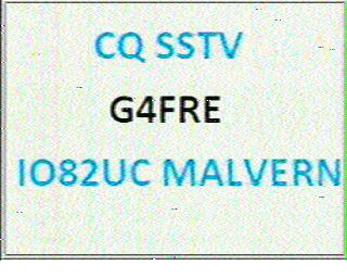

Inspired by Mikes explanation yesterday on the AMSAT QO100 net yesterday i dug out the Libresdsr put the pluto.frm onto its drive and ejected it and it worked
I updated to SDR console 3.4 and that works fine, during which. I saw a signal on 144.5 which sounded like SSTV and discovered an SSTV store and forward SSTV repeater in south birmingham GB7TW which I hadnt seen before. 2 hours later, after many rabbit holes, i managed to get a signal through it

G4FRE
The returned signal from GB7TW
