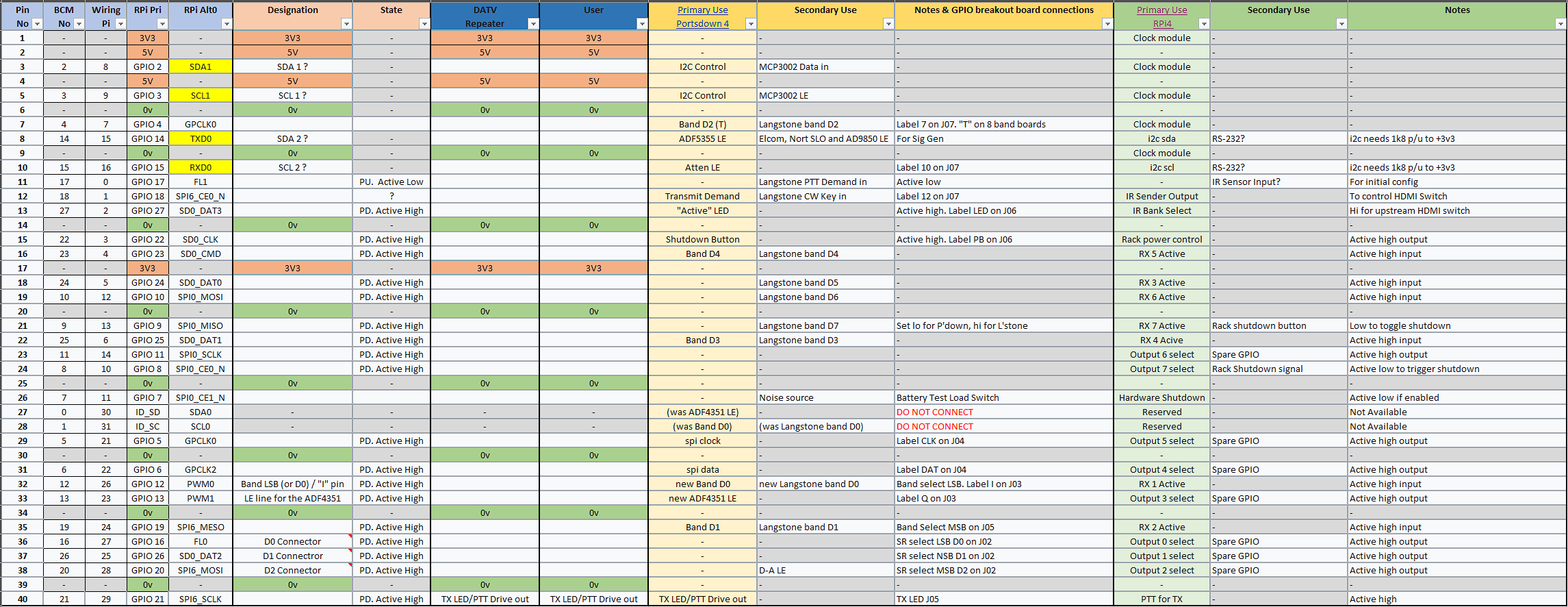

Hi, looking at understanding the various GPIOs that Portsdown uses, in particular for use for the repeater.
Not knowing the history of why the I2C was moved/duplicated from the default Pi GPIO 2/3 to GPIO 14/15, was it only relating to separating RTC, or for higher clock speeds for the ADF5355?
https://wiki.batc.org.uk/DATV_Repeater_i2c_Interface
Could not find anything that jumped out relating to Portsdown 4, so any info would be appreciated.
Have created a matrix of the Pi4 and Portsdown 4 connections. This is WIP and helps me have a holistic overview.
Portsdown default I2C and use of GPIO 14/15
- BATC Portsdown Connections - WIP Matrix 241207.png (343.55 KiB) Viewed 5150 times

Hi Dave
Not quite sure what the point of your exercise is here. You seem to be comparing apples with oranges.
The DATV Repeater Controller and the Portsdown are 2 totally separate projects; you can't run them both on the same physical Raspberry Pi. It is not even possible to have a test rig that copes with both configurations (I did try once).
The Portsdown 4 GPIO usage is non-standard as it evolved from the Portsdown 2020 which in turn evolved from some very early work by F5OEO and myself (when I really did not understand enough about it!). It has since been modified slightly for compatibility with the Langstone transceiver.
The Repeater Controller GPIO usage was a fresh start, trying to learn from the mistakes that I had made during Portsdown 2020/4 development, so it more closely mirrors the Raspberry Pi foundation's recommendations on pin usage.
Maybe I've misunderstood your question, but hopefully I've managed to explain why we are where we are.

Hi Dave,
Really appreciate your reply and information.
Background
As a 'newcomer' to Portsdown (although did dabble slightly a few years ago), my objective was to get an idea of what the GPIOs offered for the repeater controller - this then led to the two exposed I2C ports.
In order to try understand, I am pulling the matrix together of all the GPIO info I could glean from the Wiki's, together with odd comments on various pages, and this hopefully expand in detail and give me a holistic overview - AKA picture in my mind of potential connections and what I could do and equally can not do.
Also respect that the project has evolved massively over the years and gallons of midnight oil has been consumed in the process - which is genuinely appreciated by many.
Evaluation
Will now wander off, install and explore the repeater controller build, play and learn more in the lab - also about overall power management. I would like to embrace this route for both repeaters but importantly build reliability confidence out in the field, when for example a power outage may regularly happen (particularly on FW which is totally solar/wind/battery powered) and ensure the Pi services and repeater always recovers in the right state.
KR Dave
