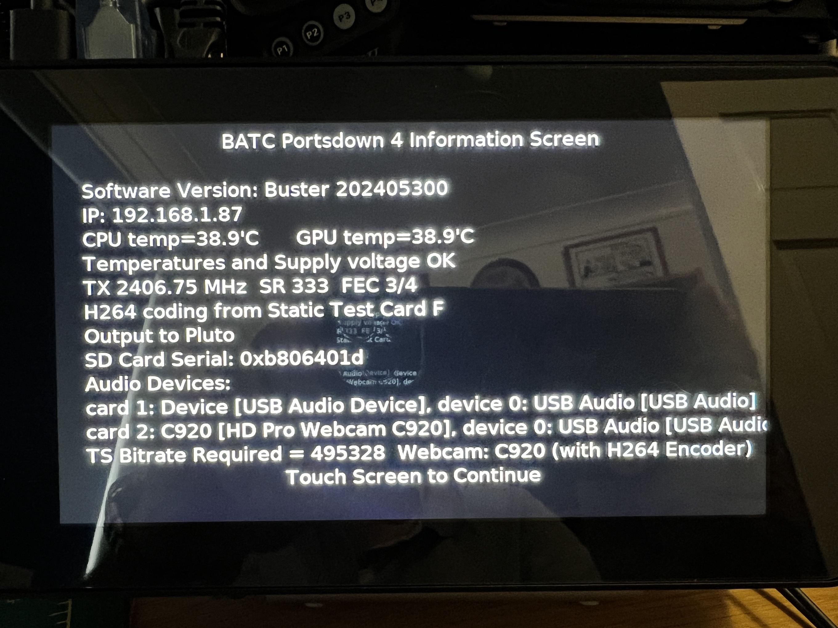

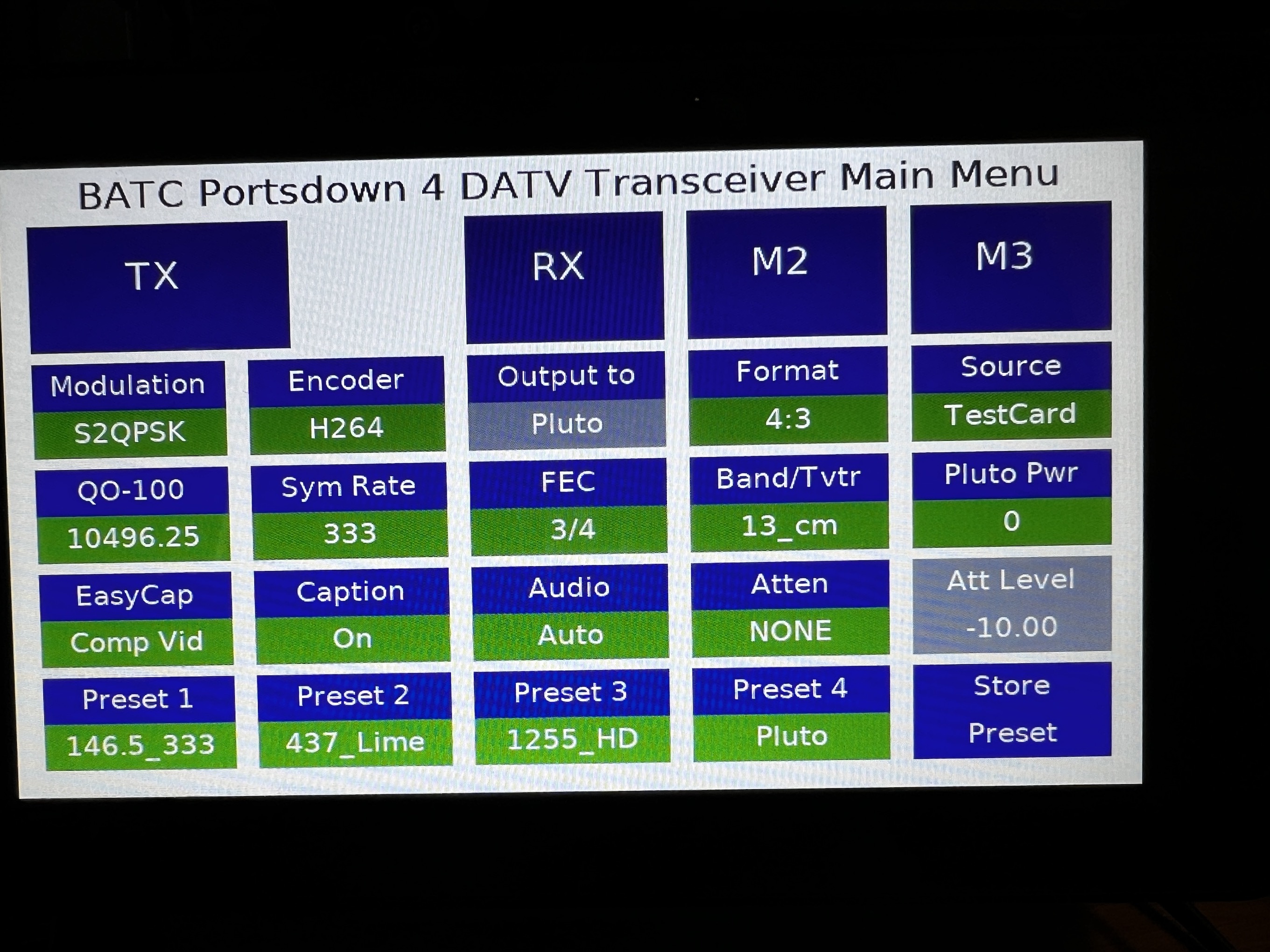

Hi Guy's,
I now have Portsdown-4 receiving WB DATV from QO-100 via a PicoTuner, a bullseye LNB and a 90cm dish, so my attention is turning to the TX side of the setup.
WB DATV TX is Portsdown-4, Ethernet linked to a Pluto, outputting to a Pre-amp - Power Amp - Helix and 1.2m Offset Dish.
However, on the main screen of Portsdown 4 "Output to Pluto is greyed out and when I hit the TX button to send say a TestCard or webcam streaming in PD4 the Pluto is not going into TX.
I can communicate absolutely fine on the ethernet link between the Portsdown 4 and the Pluto. I can use that Ethernet link to TX/RX NB Voice on QO-100 with the inbuilt Langstone software. I can use Portsdown-4/M3/Pluto Config to check the Pluto CPUs, Reboot the Pluto, Check the Pluto firmware etc etc so the problem is not the ethernet link.
Any Ideas appreciated.

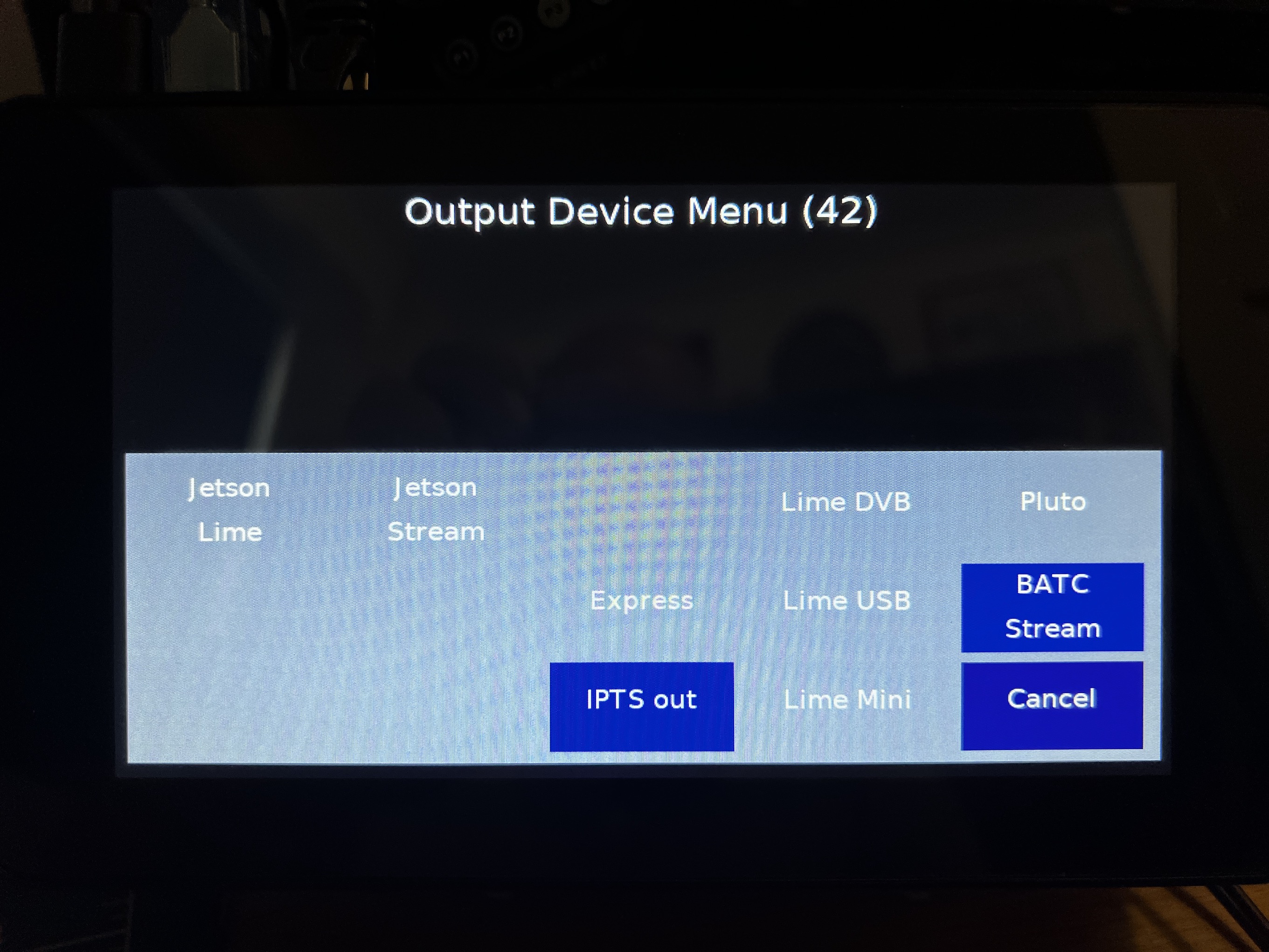

Re: Why Is Pluto Grey?
In the function, you need the two conditions, USB connection and ping to avoid having the grey button (line 9575) :
Menu 42 :
if ((CheckPlutoIPConnect() == 1) || (CheckPlutoUSBConnect() != 0))
If one of the two tests fails, the key is grey.
For Menu 1, only USB :
if (CheckPlutoUSBConnect() != 0)
73,
Stephane.
Menu 42 :
73,
Stephane.

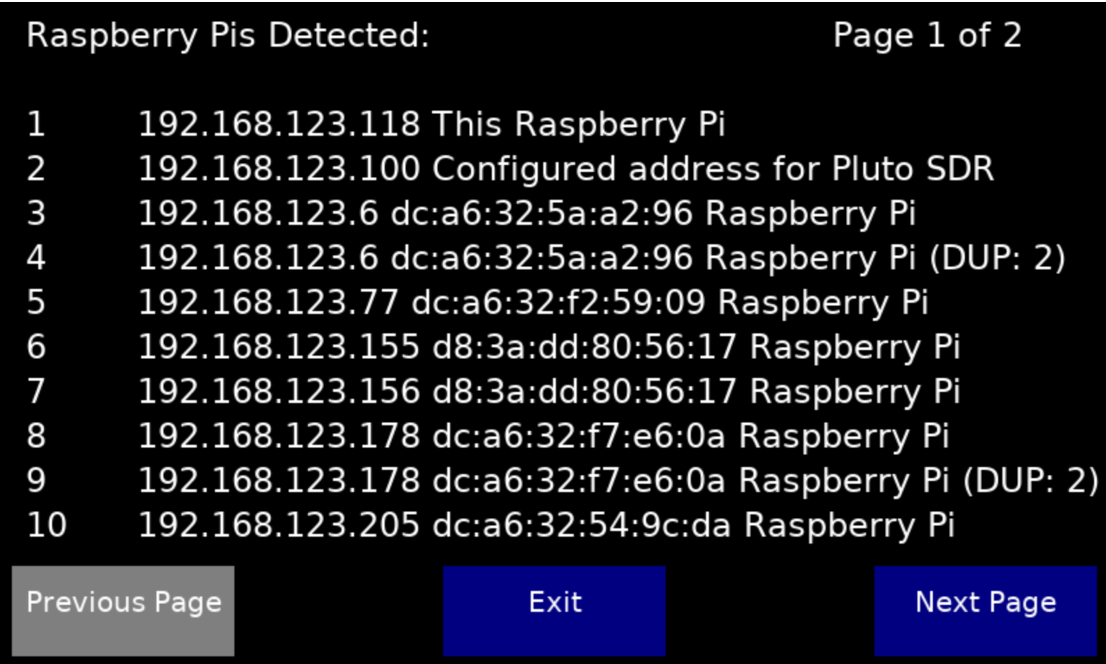

Greyed out is OK!
Just checked my system which although is not Q100 it is LAN based.
If you go to M2 then File Menu and this screen
Then List Network Raspberry Pis
Your Pluto will be seen if it is there:
Then you will have to find out what other setting is not right with the Portsdown 4!
Martin G8LCE
Martin G8LCE

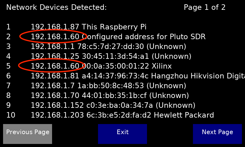

Thanks Martin,g8lce wrote: ↑Tue Jun 25, 2024 7:42 amGreyed out is OK!
Martin G8LCE
Well the good news is it is there, however I am curious about the 2nd device using the same IP?
- portsdown-screenshot_2024-06-25T09꞉25꞉20.774Z.png (83.2 KiB) Viewed 5772 times
Regards
Mark - G1INU
Mark - G1INU
I would say that that might be the problem although not an expert in these thiings. If it was me I would put the Pluto into a Windows PC, format the resulting 'sd disc' the Pluto appears as, then load the Pluto firmware onto that 'disc' and eject it.
It may be that you have some AMD software left in it from testing - or even some new device!!!
Xilinx has some connections with devices used to connect to a bricked Pluto etc. to reprogram it...
Martin G8LCE
