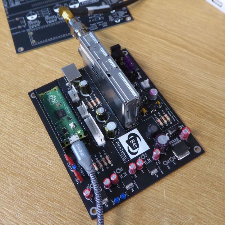

I have built my Portsdown and configured it. I have Built a Pico Tuner V3 and done the tests point checks and the firmware update. I have even put up a new dish for receive and run the coax but the one thing I can't find in the mass of information out there is how I connect the Pico Tuner to the Portsdown..
Obviously it will utilise a USB port on the Portsdown 4 but what about the pico tuner end, should I connect to the USB B socket, the Mini USB port on the pico or even the GPIO header on v3 board?

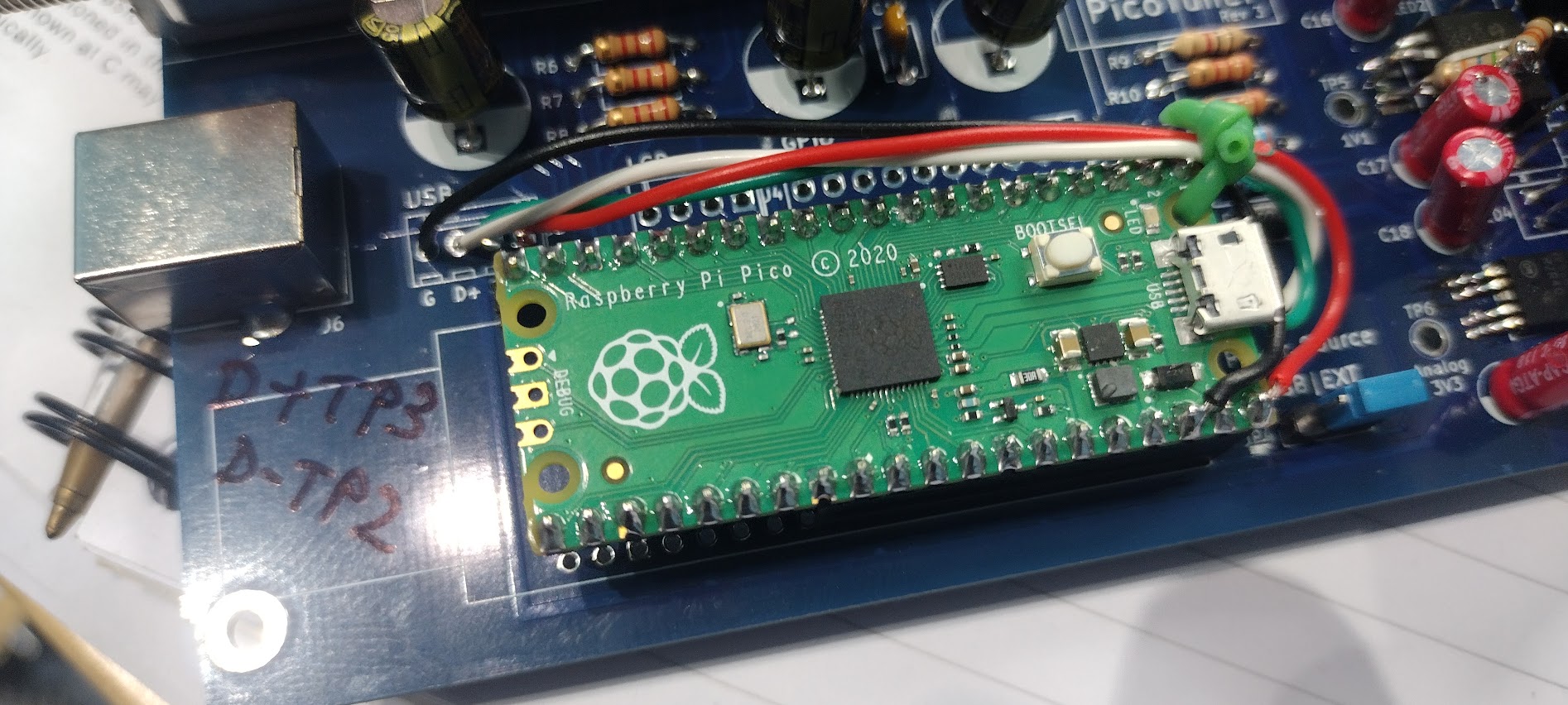

Micro-USB sockets are fairly fragile so the Picottuner was designed with a beefy USB-B. But you have to connect it to the RPI-Pico via the header on the Picotuner PCB. There are multiple solutions to doing this from using an old u-USB lead, small u-USB PCBs, or direct to solder pads on the Pico.
As I subscribe to the 'tis in vain to do with more that which can be done with less' I used wires as per the picture below. Connections are written on the PCB, with Gnd and +Ve as seen. The TP pads are marked on the underside of the Pico andare easy enough to solder to if everything is tinned and trimmed up short first.

We thought it obvious we forgot to say. The only USB is the micro-USB on the Pico. The USB-B socket is there It is because the mini-USB is so fragile, you don't have to use it but it helps, especially portable.
See the bit in the build instructions https://wiki.batc.org.uk/PicoTuner_Hardware about wiring the USB header to the Pico using a cut up cable. Also please put it in the correct way around. The image unfortunately doesn't show USB connection, well it does but to the pads under the Pico rather than via the socket. We need a better photo there.
