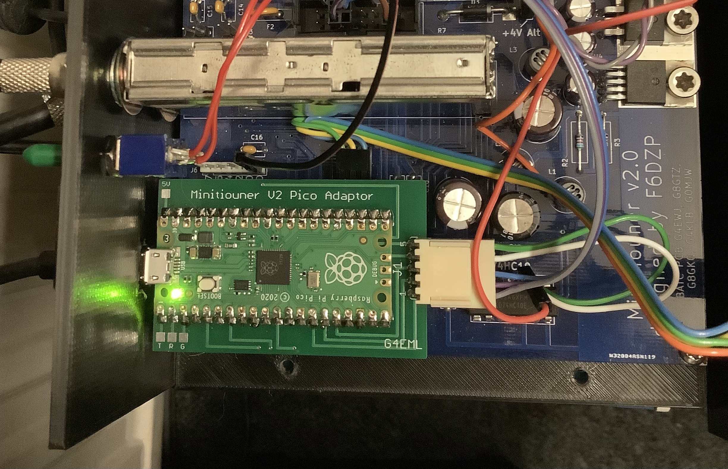

The green led on the pi pico, when led on all ok but it stops working when led off

I know that VLC is very fussy about signal quality. Stopping and starting the stream can cause such lockups.
The green LED lights when data is available for the host to read and turns off when the host reads the data. So it will come on steadily if the host software is not running and will flicker in normal operation. The brightness of flicker will change depending on the SR of the signal. The Beacon will be quite bright, a 250K TS will be dimmer, no signal will still flicker but extremely dimly. Some Picos also seem to have very dim LEDs so it may not always be visible on all boards.
If you want to add LEDS to show when a signal is being received connect as follows...
T on board to the Anode of an LED, Cathode of the LED via a series 1K resistor to G on the board. This will indicate TS1 Valid
R on board to the Anode of an LED, Cathode of the LED via a series 1K resistor to G on the board. This will indicate TS2 Valid
Colin G4EML
