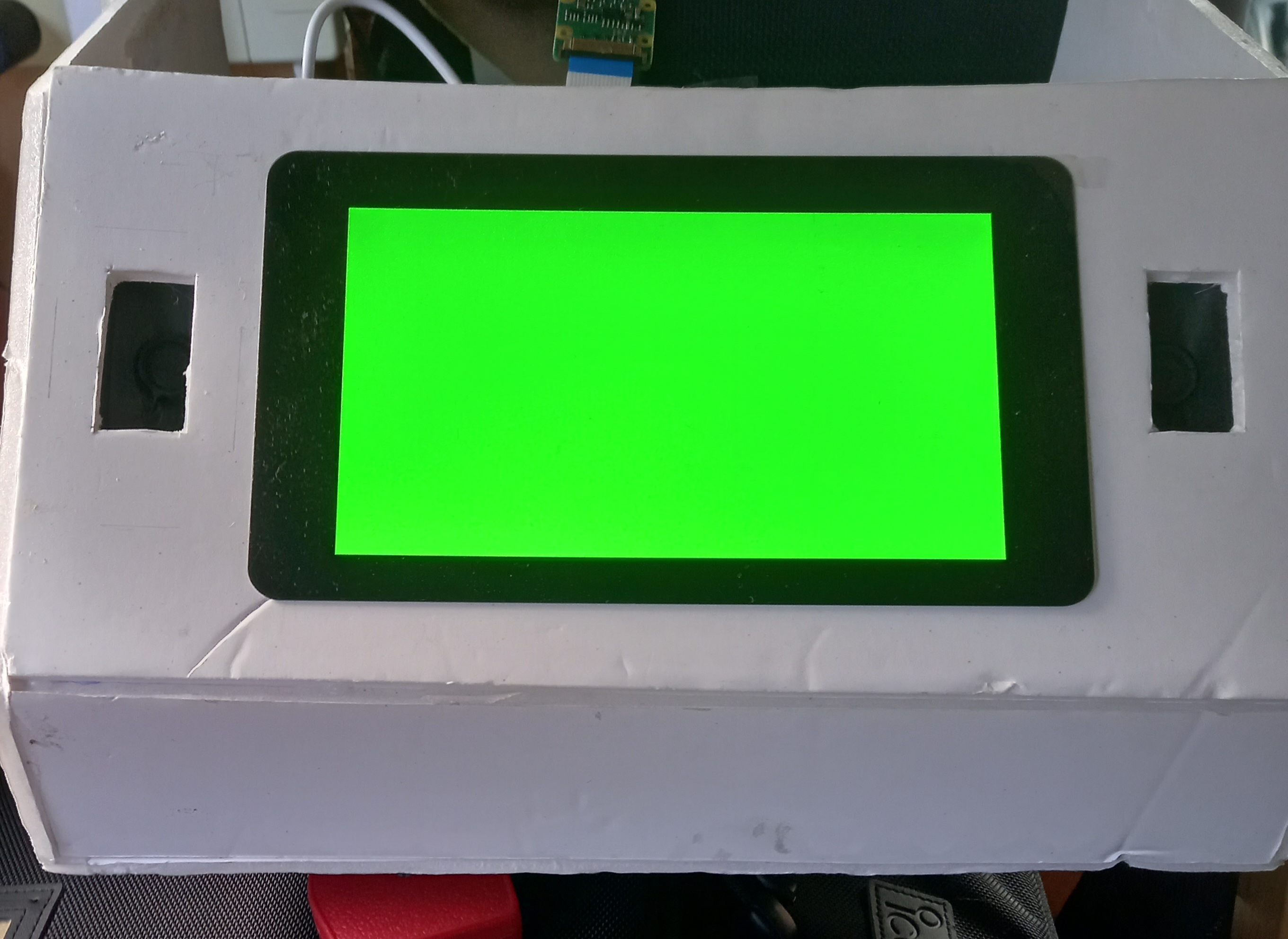

Latest test. I now have a green screen when selecting Pi Cam Monitor

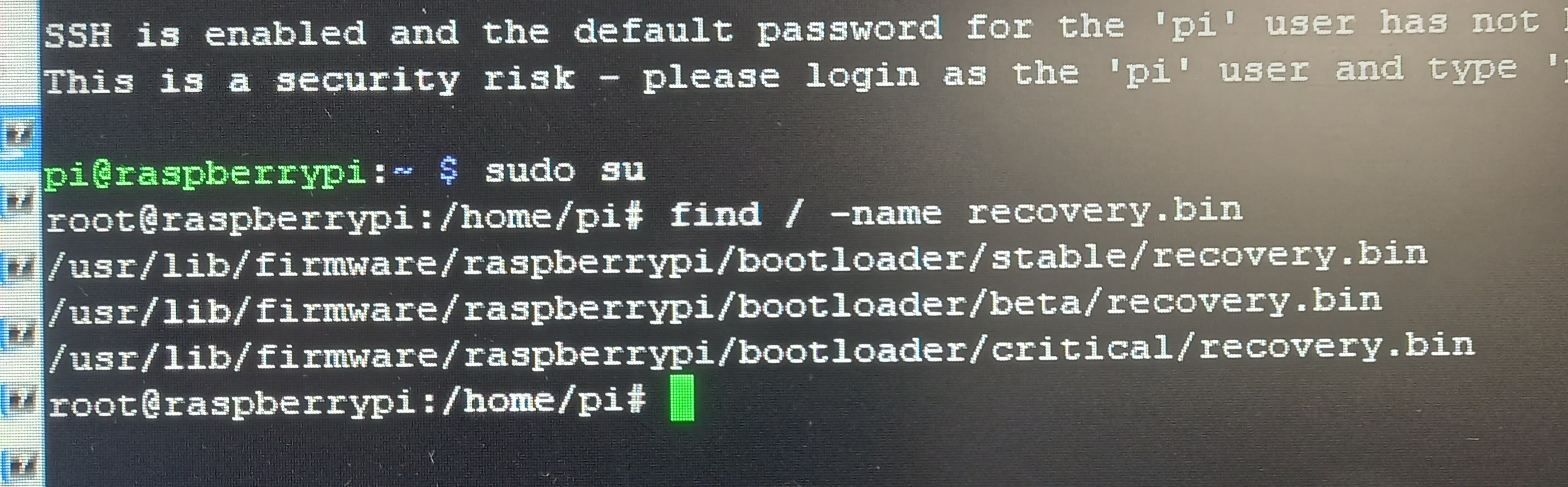

Last night at club we tried many things. We tried with putty to control pi cam. We know the Pi can see the camera is connected. We tried to control Pi cam from ommand line, thiya failed. We tried a USB camera. Same result a solid green screen but Pi knows camera is present.
On the web we found a forum saying delete a file to stop green screen Something relating to successful eprom update. This file deletion made no difference. We updated Portsdown software to latest version this did not fix camera problem.
