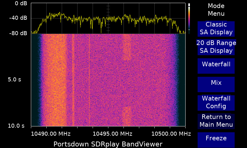

Re: Portsdown 4 BandViewer and SigGen update
Hi All
I have just released another update (202309300) which includes numerous small enhancements to the SDRplay BandViewer. The update includes:
I will try to port these features to the other BandViewer versions, but first I need to do some hardware stuff for a change to maintain my sanity!
- Checks to prevent trying to tune to a frequency outside the SDR limits
- The ability to enter a frequency offset
- Waterfall timing calibration marks and other display enhancements
