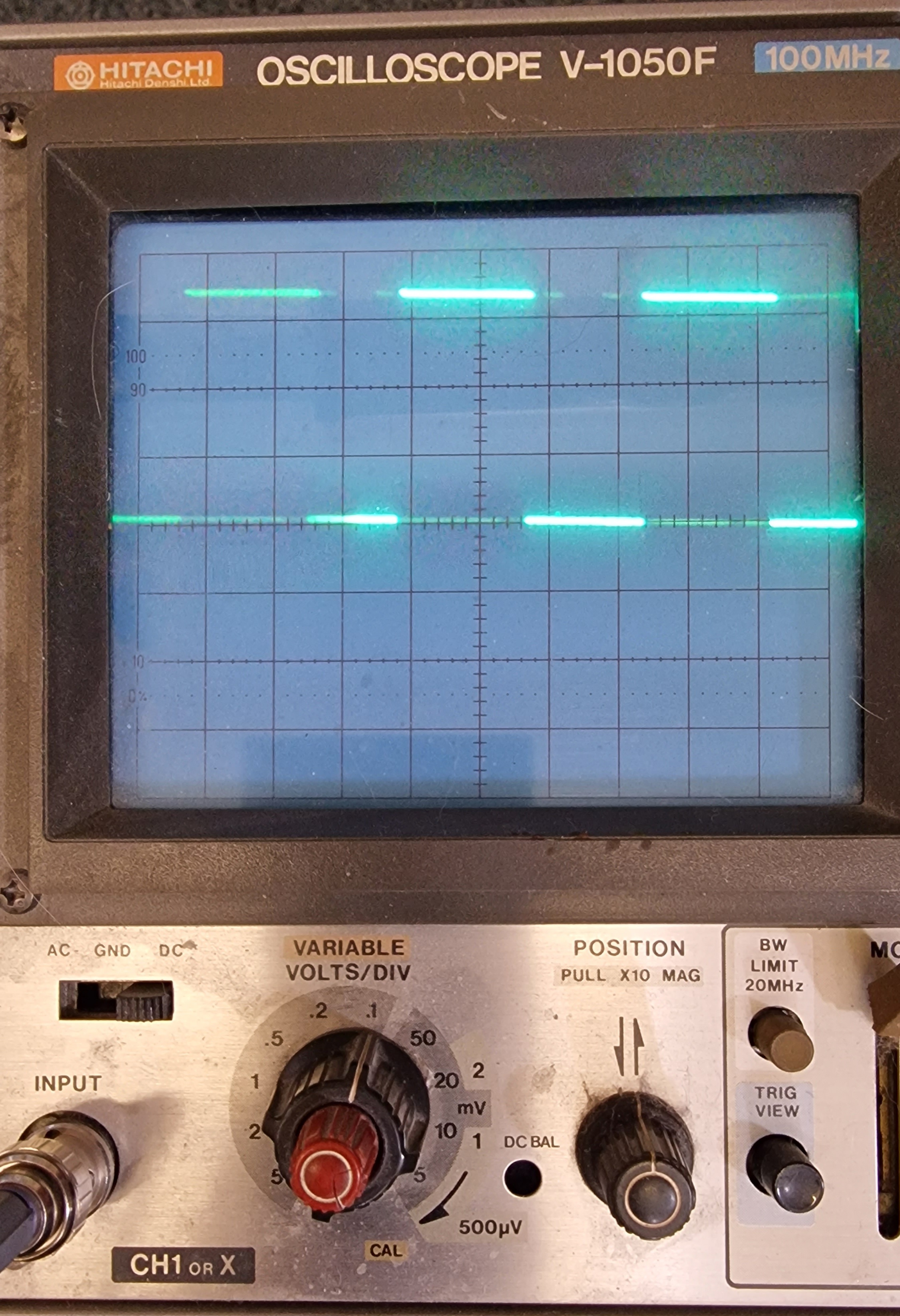

Following instructios for the DMM to go into settings and select invert input and restart, it resets to signal normal so do I have an input error from my lidl meter or my interface the signal is moving up and down on the pi 4 pin 3 GPIO02.
Any suggestions as I get no readings.

Post by G8GKQ » Thu May 04, 2023 9:34 am
Hi Brian
You should not need to select invert to make it work. Have you tried it the other way around?

Yes, I have and no difference will have to put scope on to take a closer look.

Scope set to .1v per div with x 10 probe, looks about 3.5v, perhaps my pi4 pin 3 gpio02 not working.

Got it working thanks, I can not count was on pin 5 of gpio not 3, sorry for that.
