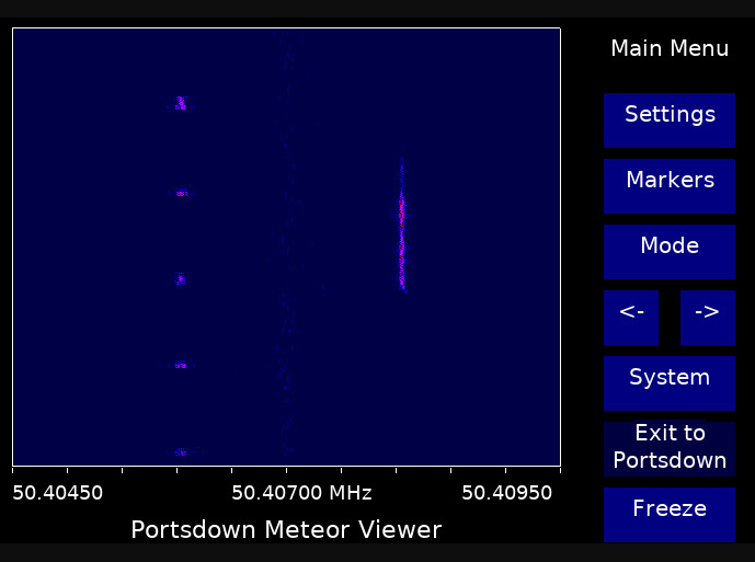

This update introduces the "MeteorView" facility which works with an SDRPlay RSPdx (and other RSPs) to display received "pings" from meteor reflections of the GB3MBA beacon on 50.408 MHz (see the meteor on the right below). It has both waterfall and spectrum view modes, in bandwidths of 2.5, 5 and 10 kHz. Access from Menu 2, Test Equipment. It is a very specialised application, but I hope to extend the more familiar "BandViewer" functionality to the SDRPlay series of SDRs soon. Similarly, I also hope to provide the waterfall display option in BandViewer for other SDRs.
