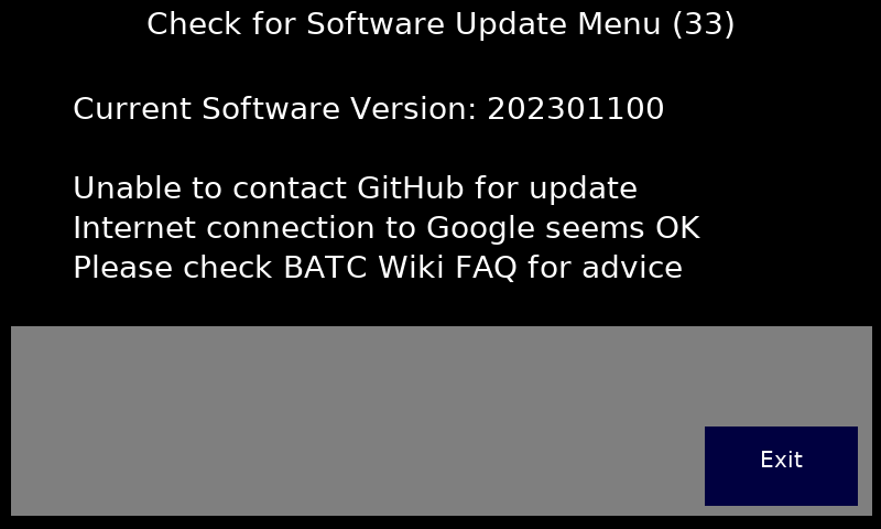

g8lce
Posts: 435
Re: Portsdown 4 Update for LimeSDR Mini V2
Post by g8lce » Thu Mar 16, 2023 11:04 am
Hi Dave,
Where do I find the answer? I have looked, and it is on two Portsdown 4 and I can see GitHub....( on a PC )
Martin G8LCE
Post by G8GKQ » Thu Mar 16, 2023 12:34 pm
Hi Martin
The Portsdown FAQ has a section "How Can I update my Portsdown Software?"
In that section there is a link to the page https://wiki.batc.org.uk/Updating_your_ ... n_Software
The title "Unable to connect to GitHub to check the latest version" describes your problem. However, I think that the real issue might be associated with your ISP. https://downdetector.co.uk/ is reporting widespread problems at the moment.
I'm looking for volunteers to maintain the Portsdown documentation.....
btw - updates are working here.
g8lce
Posts: 435
Post by g8lce » Thu Mar 16, 2023 1:41 pm
Hi Dave,
Tried the solution of looking at GitHub on a PC and it returned version number 201811031
Have I time travelled?
Martin G8LCE
Post by G8GKQ » Thu Mar 16, 2023 1:45 pm
No, that points at a very old build.
Try https://raw.githubusercontent.com/Briti ... ersion.txt
g8lce
Posts: 435
Post by g8lce » Thu Mar 16, 2023 1:58 pm
Hi Dave,
That is better 202303010
Now I will have to try and get the Portsdown to see it!!
Martin G8LCE
g8lce
Posts: 435
Post by g8lce » Thu Mar 16, 2023 2:03 pm
Hi Dave,
The reason that happened is obvious when you compare the links... (https// left out )
raw.githubusercontent.com/BritishAmateurTelevisionClub/portsdown4/master/scripts/latest_version.txt
raw.githubusercontent.com/BritishAmateurTelevisionClub/rpidatv/master/scripts/latest_version.txt
as you said you are looking for someone to look after the documentation!
Someone younger than 72.5 hopefully!
Martin G8LCE (72.5)
