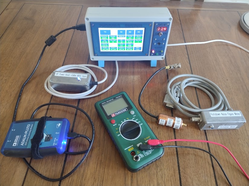

5" Small screen (DXRobot if I recall) works well but you have to rotate the touch screen - it will be documented somewhere. Both my PD4s have a built-in Rpi camera for reasons previously mentioned.......
For its functionality, its very worthwhile the real-estate it occupies....look closely underneath the toggle switch RHS....

I love Yr 5" screen. I was looking for a DFRobot screen couldn't find anyone with stock.
