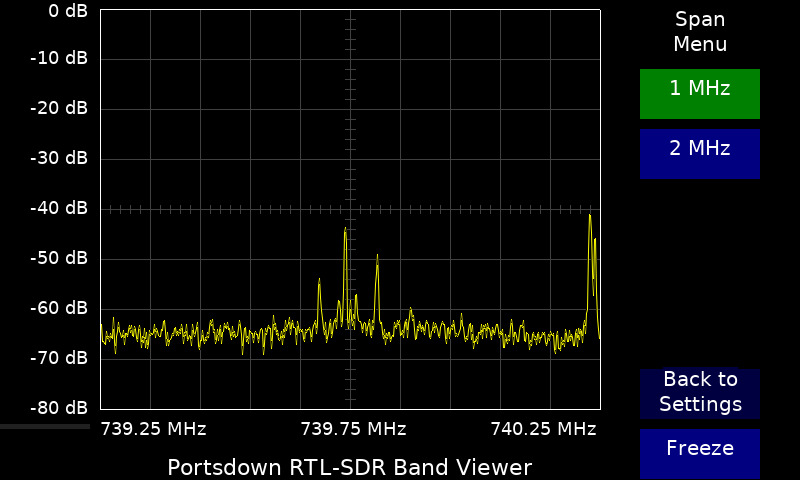

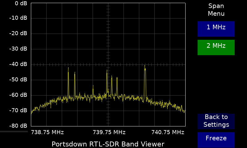

I've finally acquired a Portsdown4 and I'm exploring its many wondrous features.
With an RTL-SDR, the displayed bandwidths seems to be 0.5MHz and 1MHz, rather than the 1MHz and 2MHz values shown on the menu and graph.
This is version 202301020 with a 7 inch screen.

Hi Brian
Not sure how I missed this in testing - very embarassing!
I've reproduced the fault and will work on a fix.

Re: RTL-SDR displayed bandwidth.
Post by G8GKQ » Sun Jan 08, 2023 7:54 pm
Hi Brian
I have identified the problem. I left a testing setting in the final build. I will fix it in the next Portsdown update, but if you want to correct it in the interim, open the file /home/pi/rpidatv/src/rtlsdrview/rtlsdrfft.c and uncomment line 84 and comment out line 85, so it looks like this:
