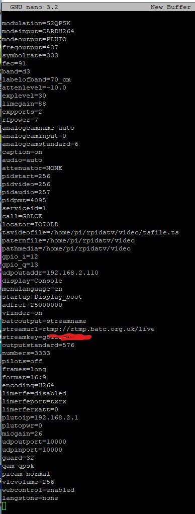

I have a spare RPi4 so used the Touchscreen remote control feature I think. BUT I updated without checking to the latest updated software and now cannot enable the web control. I have other Portsdown 4s and updated those to the latest firmware and they work from the remote touchscreen control but they also have screens. It is the one without a screen I cannot remote web control. And yes I have tried to enable it from the SSH console menu.
Martin G8LCE

Hi Martin
Please cut and paste the contents of the file
Code: Select all
/home/pi/rpidatv/scripts/portsdown_config.txt
here and then we can see what has gone wrong.

Had some trouble doing that! Hope I have got the right data...
Screenshot 2023-01-07 171229.jpg (98.68 KiB) Viewed 7354 times
Martin G8LCE

Posted: Sat Jan 07, 2023 8:16 pm
by G8GKQ
Martin
Please follow the instructions on the Wiki page that is linked in the first post about this capability. Particularly the section that details how to set up the Portsdown 4 to work without a touchscreen: https://wiki.batc.org.uk/Portsdown_4_We ... _Connected
I think that will solve your problem.

Posted: Sun Jan 08, 2023 11:01 am
by g8lce
Thanks Dave,
That was the reason.
Now to see what else I can do with a Portsdown 4.
