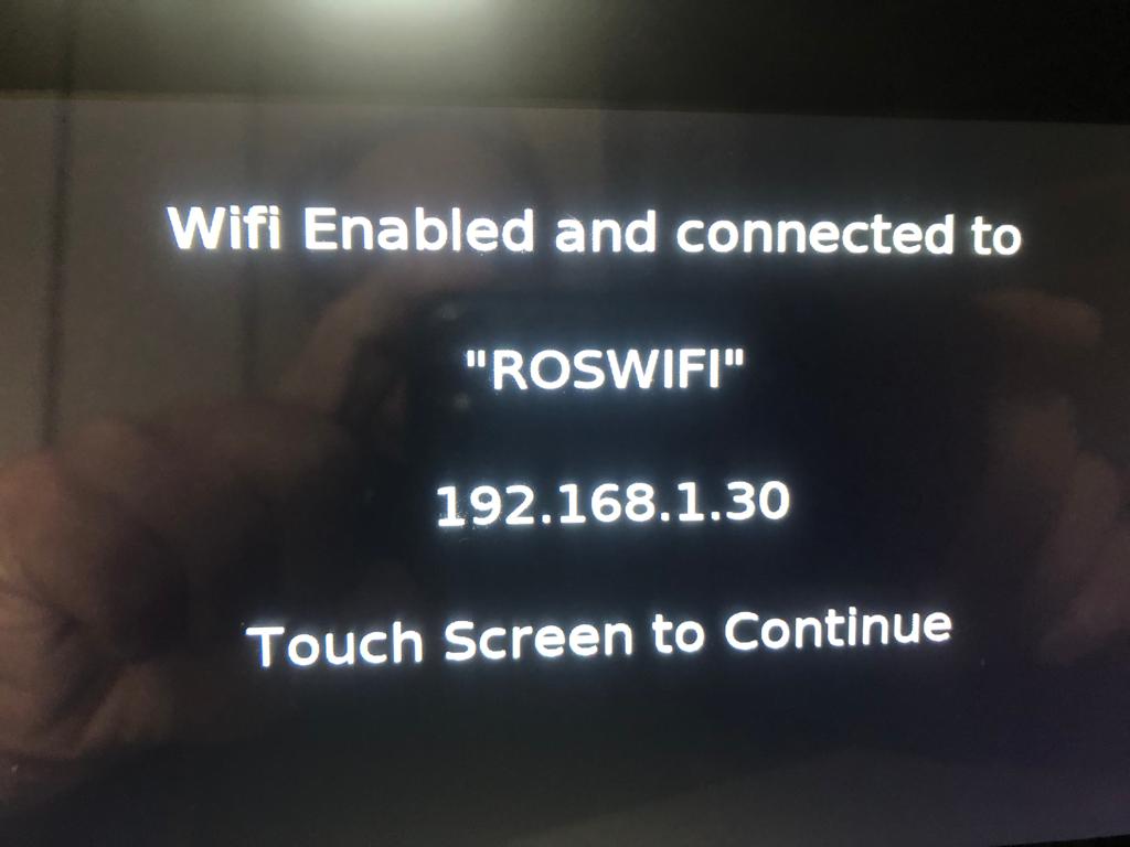

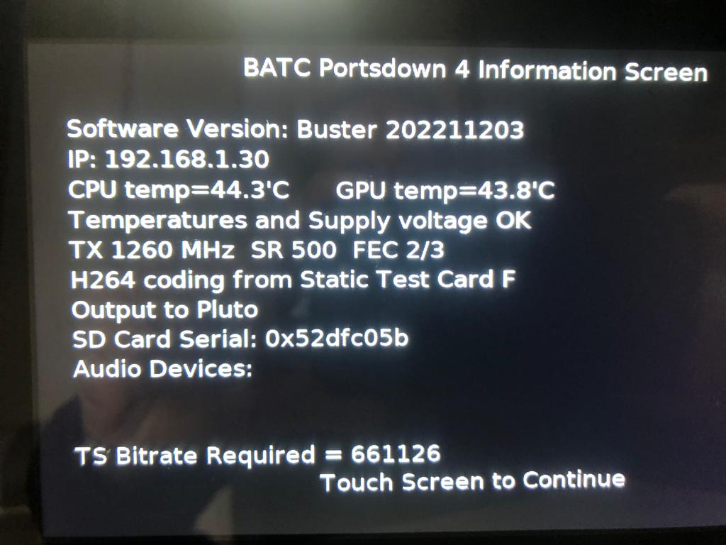

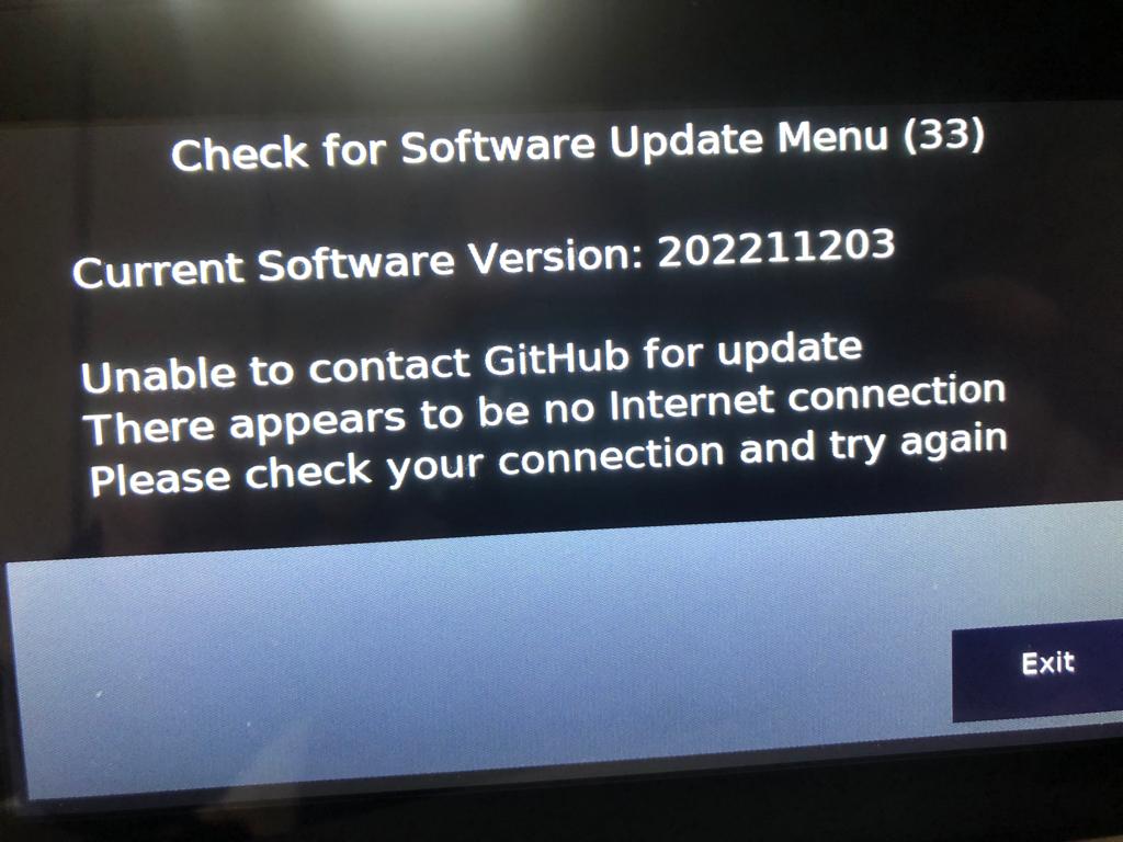

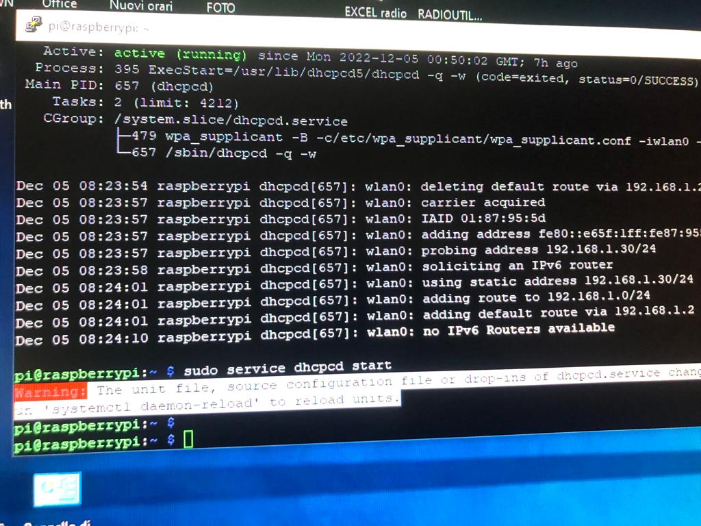

Good morning and thanks for reading me. I can't use the wi-fi despite having configured everything correctly (at least it seems to me). I have always used the network cable and now I wanted to try the WI-FI connection. I set the wi-fi network and Portsdown tells me that is connected and enabled, but if I try to download an update, Portsdown replies that it's not possible...I really can't figure out where I'm wrong..I also used the command
sudo nano /etc/dhcpcd.conf
to write the configuration file
interface wlan0
static ip_address=192.168.1.30/24
static routers=192.168.1.2
static domain_name_servers=8.8.8.8
interface eth0
static ip_address=192.168.1.31/24
However, everything works fine with the network cable ..
Thanks and 73 de i4wrm Ros

Thanks for the advice, much appreciated. Replying to Graham, I can't ping ..inside Portsdown and anyway I don't know how to do it. The problem is that with all the other devices (telephones, computers and various I have no problems.. my wi-fi network works fine). The raspberry wifi module works fine because it sees wifi networks and appears to connect. In fact the message I get from Portsdown is that the network is connected but in practice it doesn't work. Reply to Martin.. I also tried to receive streams from the various repeaters, and it only works if I plug in the cable. Differently in wi-fi "wating for stream ". I honestly don't know what to do anymore, even if all in all the system works fine with the network cable. In fact, I have to congratulate all of you at BATC because you've done a really good job. Thanks again 73 de i4wrm

You shouldn't need to play with any of the config files on the Portsdown to get WiFi to work on the Portsdown. I suspect that you may have an error in one of the edited config files that is causing a problem.
I would suggest starting with a new wiped card, and a new Portsdown build and then selecting the normal WiFi setup on Menu 3, WiFi Config.
If that does not work, I think that you may have a WiFi router or Raspberry Pi problem. So rebuild the card, start with a bare Raspberry Pi OS installation and see if you can get that to connect. If not, you should pose the question in the Raspberry Pi forum here: https://forums.raspberrypi.com/. If it does connect, then build Portsdown on top of it, and enable WiFi. That might work.

The only other thing that I can think of is that, during the Portsdown build, I replace the /etc/wpa_supplicant/wpa_supplicant.conf file with a new file with this content:
It may be that you need to change the Country Code, but I can't see why.

Good evening Dave..that could be it. In fact I don't understand how here in Italy we have the same problem. Is it possible to apply the country=IT change from ssh with putty ? 73 i4wrm RosG8GKQ wrote: ↑Tue Dec 13, 2022 3:55 pmRos
The only other thing that I can think of is that, during the Portsdown build, I replace the /etc/wpa_supplicant/wpa_supplicant.conf file with a new file with this content:It may be that you need to change the Country Code, but I can't see why.Code: Select all
ctrl_interface=DIR=/var/run/wpa_supplicant GROUP=netdev update_config=1 country=GB ##STARTNW ##ENDNW ##STARTN2 ##ENDN2
