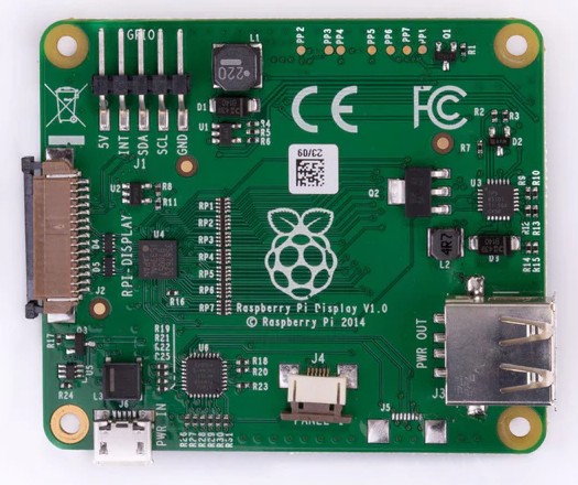

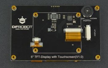

I should add that only two screens are supported on the Portsdown 4;
The official Raspberry Pi 7 inch which has a PCB like this:
or the DFRobot 5 inch that has a PCB like this:
No other screens are supported, even if they use the DSI interface and are 800 x 480 pixels.
