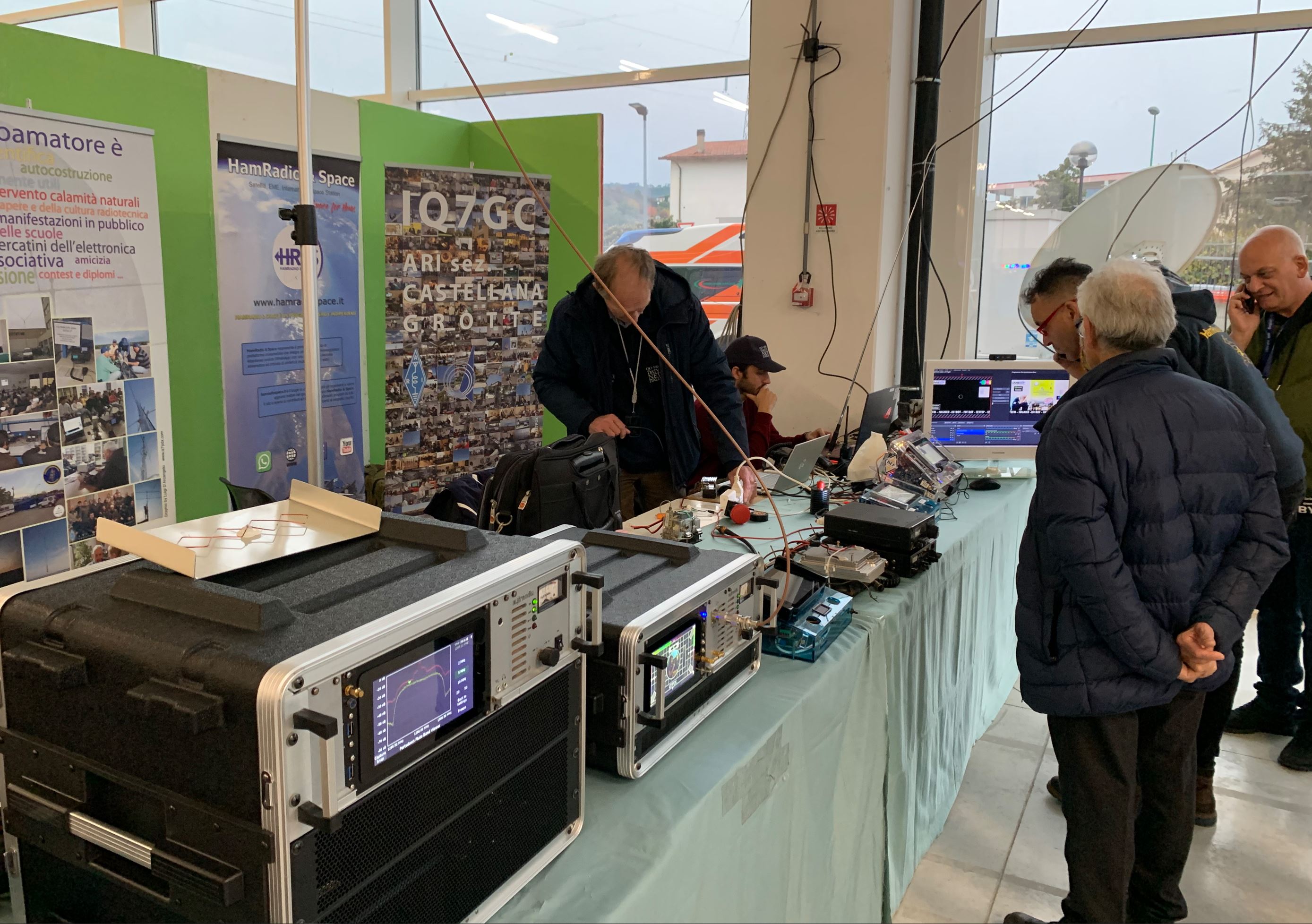

I got to show a smaller version of my Portsdown 4 at the Pescara fair (central Italy) and they were a huge success!
Portsdown 4 - All Inclusive DATV.JPG (667.9 KiB) Viewed 2828 times
