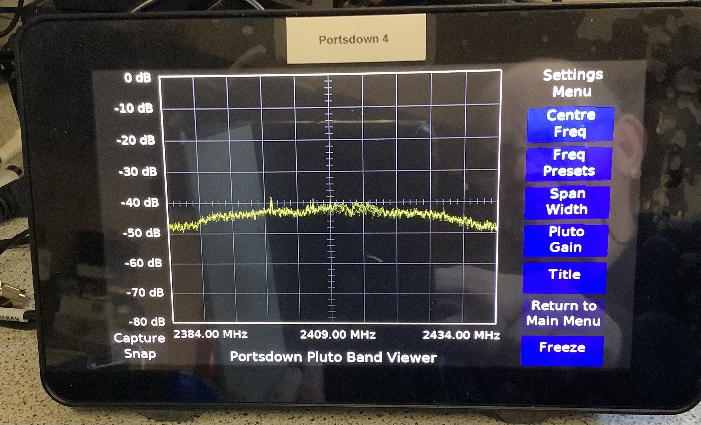

I have just released Portsdown 4 update 202211202 which includes BandViewer support for the Pluto SDR in addition to other enhancements:
  • In addition to the previously existing support for the LimeSDR, Airspy R2 and RTL-SDR, use of the Pluto SDR is now supported. This enables native coverage from 70MHz to 6GHz and less sensitive "5th Harmonic mode" coverage up to 30GHz. Full details here https://wiki.batc.org.uk/Portsdown_Band_Viewer
  • BandViewer screens can be viewed (with a 1 second refresh rate) in the Portsdown Web Control browser window. Simply enable Web Control and point your browser at the Portsdown's IP address. Note that this is view-only, so if you rely on web control you will be stuck in bandviewer and unable to exit without using the touchscreen.
  • The proof-of-concept for the Parkside Digital Multimeter Display (and future logger) in included. This allows the Portsdown to display and log readings from a cheap Digital Multimeter that is seasonally available from Lidl in the UK and Germany. Full details here: https://wiki.batc.org.uk/Portsdown_DMM_ ... and_Logger
  • Lastly, the recommended base operating system for new builds has been amended to the latest Buster Legacy release, 2022-09-22.
Please report any problems found here.
