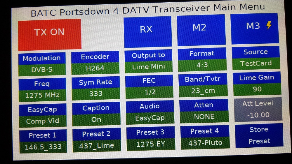

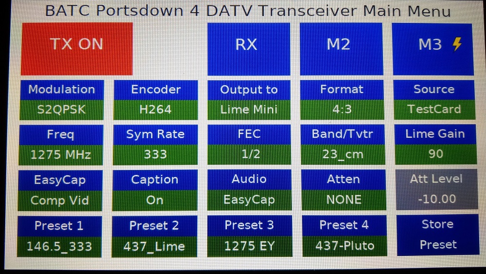

Recently updated my Pi3 Portsdown to a Pi4, downloaded the current Software, loaded the card and yippee! Or so I thought..
Everything worked OK on the Pi3 2020 Software but I can't get the Pi4 to Transmit in DVB-S modes.. If I change to DVB-T then the little LED on the Lime Mini gets all excited after a few seconds and I get RF output.
I have tried different Frequencies, different FECs, Different Symbol Rates... But in DVB-s or S2QPSK, the Lime LED continues at it's same lazy rate and no RF.
I recently found that it needs an Audio source to be able to transmit but even with the EasyCap or my little USB camera connected it still doesn't give any RF output.

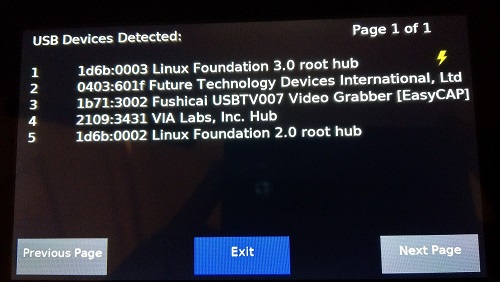

Something wrong with your supply voltage, hence the lightning symbol.

The yellow lightning symbol indicates that there is a power supply issue. If you go to Menu 2 and select the 'Info' button it will confirm that you are having a power and possibly a temperature issue.
The RPi 4 requires a slightly higher voltage than the RPI 3. The recommended power supply has 5.1 Volts at 3 Amps. The RPi 3 was rated at 5.0 Volts.
The RPi 4 does get hotter and a fan for cooling is recommended.

The supply is already set (and measured) at 5.2V, any loss is due to (supposedly) well rated Power Lead.
The flash isn't there all the time but I will check what the supply voltage is at the Pi itself.

Hi Wolfgang, yes I do use the shutdown button.
I powered the Shack 5v from a variable supply and finally saw off that Lightning bolt properly. It still wouldn't go into Tx.
Then somewhere in the Forum this aft while at work I remembered seeing something about a H264 problem, sure enough changing to MPEG does the trick, I can now see that Lime LED get all interested the Lime goes into TX (even with a Lightning bolt)..
