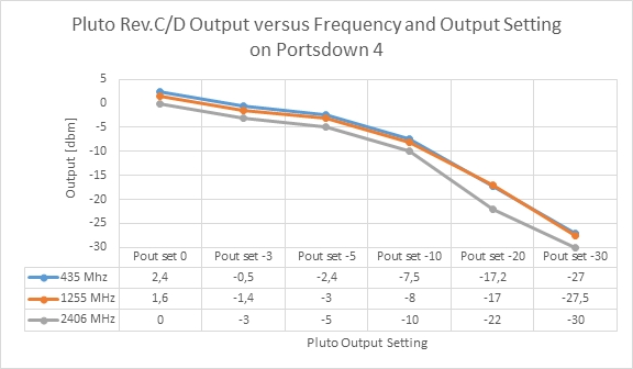

Furthermore tested the Pluto Rev.C/D output being controlled from Portsdown 4 Pluto PWR setting. (M1)
Digramm output.jpg (55.8 KiB) Viewed 5871 times
Suggest to amend the wiki to differentiate between the 2 Pluto versions in the market and to reflect the additional frequency extension input necessary for Pluto Rev.C/D in the write-up.
