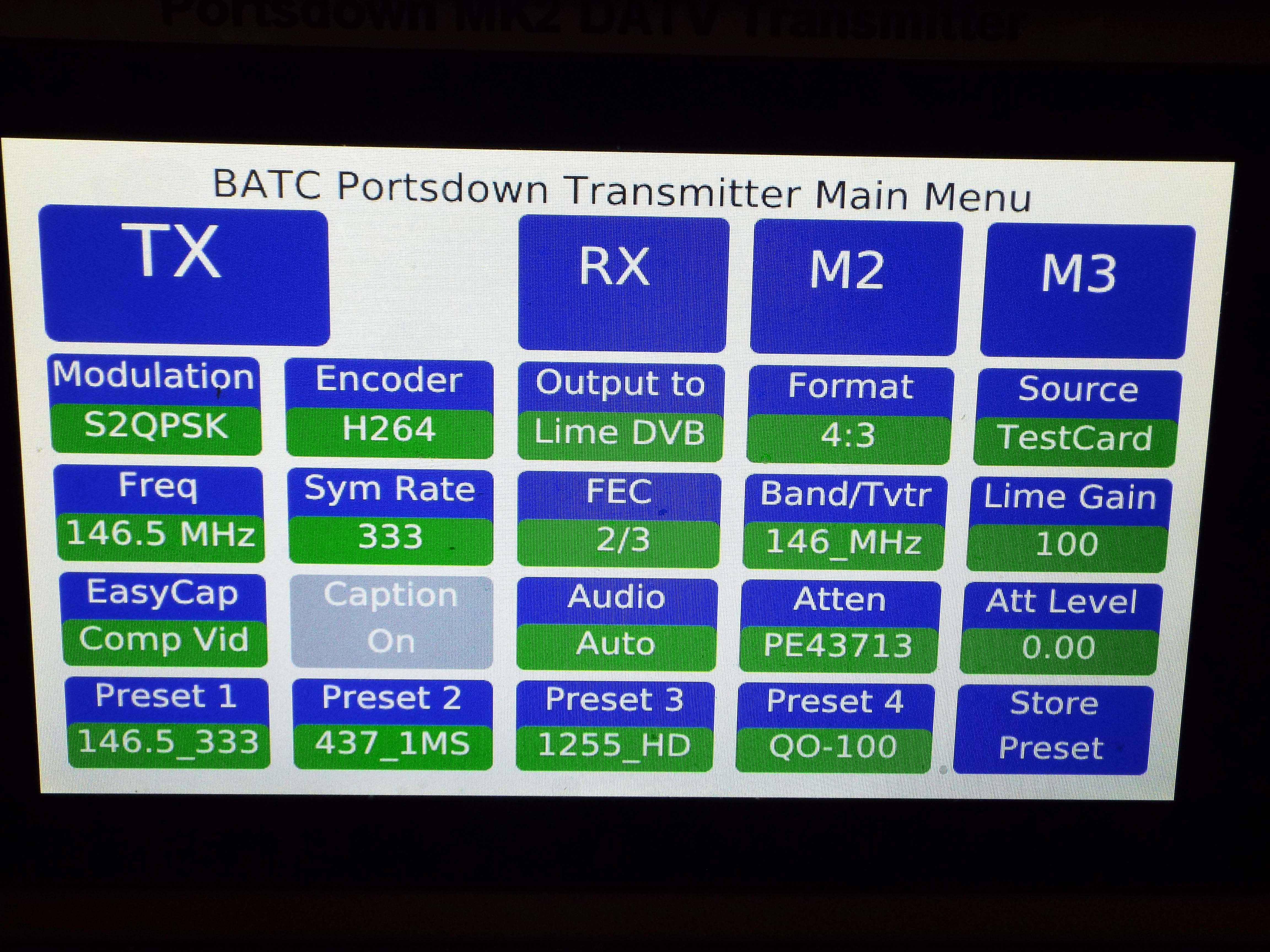

Just updated my Portsdown 2020 from (version Buster 202010180) which is very old.
Rather than update the existing card I built a new one (version 202207170) and swapped the SD cards.
Now I get no modulation when H264 is selected in menu 12 when using S2QPSK or DVB-S and when using source as TestCard and Format 4:3 (No signal on spectrum analyser).
Modulation OK when MPEG-2 is selected.
What am I missing here ?

Hi Dave,
SR 333 and FEC 2/3 with Lime DVB on 146.5MHz.
I'm sure this worked with the old version I had as I was checking outputs a few days ago on the spectrum analyser.
Maybe I have missed a setting somewhere.
Screenshot
Screenshot
Nick.
