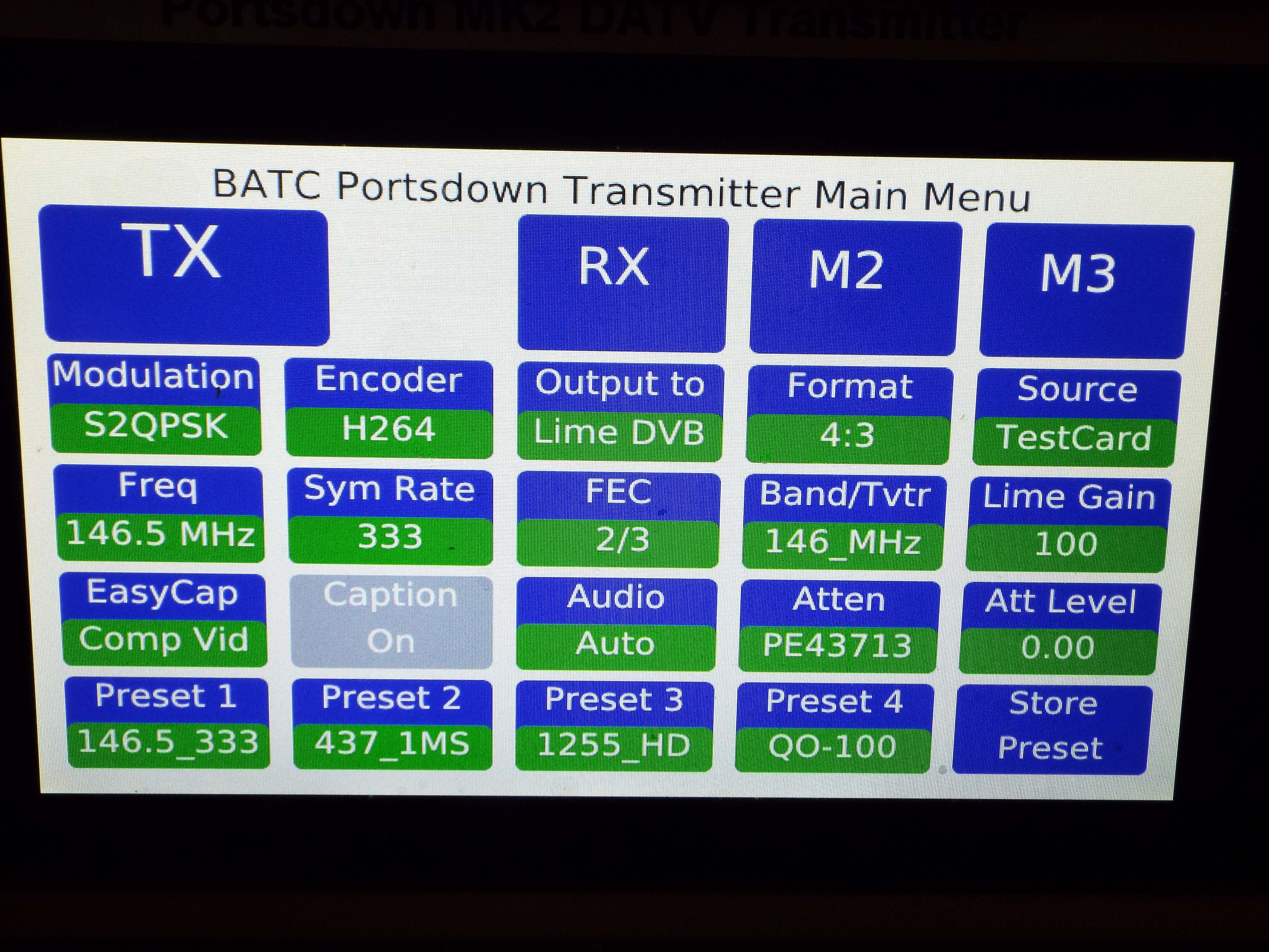

Now I get no modulation when H264 is selected in menu 12 when using S2QPSK or DVB-S and when using source as TestCard and Format 4:3 (No signal on spectrum analyser).

SR 333 and FEC 2/3 with Lime DVB on 146.5MHz.
I'm sure this worked with the old version I had as I was checking outputs a few days ago on the spectrum analyser.
Maybe I have missed a setting somewhere.
Screenshot
Screenshot
Nick.

That should work. It could be that there was a problem (GitHub or internet outage) during the build.
Please try an update. From Menu 3, check for update and then force update.
