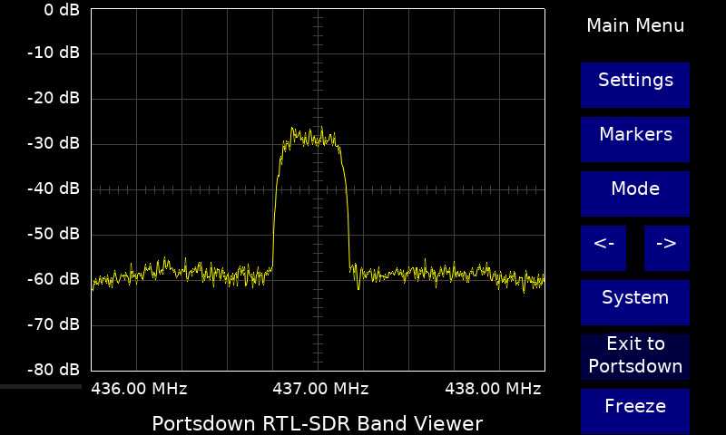

I have now added the facility to use an RTL-SDR with BandViewer on the Portsdown 4.
The only available span widths are 2 MHz and 1 MHz, but these enable you to "see" a DATV signal well before it can be decoded by the DATV receiver. The dynamic range is not as good (only about 43 dB) as the Airspy or LimeSDR, but just remember that the price is over 10 dB lower!
If you select BandViewer from Menu 2 or the Terrestrial Receive Menu, the Portsdown first checks for an Airspy and uses that if connected. If not, it checks for a LimeSDR, and uses that. Lastly it checks for an RTL-SDR and uses that. You can also select RTL-SDR Bandviewer directly from the Test Equipment Menu.
To get the new capability, simply perform a software update to version 202207150. I hope to migrate this capability to the Portsdown 2020 soon.
Please report any bugs here.
Lastly, thanks to Alexandru Csete OZ9AEC for his "Rtlizer" which provided a good starting point for this project.
Dave G8GKQ

- rtlsdrbv.jpg (75.78 KiB) Viewed 7301 times
