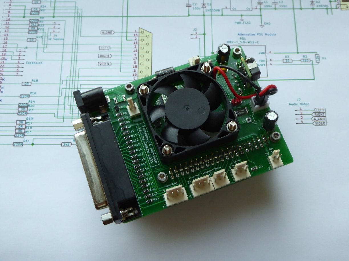

Posts: 2741
Re: Optimum supply voltage?
Post by g0mjw » Sat Jun 04, 2022 9:56 pm
This sort of thing ?
g3yjr
Posts: 82
Joined: Sat May 23, 2020 1:37 pm
Post by g3yjr » Wed Jun 08, 2022 12:07 pm
Very natty with the fan Mike!
I'm sure I have a board somewhere...
73 Graham
