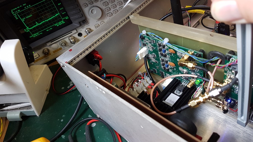

Who can tell what the name or spec of the two row connector on the ADF4351 synthesizer is please? I made a replacement for the first faulty one I had using two JST connectors trimmed and back to back. But this has gone loose. It's stopping the completion of the G8TA centenary Portsdown 2020 :( . I don't want to make another bodged connector. Help please.

Pressing the connector to get a signal

Hi David
It’s a standard 0.1 inch pitch 2 by 5 header. I normally use salvaged ribbon cable connectors, but have also soldered directly to the pins on one unit.
