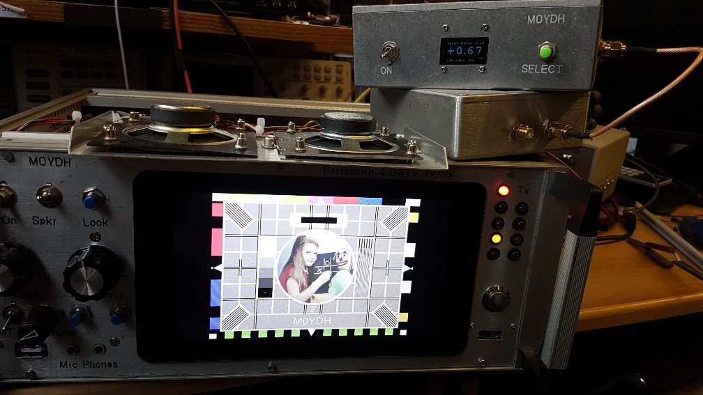

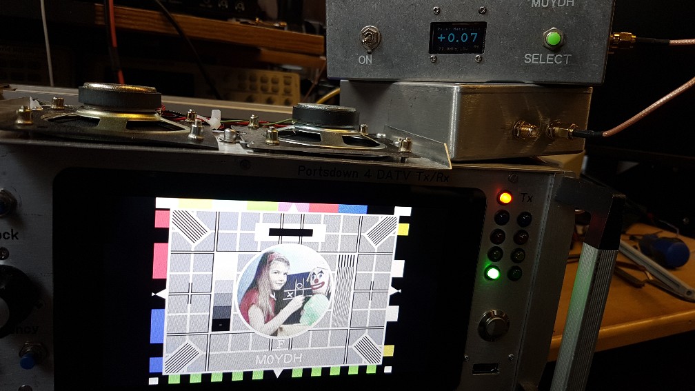

I've been getting ready for the 4m and 2m activity weekend. Amps are all overhauled and tested with the ever-reliable Portsdown 2018. They're set up to put c.30mW into their Mitsubishi modules off 4mW from the Portsdown. I put the Portsdown 4 in the rack and connected everything up. No output power on 4m and 2m. 70cm working and nothing from the new 23cm amp.
This was with the 11 April release. I did some power measurements at the Pluto TX port.
0.07mW on 71MHz
0.67mW on 146 MHz
3.6mW on 437MHz
around 5mW on the spectrum analyser on 1255MHz
My other Pluto was the same. Pluto pwr is 0 all bands and both have correct firmware according menu 3.
I did the update to 24 April release and there was no change. Oh dear. My nice power meter with a Makis device has gone poorly so back to the Heathermeter.
Regards
David M0YDH

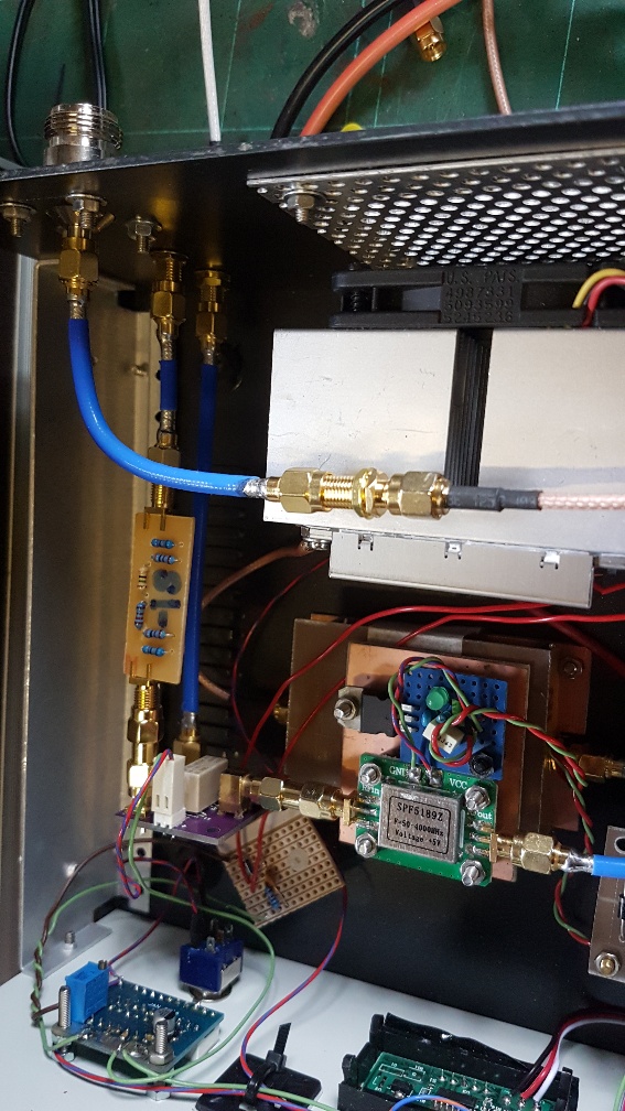

I've modified two of my PAs to have an extra input and a RF relay so I can connect either a microwatt Portsdown 4 or a milliwatt Portsdown 2020. Pluto power or attenuator values respectively have been adjusted to give c. 15W from the PA. The 70 microwatts on 71MHz is the last challenge in this saga. My thanks to Mike G0MJW for the relay pcb Gerbers. Very neat replacement for hard to get Minikits RF relays.
David M0YDH
