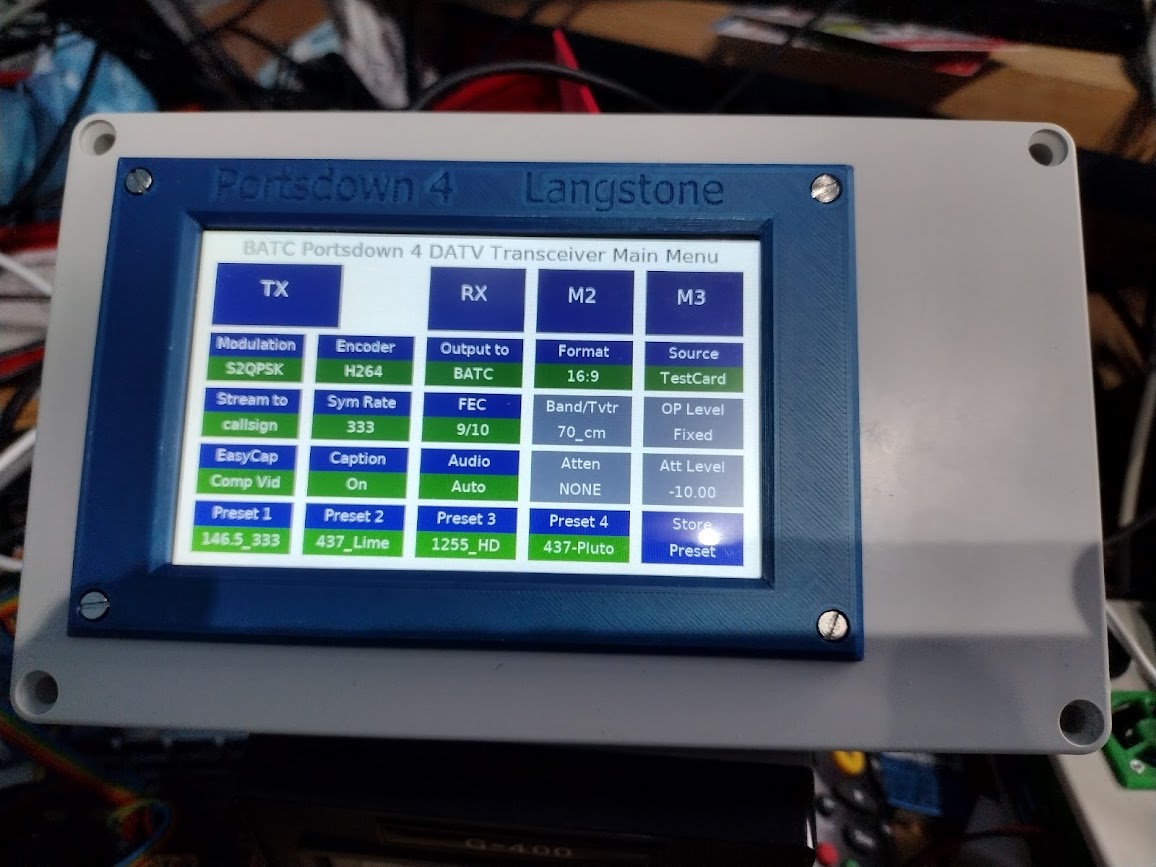

Screen in and still works.
Now got to mount the PiHut Heatsink back on some short standoffs for the back of the box. No point bolting it down as it won't be able to sink heat.....

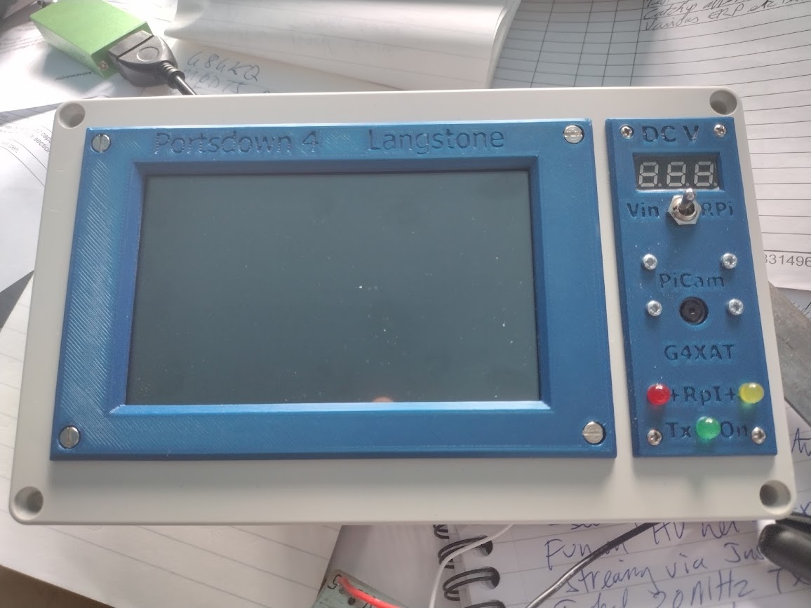

by radiogareth
Bit more progress today with the side panel designed (well, modified from my earleir PD4), printed and fitted.
Having sight of Vin and VPi shows adequatre supply and the built in PiCam means I can always offer 'local video' for when I leave the C920 behind....
PSU (eBay buck converter) and some sort of audio amp/speaker plus small fan and vents for the back part, plus a 'closing contact' relay for external amp control.

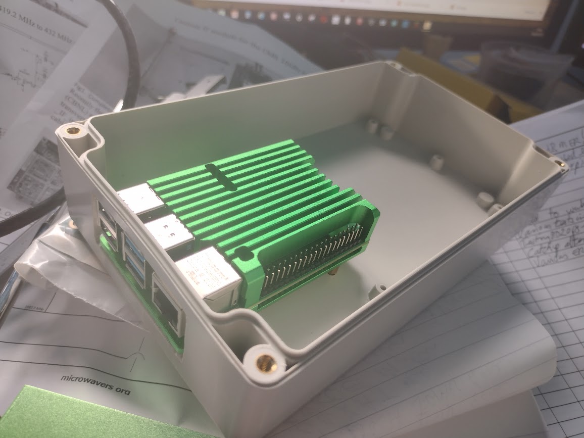

by radiogareth
A PiHut "Aluminium Armour" (https://thepihut.com/products/aluminium ... berry-pi-4) was recommended as a good way of cooling it and shutting up any RF interference it may emit. External access to all the USB and RJ45 on the side.
Aluminium armour RPI4.jpg (120.69 KiB) Viewed 3602 times
