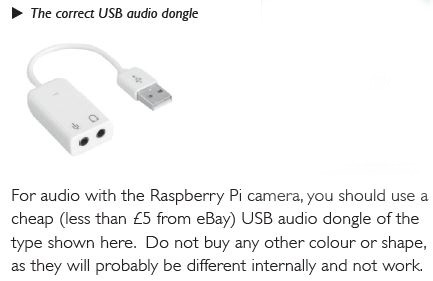

Post by G8GKQ » Mon Nov 08, 2021 12:37 pm
Pierre
The Portsdown is designed to work with the recommended hardware. I simply do not have time to support non-recommended hardware. You have identified one file where the change would need to be made; in fact it would need changing in about 10 files. The correct audio dongle was clearly specified in CQ-TV 271 and they cost less than 5 Euros each:
Audio Dongle.JPG (51.58 KiB) Viewed 5251 times
The same principle applies to the Ryde receiver and the Langstone transceiver: ONLY USE THE RECOMMENDED HARDWARE!
Sorry to be blunt, but there are only so many hours in the day!

Hello Dave,
Of course I understand your point of view. I just ordered the dedicated sound card. Now will wait for it.
