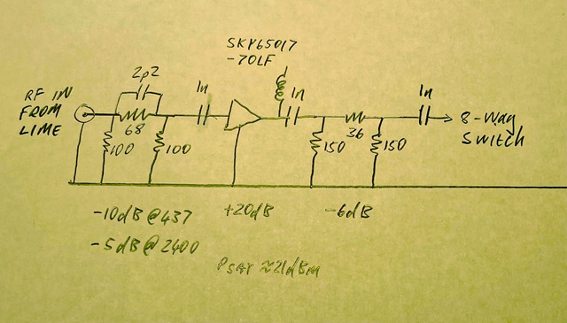

I have designed and tested a new input circuit for the 8-way RF switch which should protect the RF switch IC. I have put a 6 dB attenuator after the MMIC so that the maximum input to the RF switch IC is +15 dBm, not +21 dBm. To compensate for the loss of gain I have reduced the input attenuator values. The overall gain of the modified switch PCB is about 3 dB, but rises to 5 dB at 2.4 GHz (where the Lime output is much lower).

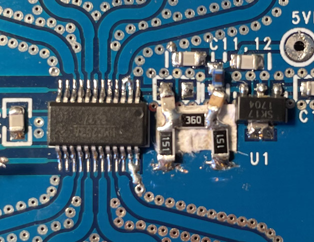

The revised circuit is below. The surface mount components for the new attenuator were soldered together on the top of the PCB. I scratched away the insulation where I needed a ground connection, and put an insulation sheet inder the other connections. I have also attached a table showing the maximum levels and gain at various frequncies. While I was at it, I measured the Pluto output level to check that it was within a safe range.
