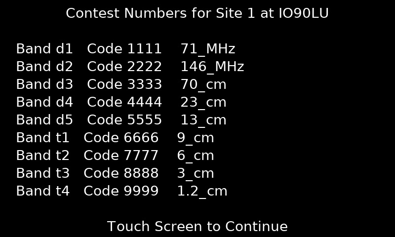

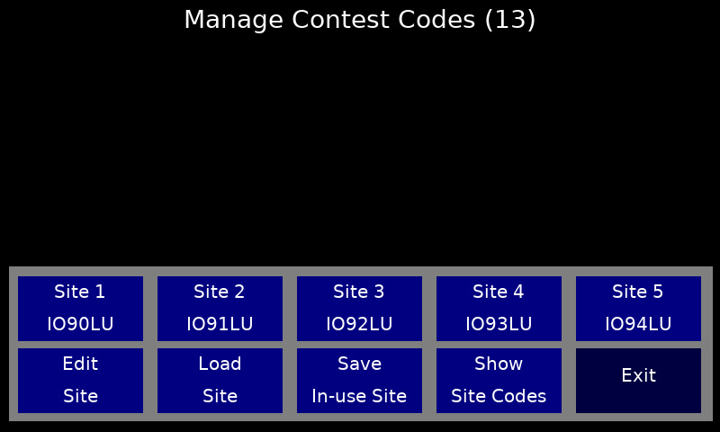

The first feature is the ability to create up to 5 sets of Contest Numbers, each tied to a specific location. So you can create the sets of Contest Numbers before leaving home and switch between them easily when you move sites during the contest. To access, go to: “Menu 3”, “Set Call, Loc & PIDs” (remember this is locator-based), “Set Contest Codes”.
  • To set up a set of codes, select “Edit Site” and that button will turn Red, indicating that you should select the Site that you want to Edit. So select Site 1 and then enter or confirm the locator for Site 1. Then it will ask you to enter the numbers for each of the 9 bands in turn. At the end, the numbers will be stored against Site 1. You can repeat the process for each of the sites.
  • To view the codes, select “Show Site Codes” and then select the site. All the codes will be displayed on one page. Exceptionally, you can also view the in-use codes by selecting “Show in-use Site” which appears when “Show Site Codes” is selected.
  • All the editing is Off-line, so to load a site’s codes (and locator) for use, you should select “Load Site” and then select one of the Sites.
  • If you want to save the codes (and locator) that you are currently using, select “Save In-use Site” and then the Site Button that you want to save it to.

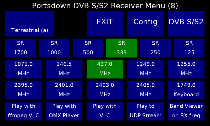

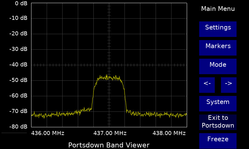

The second feature is a number of improvements to the Band Viewer https://wiki.batc.org.uk/Portsdown_Band_Viewer, including the ability to go directly from the Portsdown Receiver Menu (in terrestrial mode) to the Band Viewer with it pre-tuned to the current receive frequency.
