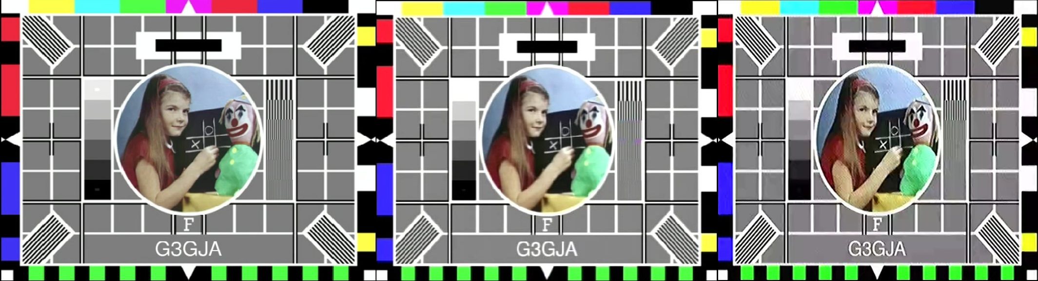

The problem appears to get progressively worse as the content moves through the system. See the graphic below. System for this test comprised of a Portsdown 2020 using the internal testcard transmitted to GB3EY, received on its Ryde Receiver and retransmitted by a DTX1. The Porstdown Streamer captures the video feed to the DTX1.
Input and output RF captures were monitored by Minitioune. Screen shots were taken of both and the Streamer output and then the three images stitched together and their height normalised to 576 pixels without altering the aspect ratio.
Aspect ratio comparison.jpg (192.8 KiB) Viewed 2496 times
Left hand pictured as transmitted @ 1.33:1 Middle picture as seen relayed by GB3EY @ 1.21:1 using Ryde Rx and the right hand shows the Streamer ouput. The aspect ratio is now 1.13:1 or pretty much square.
It seems to me that there are two stages of aspect ratio distortion in play here; firstly in the Ryde Receiver and secondly in the streamer chain. I'm assuming that the DTX1 doesn't add to the mix here. I've not seen any evidence that it does.
