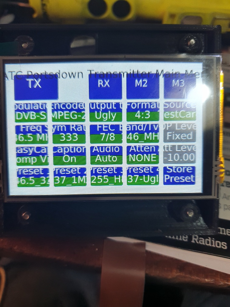

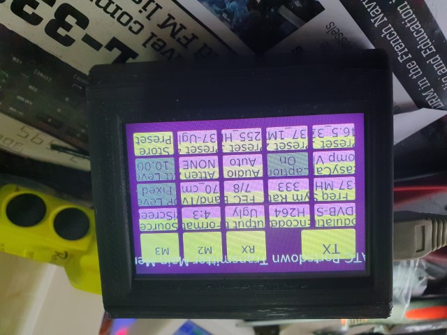

just building another portsdown 2020. I have just done a new card. all works but display is in negative\inverted
ive gone in via ssh and changed it to a B it wont work put back to A it works but inverted

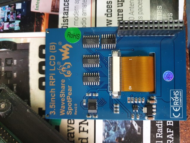

there seems to be some update by waveshare for the display
https://www.waveshare.net/wiki/3.5inch_RPi_LCD_(B)

i have tried this
Next step reinstalling the driver for the OLD version according to the instructions WaveShare.
git clone https://github.com/waveshare/LCD-show.git
cd LCD-show/
sudo ./LCD35B-show-V2
the colour is right but fonts too big

There are only 2 displays supported for the Portsdown 2020: The WaveShare 3.5 inch Model A and the Official Raspberry Pi 7 inch. As stated here: https://wiki.batc.org.uk/Portsdown2019_ ... ouchScreen
The original WaveShare 3.5 inch Model B only worked because someone gave me full details of the modifications to make it work and I was able to incorporate them. If you were to do the same with the updated WaveShare B, I could incorporate the new display in the Menu. Otherwise, I suggest that you buy the correct display.

I thought I was getting the right display. seems to be a shortage of A's seems to be the New B version
going to find an A version
but what i have twiddled with playing
in the config.txt as well as the drive upgrade prev posted.
im playing in the dark as this is not what i normally do. but you dont learn unless you play
