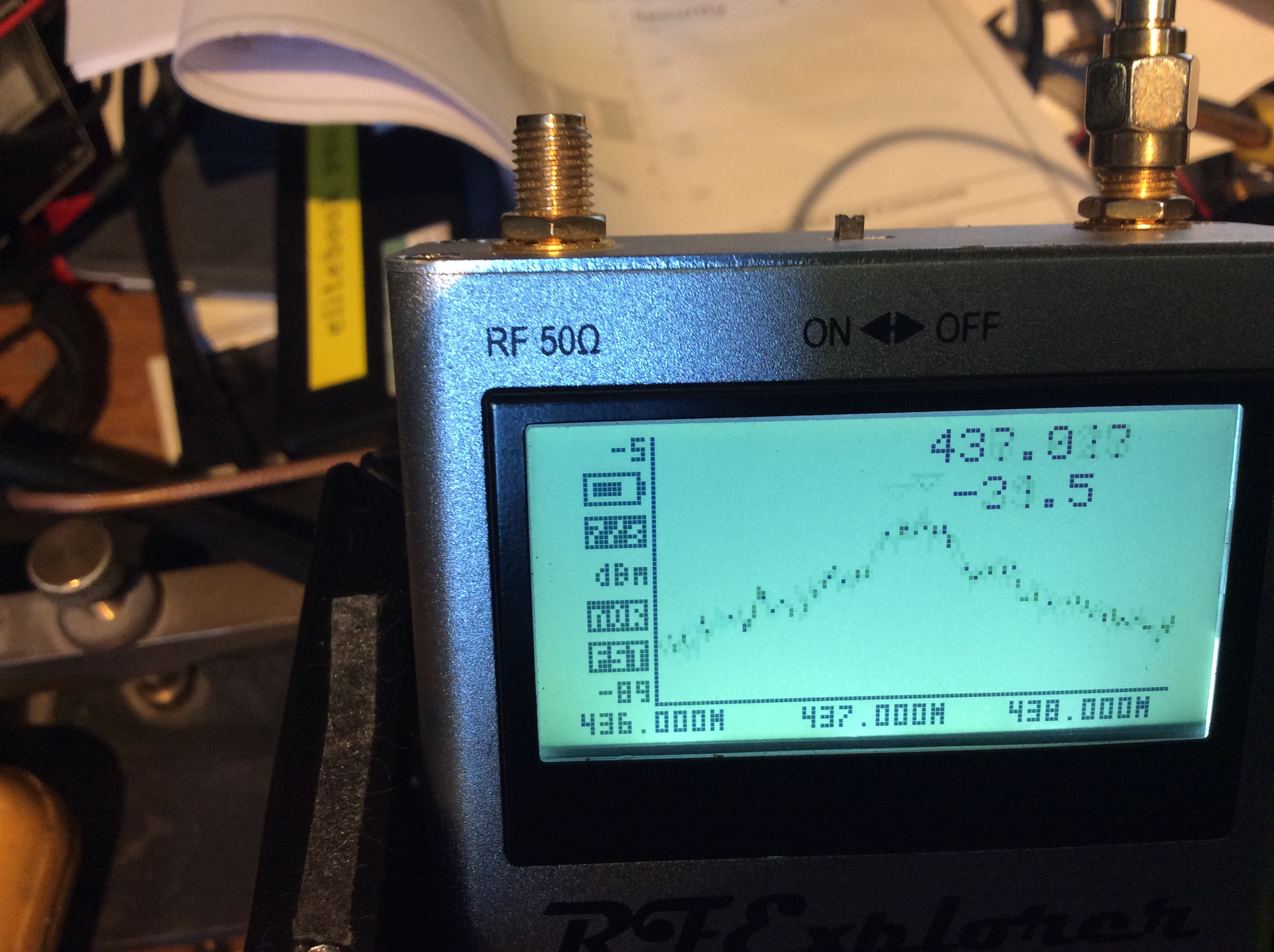

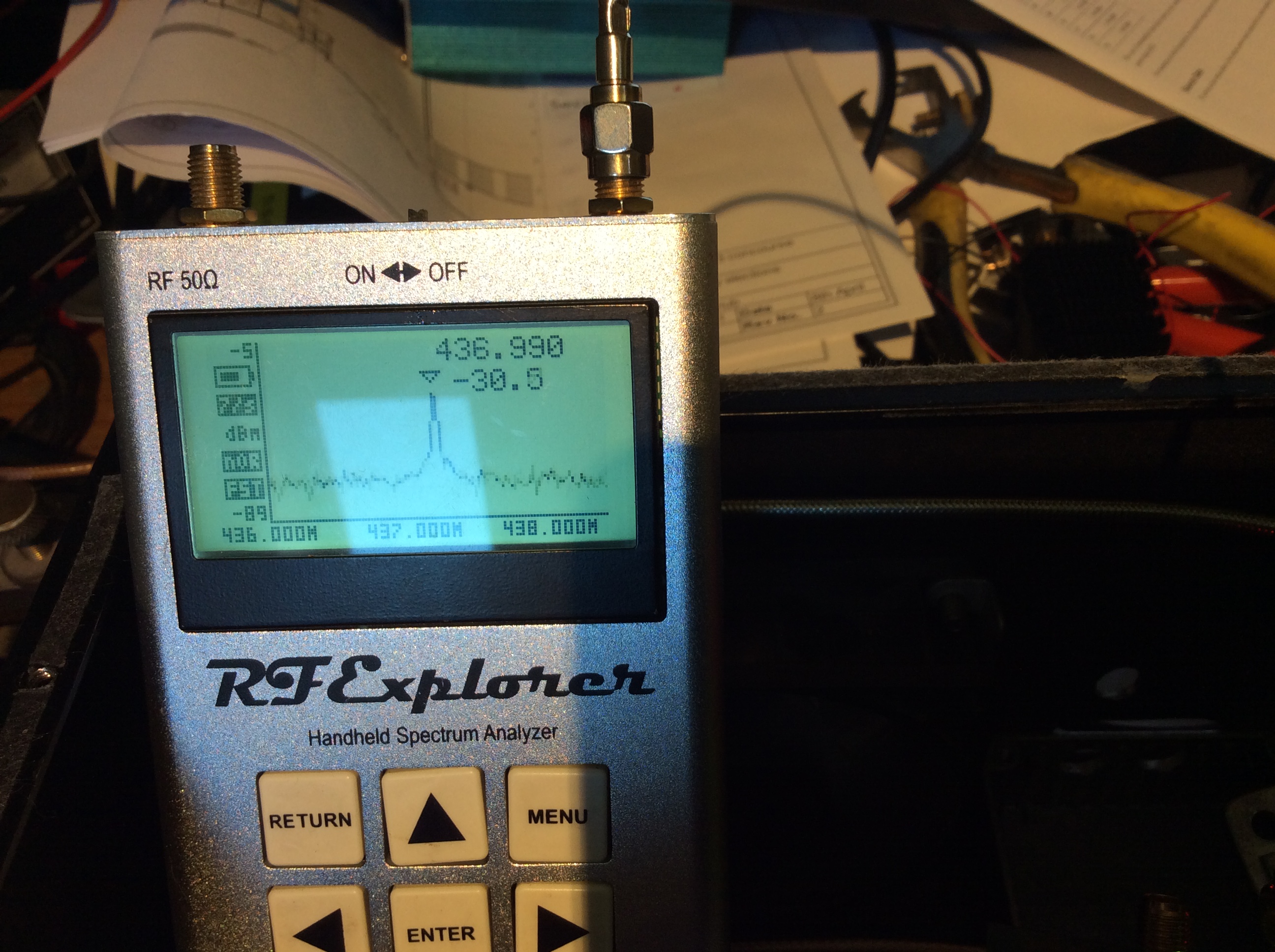

I’ve attached pictures of my output initially, the big wide form and after either seconds or a minute I get the sharp one. Same thing happens with 500kbs, flat top mountain for a bit then spike.
- Sr 250
- 6DA24E9C-D094-4242-B7D6-1A87E47D6BF3.jpeg (1.25 MiB) Viewed 4226 times
- Sr250
- 37E4C549-3C6B-47DA-B11D-AAE93C044638.jpeg (1.24 MiB) Viewed 4226 times

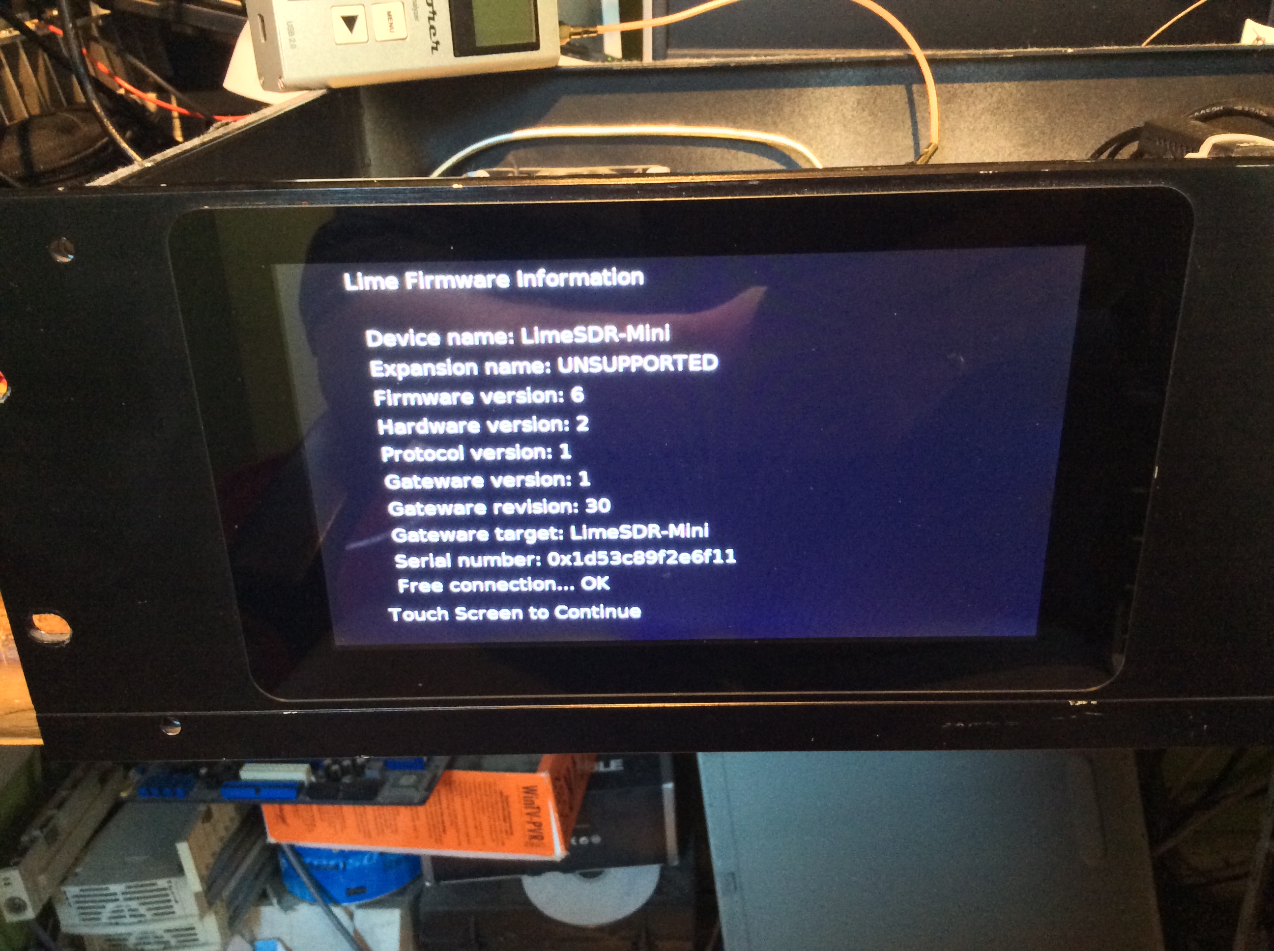

I loaded my original lime mini with v1.30 via portsdown, then loaded the DV’s version. Not working so tried to reload v1.3 portsdown reported unsuccessful. I put the lime onto the pc and using lime suit got the info. It said no gateway nothing only it was a hardware v2. At this stage the lime had a steady green led.
Used program and it did its thing and loaded v1.3 with all the other fields looking correct.
Put the lime back onto the ports down and asked it for lime info and all fields zero tried the upgrade got the unsuccessful again?.
Went to lime fw info and it says no device available, replugged it and have as shown in photo back to where I was so it goes into TX but the signal isn’t far above the noise and I’ve shoulders. Changing the power level doesn’t seem to make any difference to the output, also signal collapsing again.
