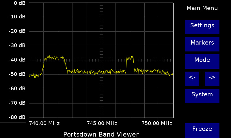

I have just released a major update to the Portsdown 4 software. It brings in a number of long-overdue bugfixes and also some new features.
The headline new features include DVB-T transmit using a LimeSDR (previously only available on a Portsdown 2020) and a band viewer using the receiver in the LimeSDR. Details of the Band Viewer are here: https://wiki.batc.org.uk/Portsdown_Band_Viewer and I have included a screenshot below.
The headline bugfix is that 1.7 MHz DVB-T receive has been made to work. There are also a number of changes to improve reliability when using the Pluto. The full changelog:
