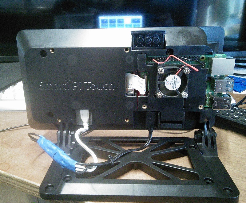

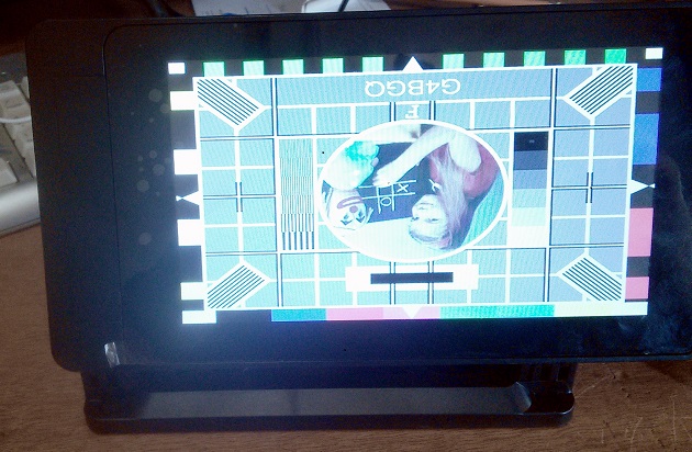

I have my correct Pi4 display working but the image is upside down. The stand is assembled correctly, see image.
How to I rotate the image.

Menu 3, System Config, Invert 7 inch.
Re: Portsdown 4 display
Thank you, everything works a treat.

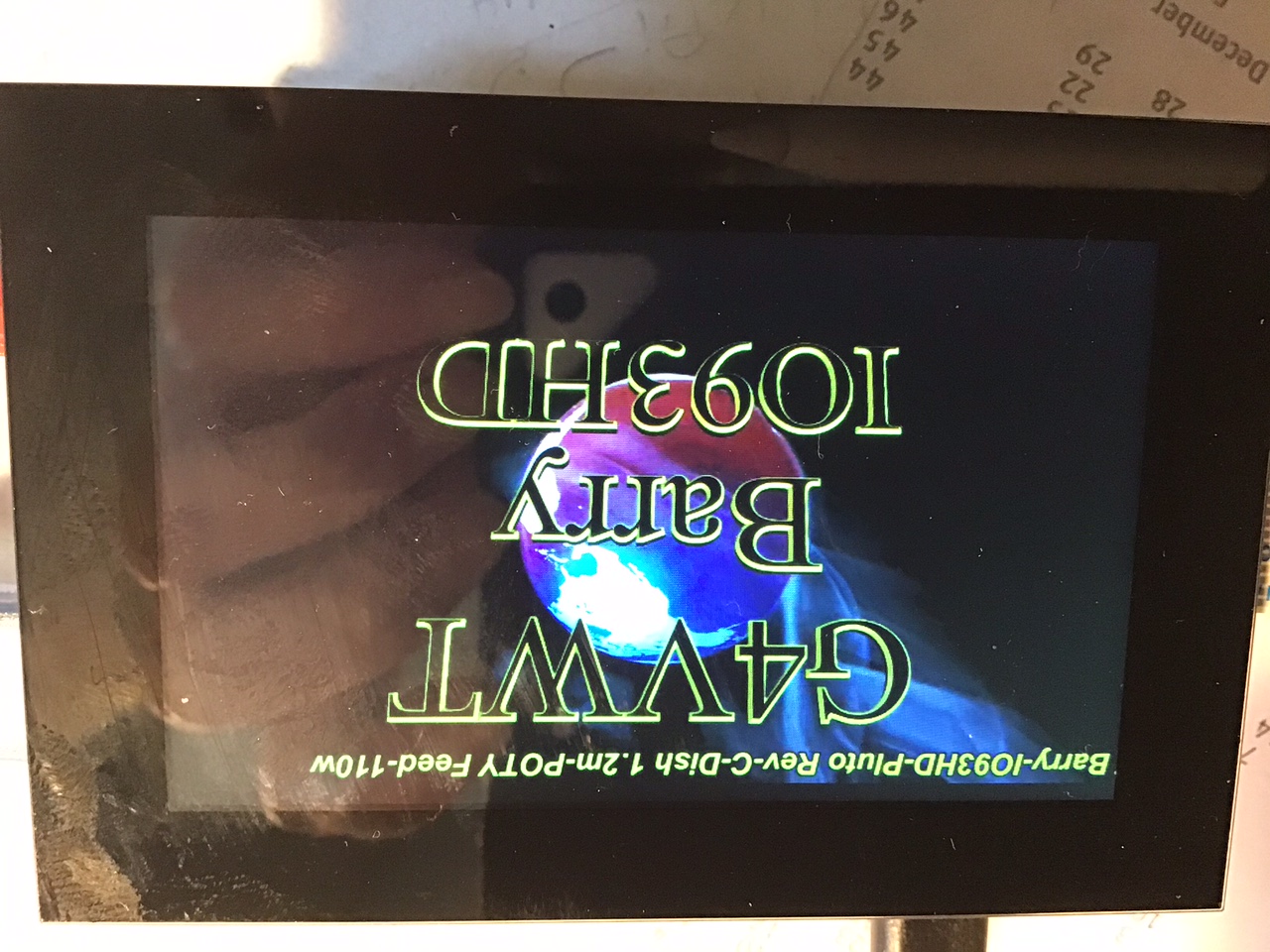

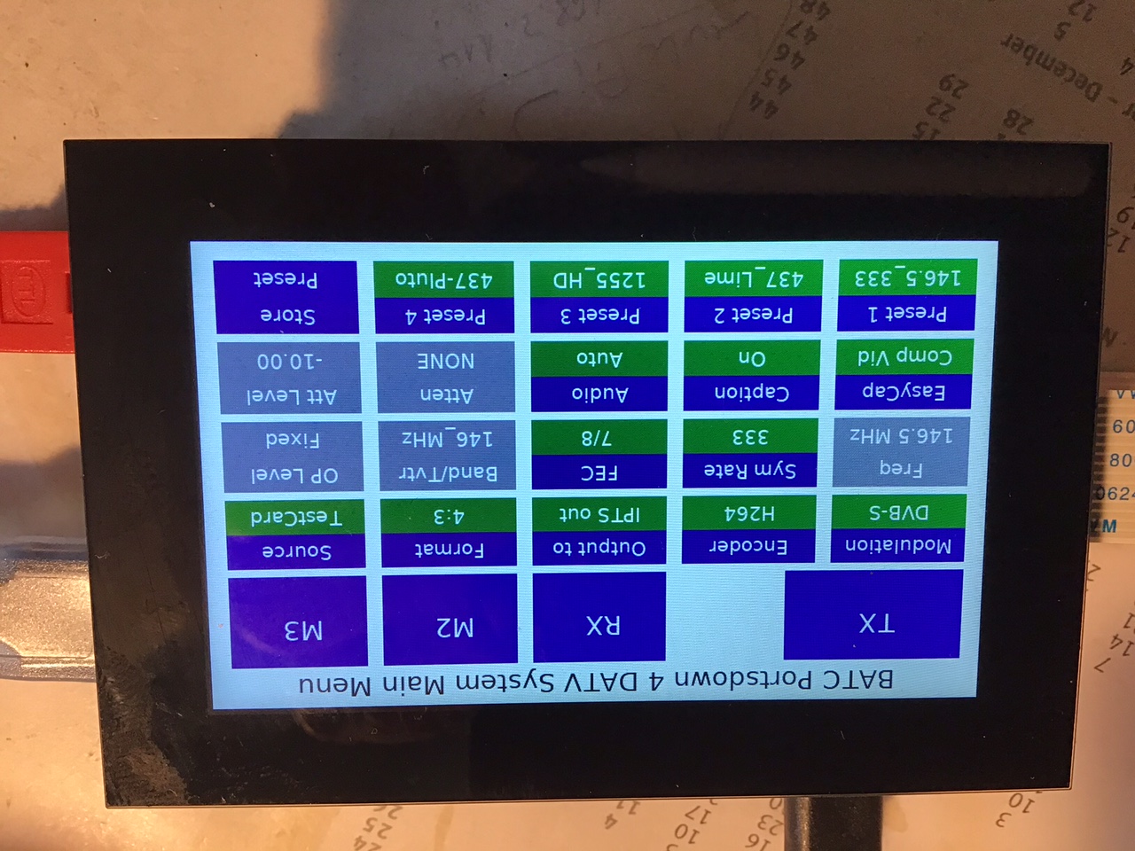

Incidently I came across a 3,5" display with a Raspi DSI interface on Amazon's: OSOYOO 3.5 Inch DSI... I thought its worth a trial using Portsdown 4 with the result that the display works.
Handling the "big"buttons is no problem, handling the "virtual keyboards" is a matter of patience and is cumbersome. These inputs can be better worked from the console menu.
Note: the manufacturers settings in Portsdown 4 must be modified to "invert display" (Menu 43). Otherwise there is no congruence given between the graphic display and the button pattern. I did that with the 7" Raspi display connected to the Raspi with Portsdown 4 and afterwards exchanged the display to 3,5".
