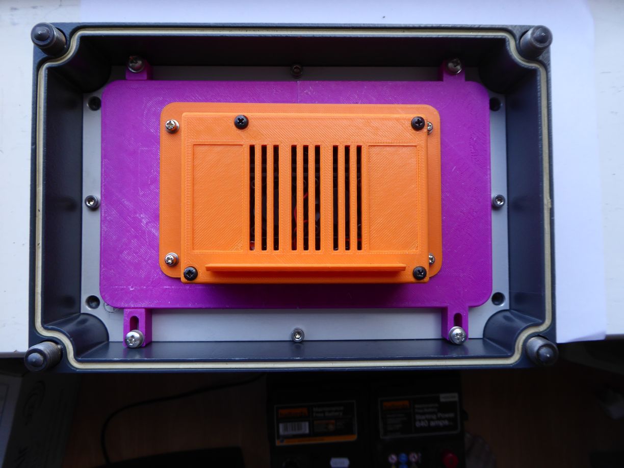

you will only need to cut out the main hole in the middle and drill 4 holes for mounting.
Noel PM me your address I can print you one for free
the panel is sandwiched between screen and aluminium panel

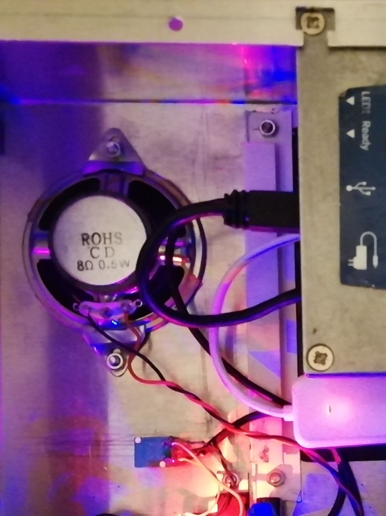

I went for the quick and easy solution. I cut a hole in an ali budd chassis just big enough to see what needs to display and held each end in place with some plastic U channel from B and q with two M3 nuts and bolts. I avoided metal strip as i knew it would crack the expensive display
This has worked fine, including field trip on my Portsdown 2020, PiHPSDR and Langstone.
Having the display edges touching the chassis has not affected touch capabilities Langstone mount picture attached

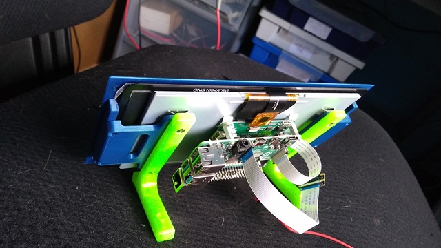

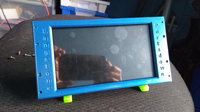

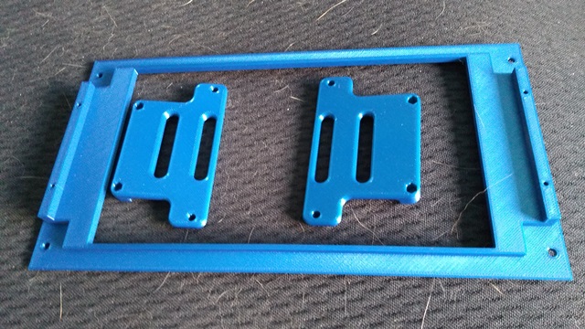

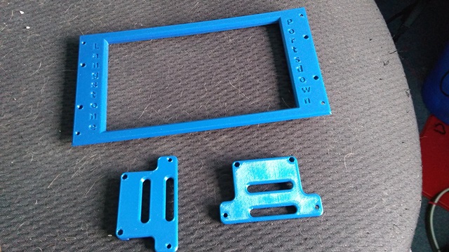

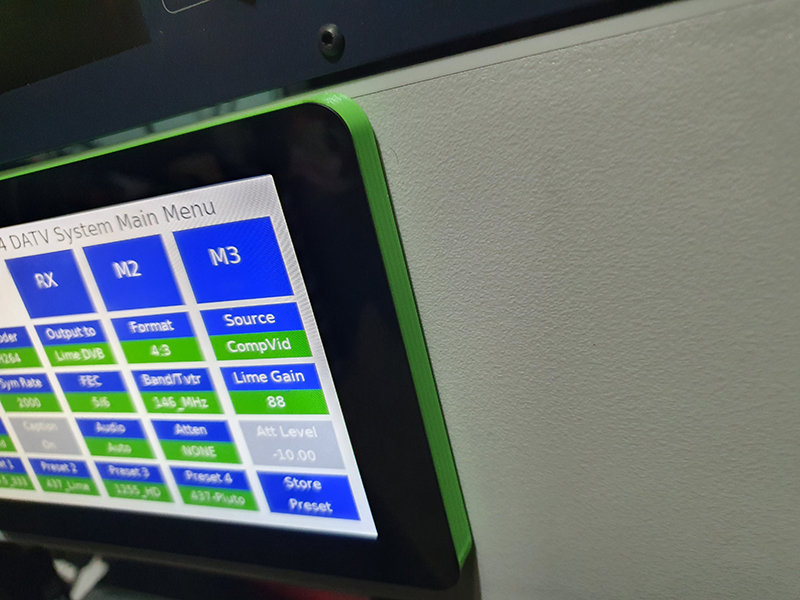

Prompted by Noels request I revisited my own design originally for a sloping desktop case that I used for my Portsdown/Langstone combo. It didn't take much tweaking to make a GP screen surround ideal for any front panel up to 3.2mm thick or indeed as a stand-alone 'screen protector' when you have a unboxed system sitting on your desk.
The bright green feet still fit with 12mm screws in place of the 6 for the feet originally. The touch-screen is recessed about 4mm yet 'fully accessible'.
.STL files available with or without the text labels. Message me if you want them - not for commercial use. Needs 4x2mmx12 screws and nuts, plus some 3mm hardware (4 off) of your choice to fix the bezel to your case.
Print time 4 hours or so at 0.2 layer height, plus an hour for each foot.
Pictures explain better....
