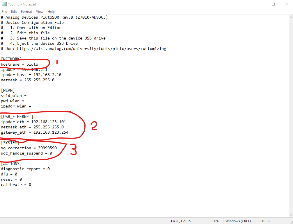

So after Dave's answer I have now got my Plutos sorted.
Here are a few clues:
First thing is to give you Pluto a LAN network address.
Use Advanced IP Scanner to find your LAN network addresses including your Router which is also (usually) the gateway address.
Pick a free address for your Pluto

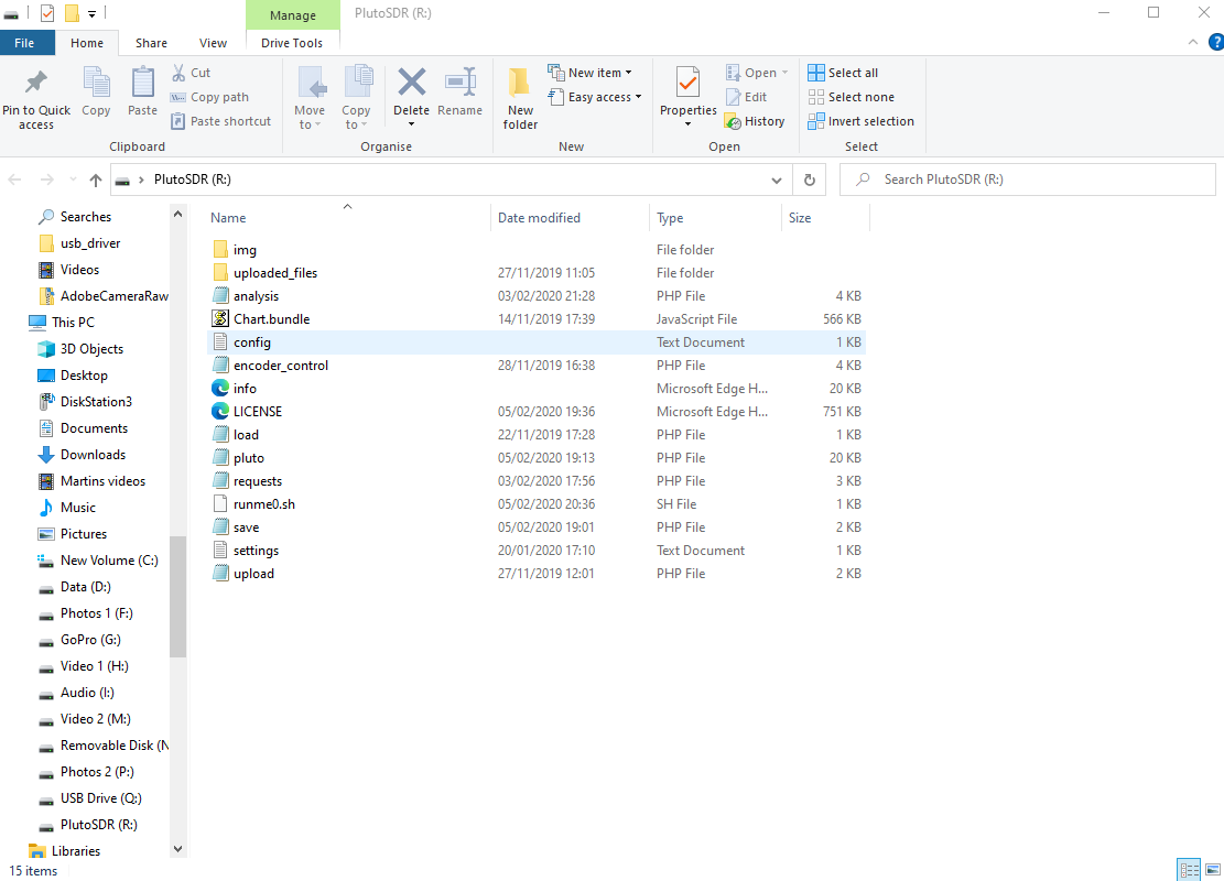

Using the above information plug your Pluto into your computer (mine is a Windows 10 )
The Pluto is seen as a new drive and should be seen in the 'This PC' menu and also open a window showing contents: Now open the file config (probably by double clicking on it) If you need to use a program to open it then choose Notepad.
You can now edit or fill the line shown in 2 below
Enter the address you have chosen for your Pluto, the netmask is probably already correct and the gateway address is probably your router's address.
These must be addresses in the address range of your router and have the first three groups matching your system. In my case 192.168.123.xxx
While editing this you can change the Pluto's name if you need, for example if it is your second Pluto change it to pluto-2 (see 1 )
Note that I have changed the frequency correction in position 3 as my Pluto was slightly off frequency.
Once you have edited these you can save the file back to the Pluto and then 'eject' the Pluto from the computer by right clicking on the Pluto in the file explorer's left hand plane and choose Eject.
Now plug the Pluto into a USB to Network adapter and connect to your network as Described in the WiKi
Put the Pluto address into the Portsdown (menu 3 - Pluto Config)
It should now work if you choose the correct settings ( works best at lower SR)
Martin G8LCE
